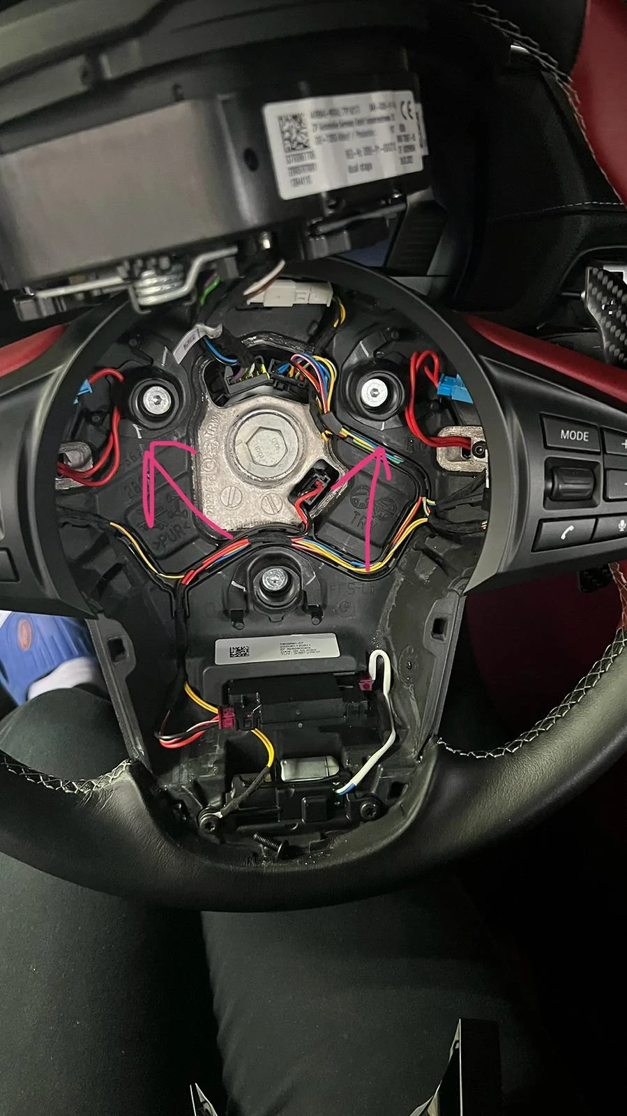

Hi guys,
I just installed some paddle shifters, but I didn't realize the length of my wires would get in the way of my airbag... the airbag is in but it will not depress at the top section and I am assuming it is pinching on the paddle shifter wires.
Would there be any alternative way to get the airbag out? I tried removing it but the clips at the top won't even budge and I can only loosen the bottom clip.

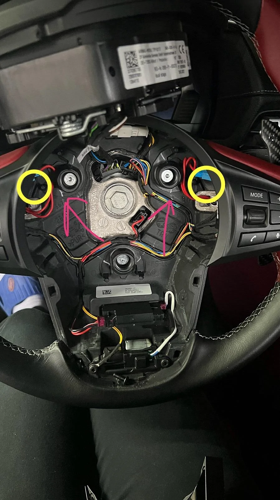

There are channels for those paddle shifter wires to sit (circled in yellow). If you get the wires into those channels you shouldn't have any issues getting the airbag to re-seat.
