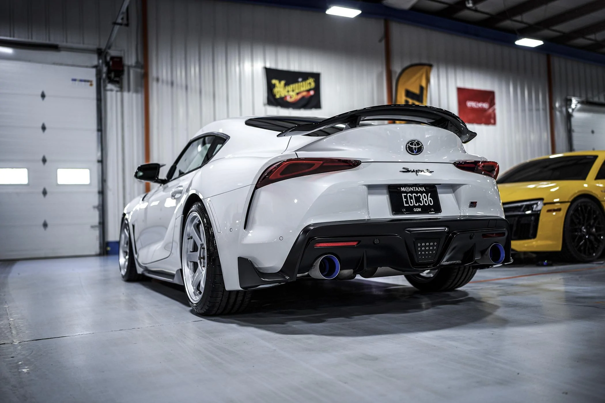

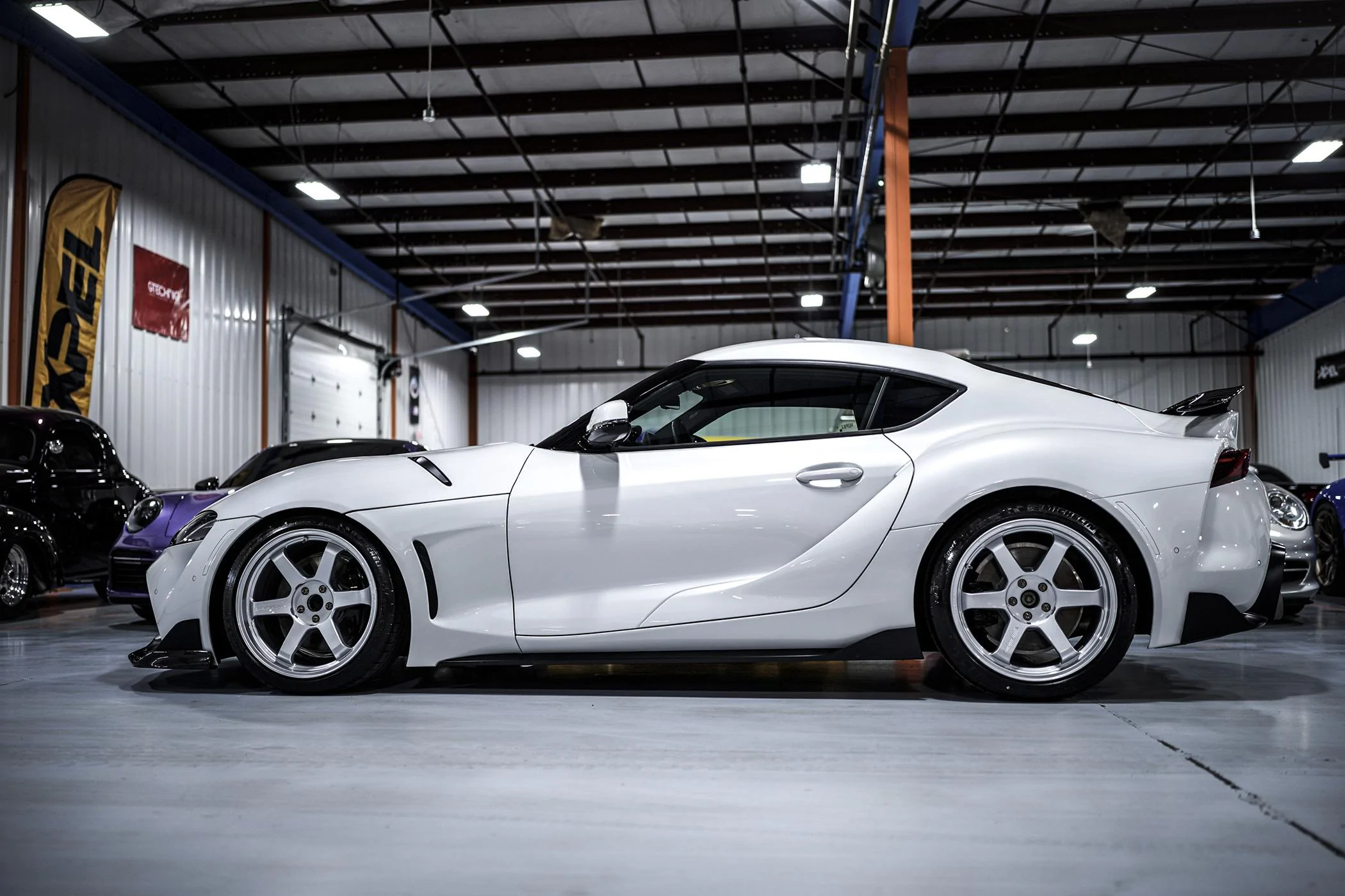

hey Fellas,
Was looking for a little input on the limitations, if any, with factory eccentrics when you lower the car. I installed MSS height adjustable lowering springs with Verus Camber hats. There was negative camber gain to about -2.5' in the rear and I am wondering if I will be able to bring this back down to -1' to -1.5' with factory adjustments or will I need aftermarket arms. Same goes for caster as I feel like I lost some caster at the front axle with the suspension. For FR cars I always prefer around -3' F and -1 to -1.5' R as a balanced setup that rotates easily and predictably if you feel like hooning about but can still be driven neat and tidy as well. Basically you pick your angle. I don't care about setting fastest times as that is not why I bought the Supra. I just don't want to go to my buddy's shop 1 state over and get it on his alignment rack only to find out I won't be able to hit my numbers with the factory adjustments.
Any help in advance is greatly appreciated!

Razorlab is the go to SME for track info. I was able get back to -1.5 with factory rear camber arm and car lowered .8".
