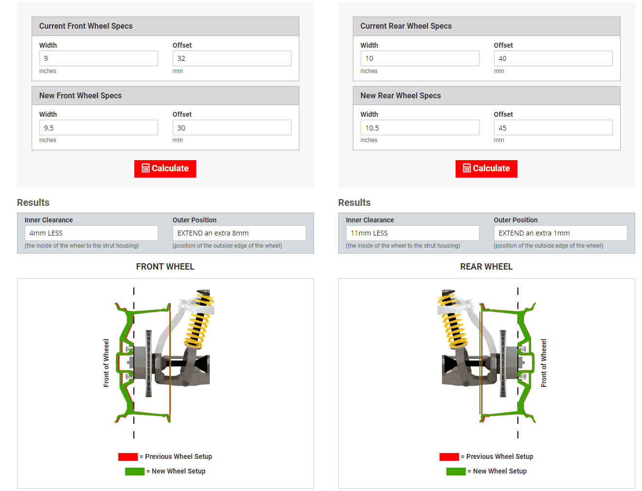

Thanks in advance to any information given!
Looking into a certain wheel and their offsets are out of desired range and will require spacers as they are close to stock offset specs, looking for opinions and validation (lol).
Available Specs:
19x9.5 +30 & +45 (backspacing 6.43 & 7.02)
19x10.5 +25 & +45 (backspacing 6.73 & 7.52)
At first glance it seems like the best option here is to get the +30 fronts and add a 5mm spacer. For the rears I believe my best option would be the +45 and add a 10mm spacer, as the +25s wouldn't allow for play.
looking to run 275/35 and 295/30 to start off.
Thoughts?
