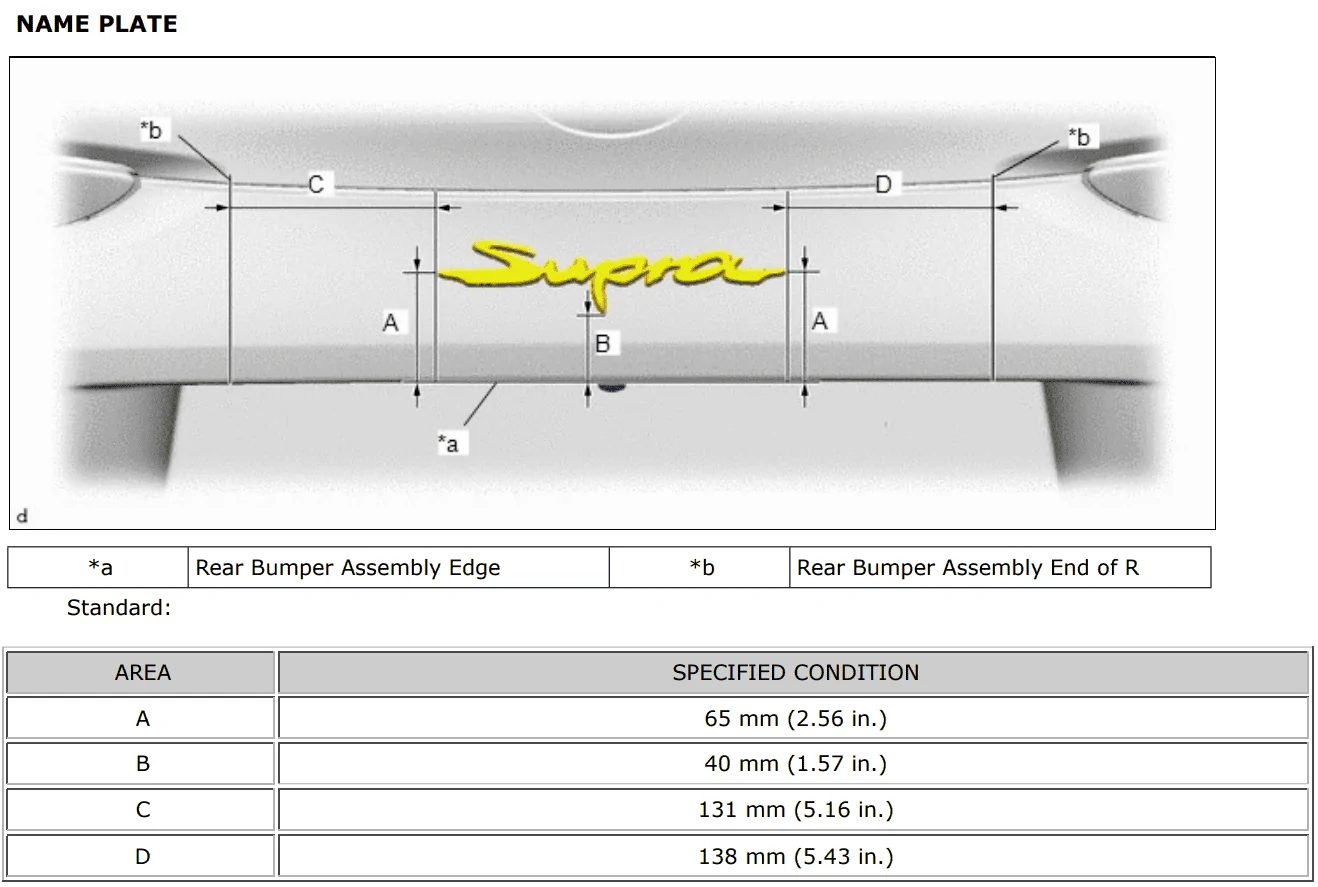

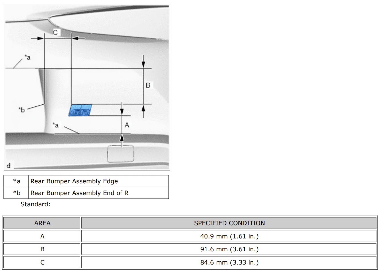

Hi All,
I have a bit of an issue,
After some total tool reversed into my car with a low loader trailer its been in the paintshop (and been given a new wheel).
However its come back debadged!!!
They've agree to sort out the new badges but the problem is. When they send them to me. Where do I place them! Are there some measurements out there?
Or failing that do any london owners (if there are any of you) mind if i make a template based on your car with some masking tape (and a pencil).
I did that back in the day with my old 306 gti6 and it worked well.....

Hey, @eliotrw, here're the specs for the GR badge position:
And, for posterity, here're the specs for the Supra badge that I'd posted earlier in a separate thread:
You are an absolute legend. Thanks so much!!!
