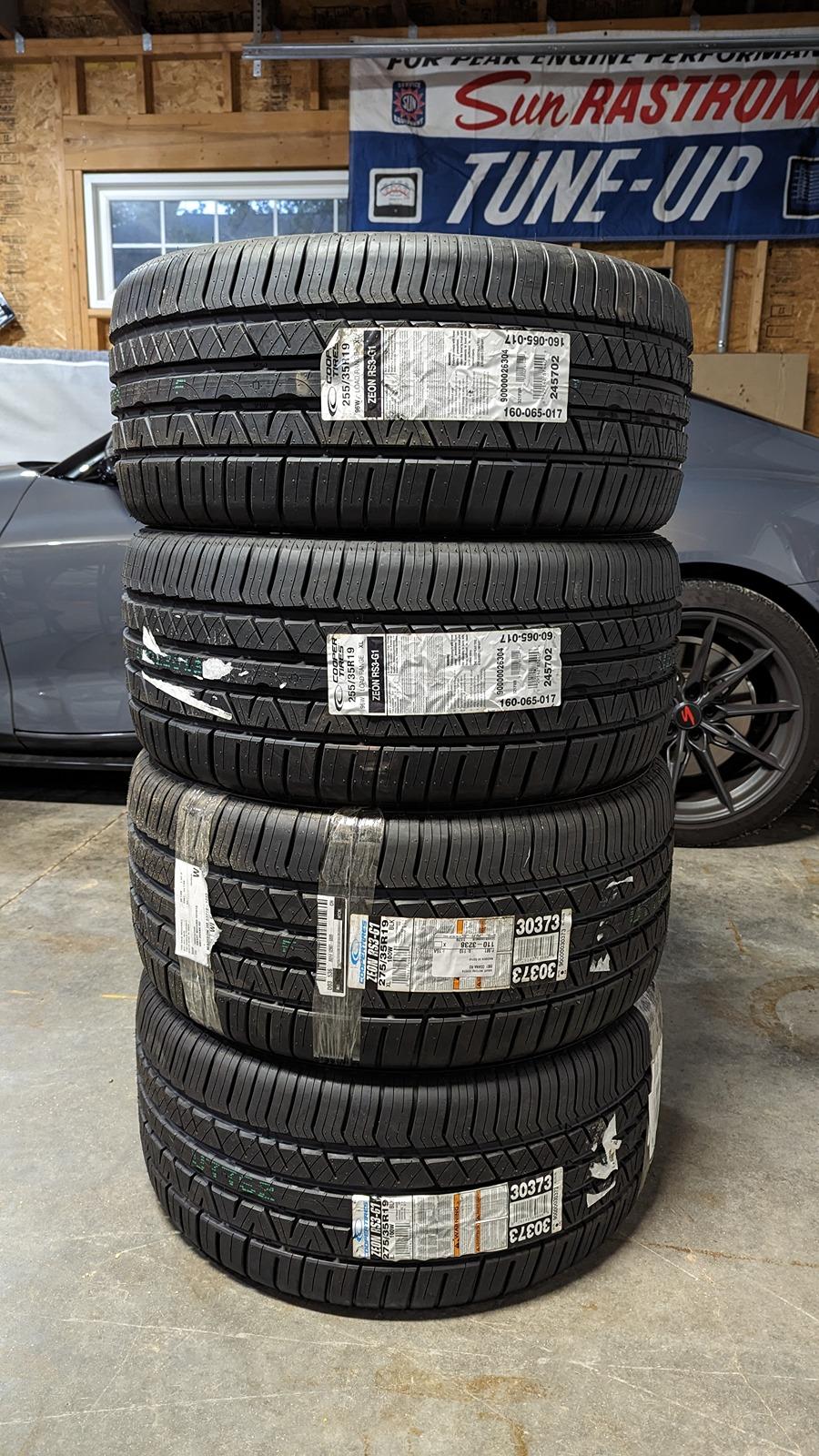

Being a 200TW, and observing the little shape-changing divots on the shoulders of my set, I can't see them lasting more than 10-15k, at the most. They're also not built for comfort at all, being noisy, harsher riding, and tramlining a bit on grooved pavement. I still love them, but would never take a long road trip with them mounted up.
This may not be a practical option for many of you, but that's where having two sets of wheels & tires becomes really handy. Slap the stock wheels back on with OE Pilots, UHPAS, or something similar and don't be so paranoid about encountering surprise inclement weather or needing an emergency replacement far from home, and the OE sizes are much more plentiful at stores throughout the country. I scored a set of Cooper RS3-G1 on closeout ($600 total!!) last fall, and will the slapping these on the OE wheels of my 2024 as soon as I take delivery.

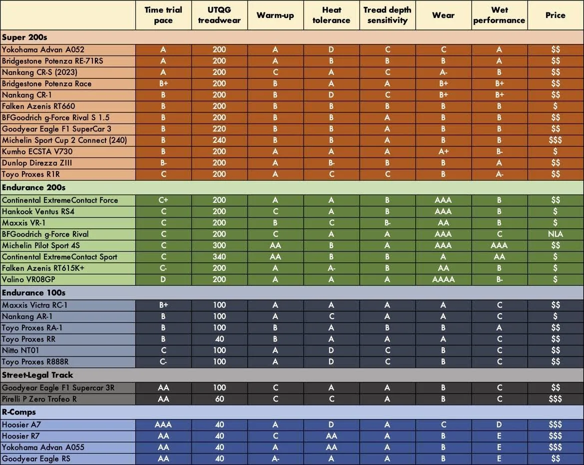

Will said! You find your highest wear points quickly when on the softies. For me itā€™s on track. Not being a daily driver, I donā€™t notice any effects from the few miles I put on during the week. Like you, when it comes to tires, I look for a good buy on our daily cars. But yeah, I wouldnā€™t want a track tire on all the time. Some friends run Kumho V730s or Bridgestone RE71s on their cars year round. Probably a few pages back, but Iā€™ll throw the chart up anyway.

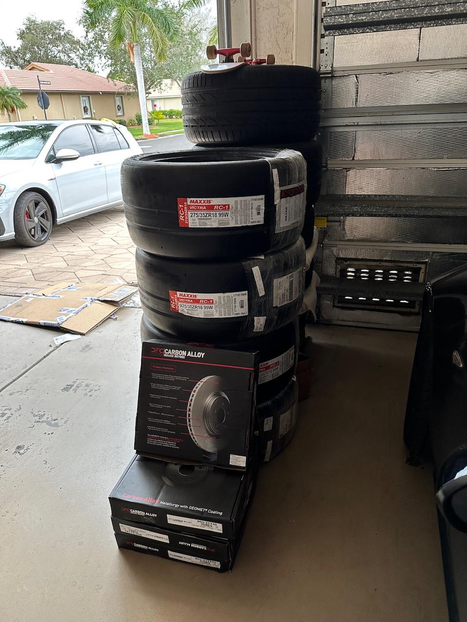

Iā€˜m on Endurance 100s - Maxxis Victras RC-1
Stock wheels and tires are going back on soon šŸ˜”

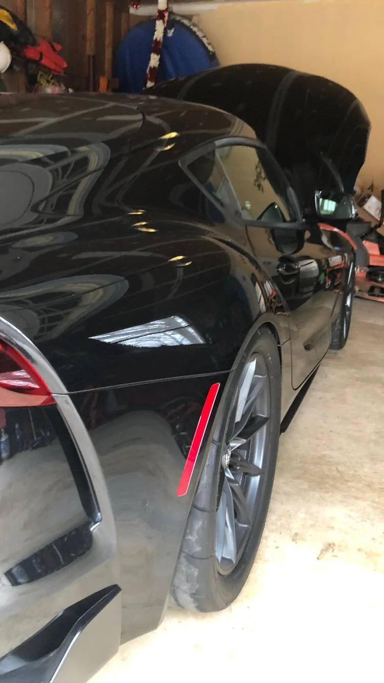

UPDATE: just wanted to comment on this thread after my trip to tail of the dragon and the smoky mountain roads. I previously mentioned that i have the same setup as the OP and do not rub with normal driving around town, even spirited driving on most roads are fine. Out in the mountains where we were driving the piss out of the roads, I did rub a bit on the setup but only very little and also only on high compression bumps, turns, and potholes/etc. Probably 4-5x on my 5 days out there. Just FYI for others considering this setup. I could remove the spacers but i haven't decided yet if i'm going to try that yet.
were you rubbing on rear, front or both?
Rear passenger side tire by the looks of things (via flashlight inspection). Took some rubber off of the fender lip with my fingernail. Didn't see or feel anything on the fronts or driver side rear.
