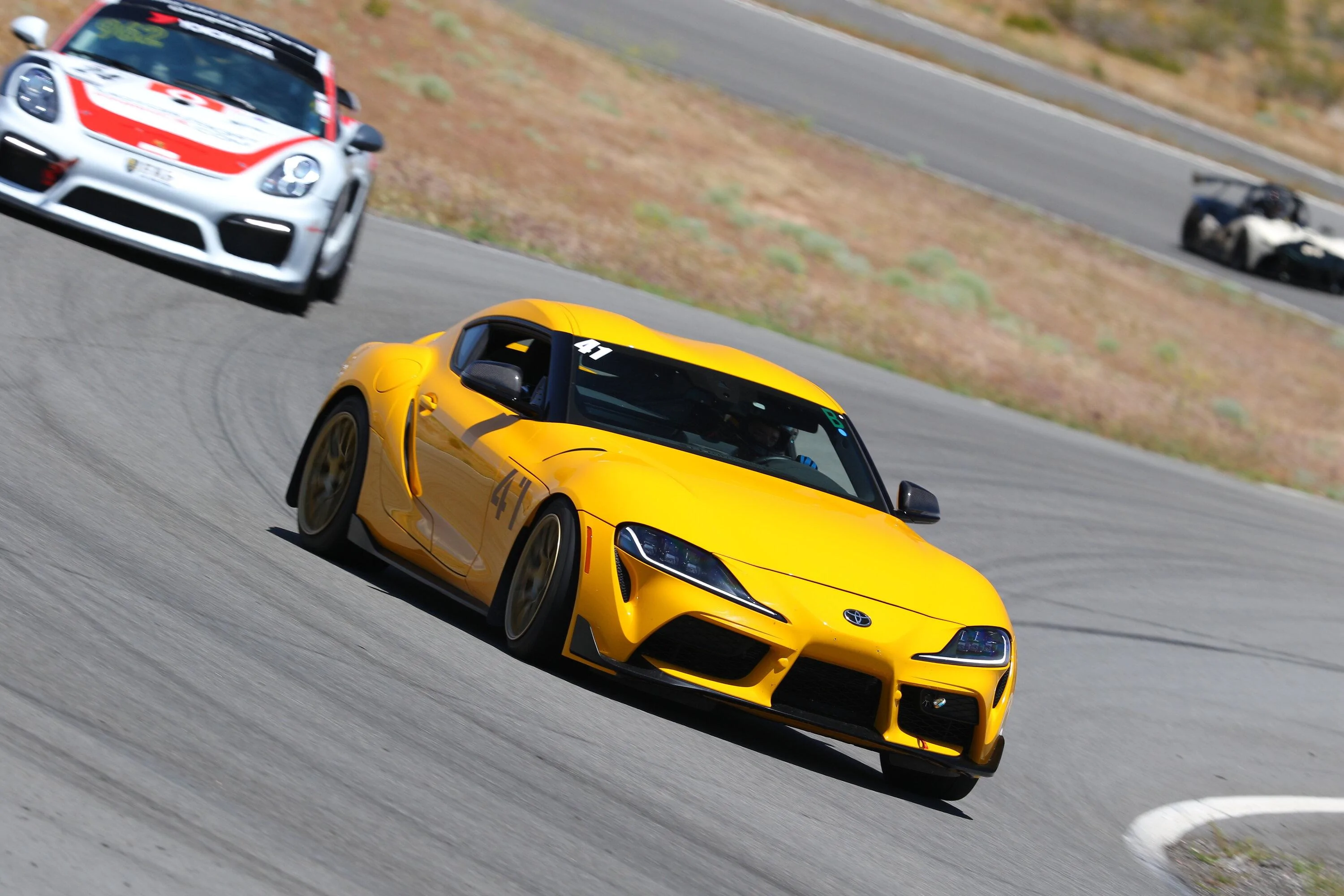

Does this count? My tires had heat cycled out.. it was 90*+ out, so track temp was crazy hot. Every corner was just like this. Most fun I've had at a track day šŸ˜‚

A wee bit more angle and vaporized tires and you are ready for FD ;).
Love the look of these cars in Yellow.
