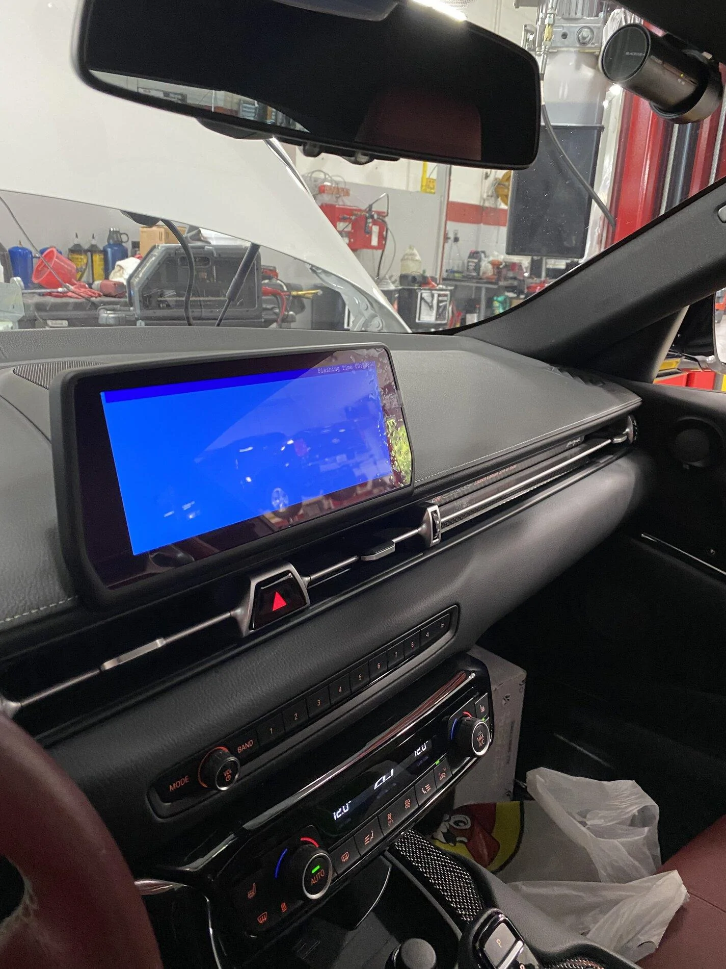

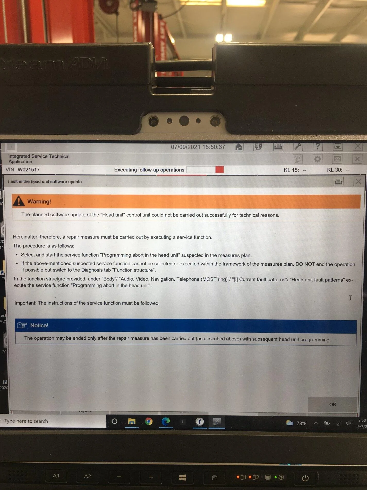

Was explained they needed permission from Toyota HQ to attempt reboot.
They entered a command while they were plugged in and it restarted the headunit.
Maybe needed permission cause if it failed they'd have to order a new one? But that that's it.
Nav is back up with all my old Car settings in tact.
For sure, I appreciate the reply. I do remember that when the first dealer made the update I got in my car and it smelled like something was burnt so pretty postive the deaer fried it. Thank you for the clarification!
