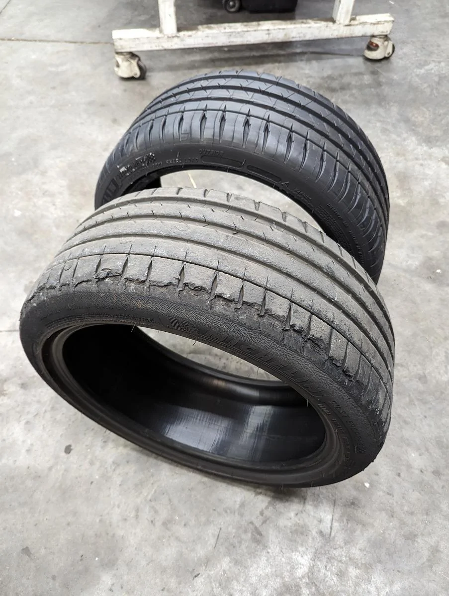

I've run PS4S on a few different cars and generally liked them as an all purpose tire with occasional light track use. The main issue I've experienced is they don't hold up well on track if you're going hard and have insufficient (like less than -2°) camber; especially on front tires. They have a bad tendency to roll over and peel the shoulders off. My wife's 135is did this to 3 sets of fronts until we did control arms and tension rods. I've also seen it with the C8 when guys track them without the proper track alignment.

For novice driving, the ECS, PS4 and DWS (less so) will do "okay", but anything other than novice pace and you will absolutely destroy the tire like @AHP showed.
