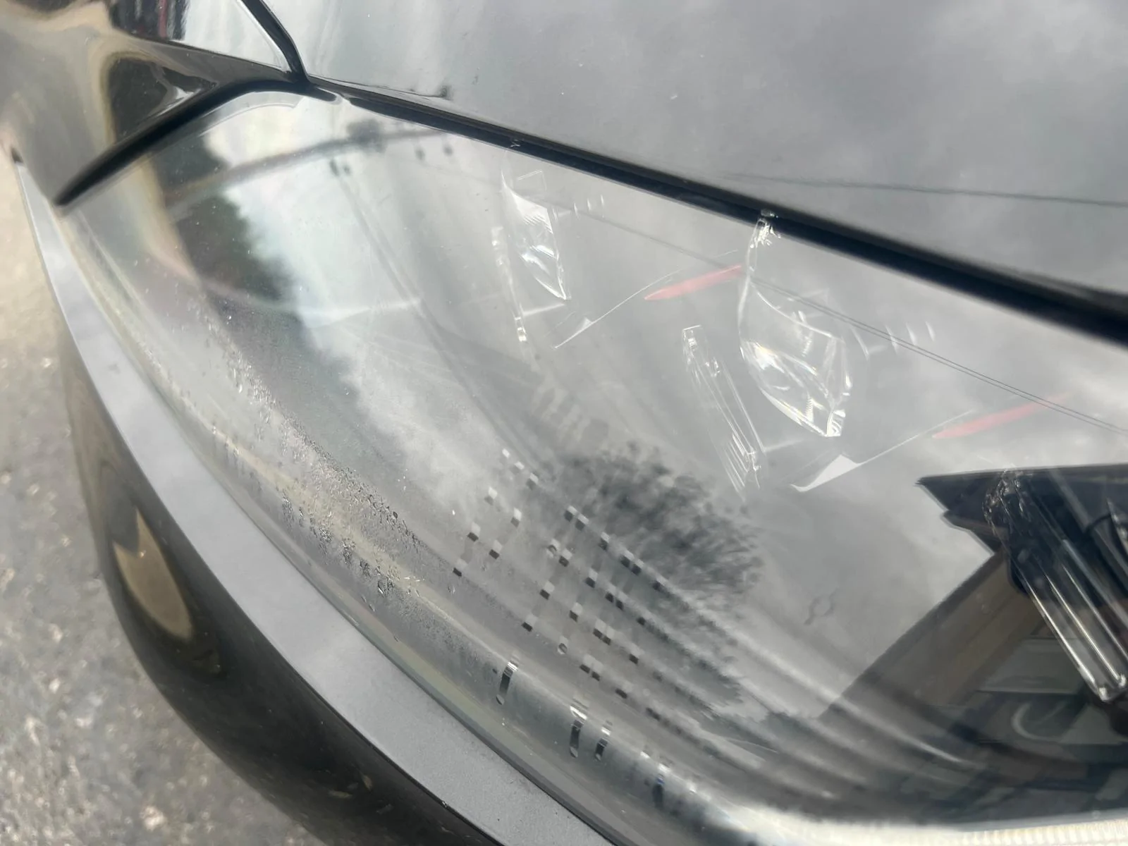

Today I noticed a large amount of condensation in my drivers side headlight. I know people have had similar issues with their taillights. any suggestions? Car is very much out of warranty.

Just started noticing the same issue on my drive side Launch Edition..

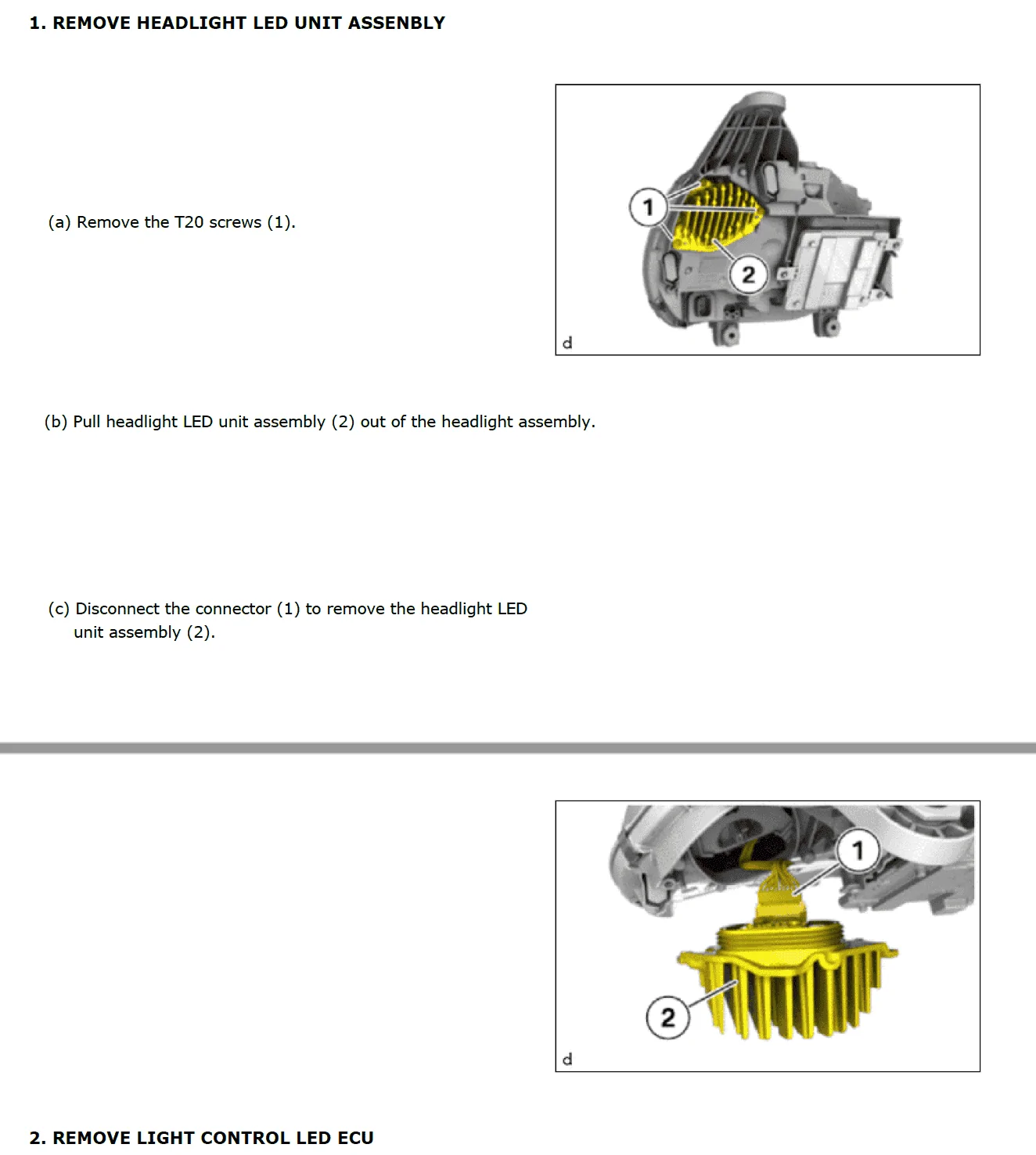

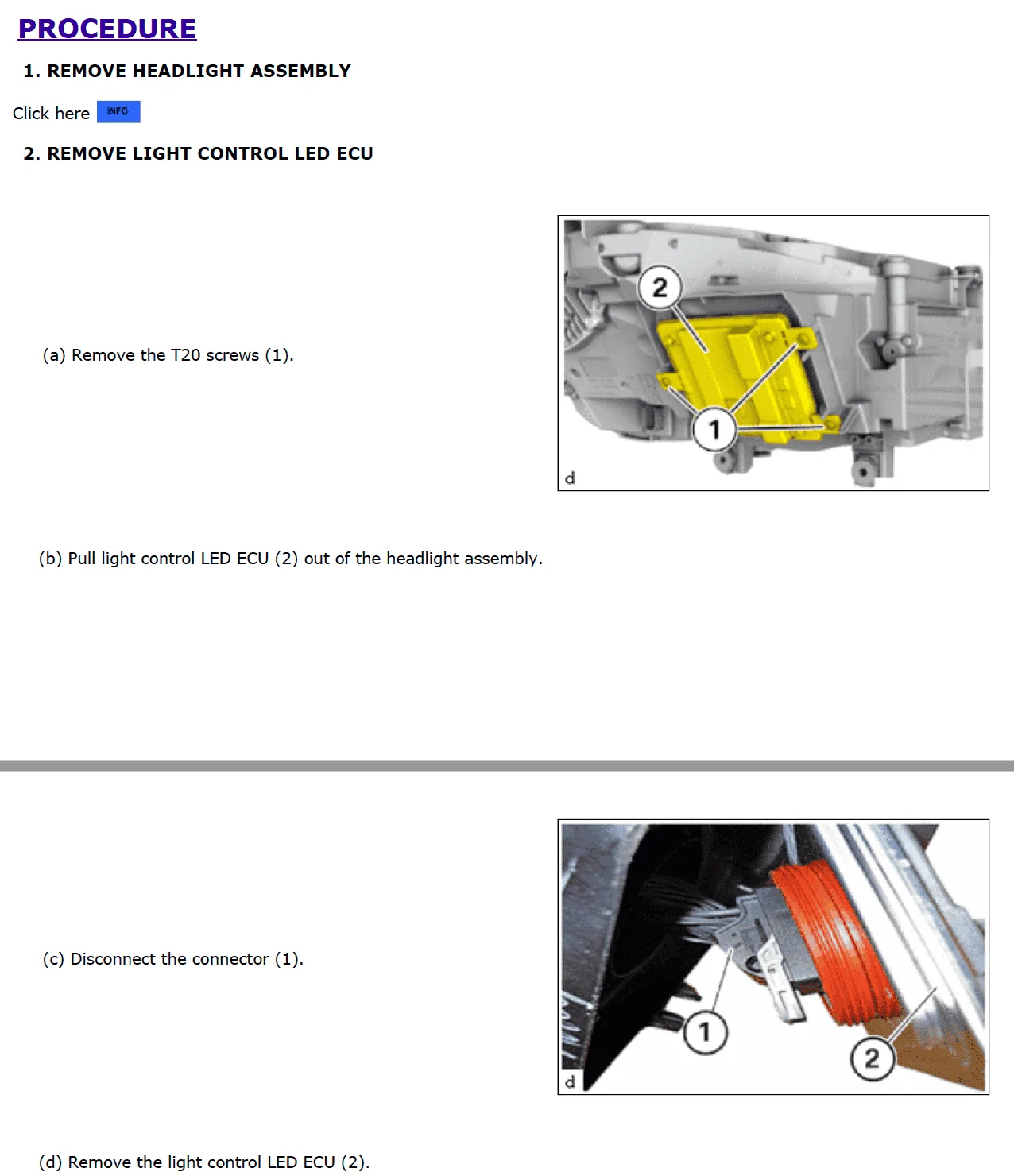

Jesus. No need to drill anything. Take the led ecu out and it opens up to the inside.
Facepalm. Some of you guys could use a glance at the workshop manual.
Well thats perfect then. Access the interior of the headlight assy via the LED ECU, dry it out with a heat source and re assemble. Fixed.
