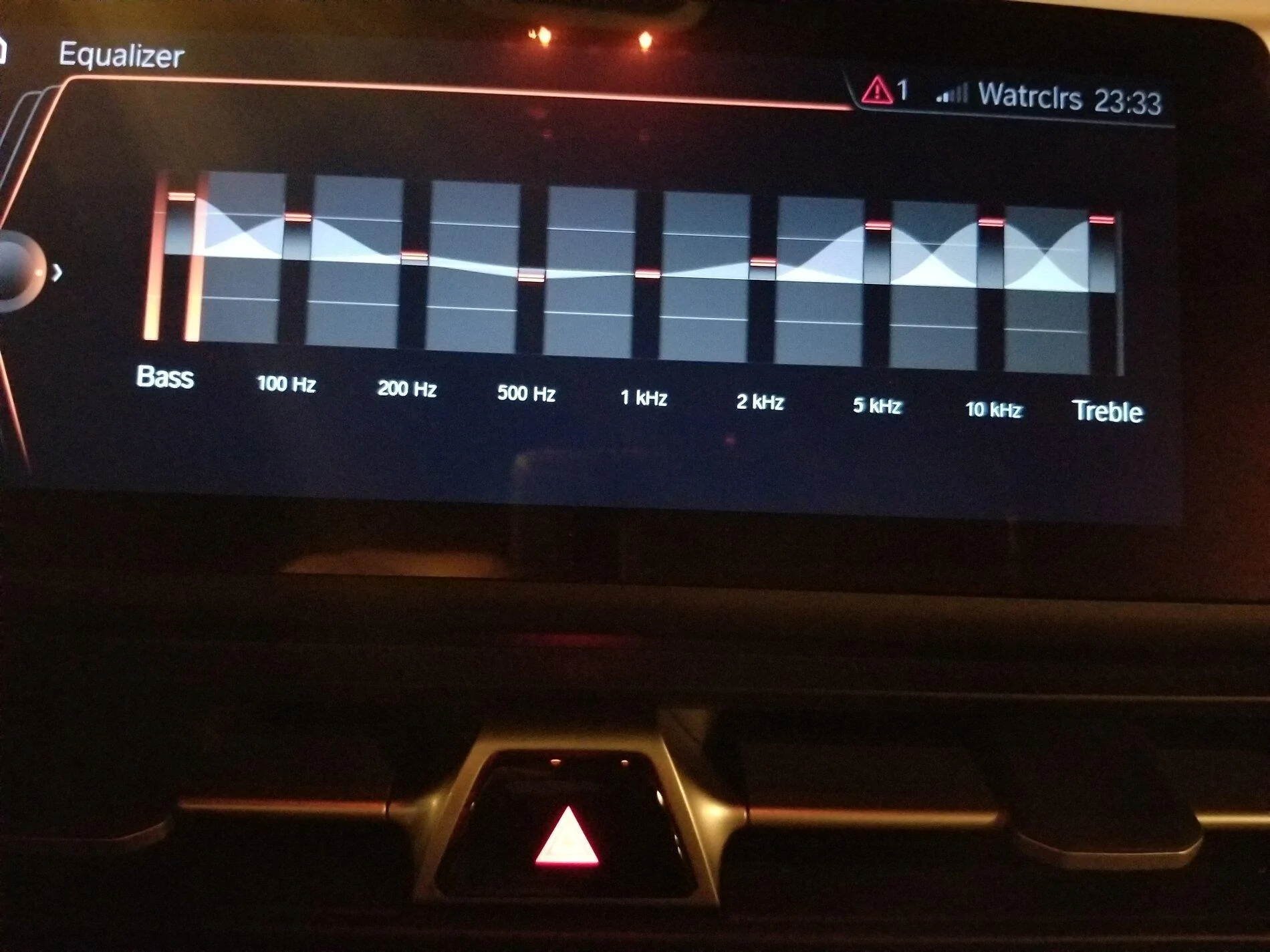

honestly after using Tadda's EQ settings alone its sounds really decent, I know it's not the greatest but it ain't bad either

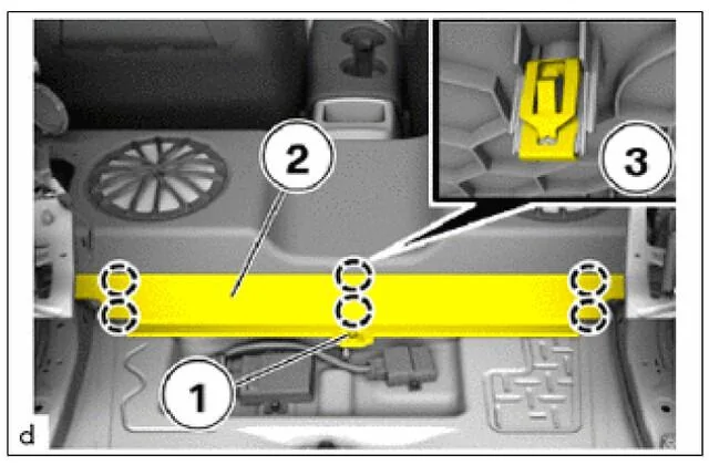

@pav911
Just simply remove the rear panel and re-evaluate the sound quality...Now this won't completely eliminate all the vibrations but you should hear a noticeable improvement in reducing bass vibrations and improving sound quality which should give you some confidence that the sound quality can be greatly improved upon and is easily fixed...

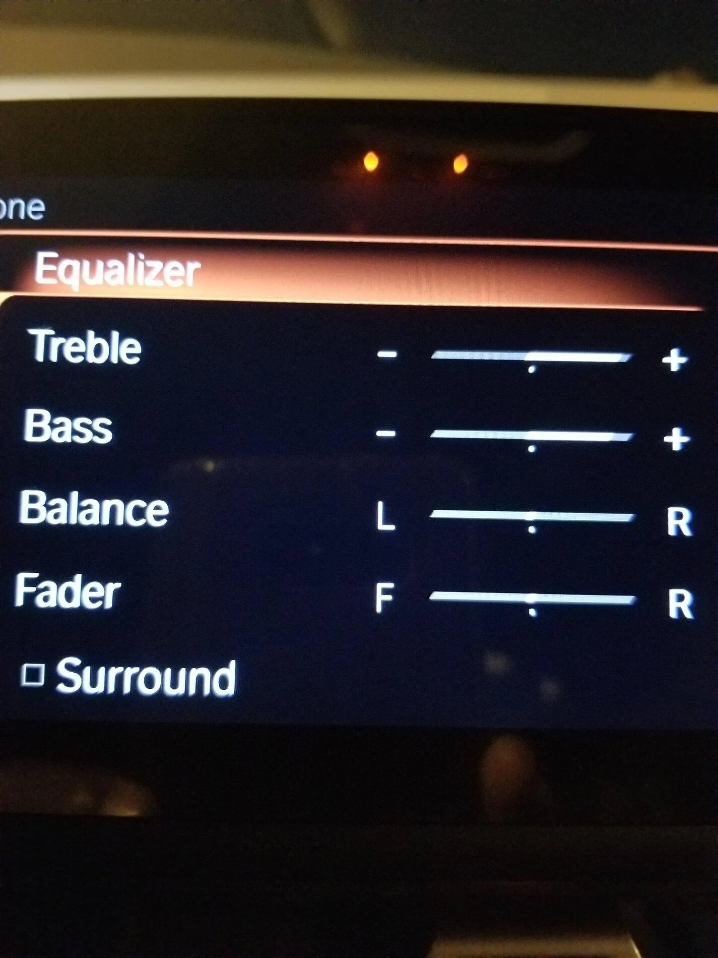

Also make sure your audio settings are set up properly...
I've found that selecting the "Surround" enhancement feature added to the phase distortion which resulted in reduced sound clarity...This is one of the first things I turned off and the system clarity was noticeably improved...Also note that "Speed Volume" is turned all the way down as this will change the EQ curve as speed increases resulting in an undesirable response at hwy speeds...
Here are my current audio settings as an example:
  • ASD / Active Sound Design (off - using Bimmercode)
  • Surround (off)
  • Speed Volume (0)
  • Balance: (0)
  • Fade: (front +2)
  • Broad Bass (+2)
  • Broad Treble (-2)
  • Equalizer (shown below)
