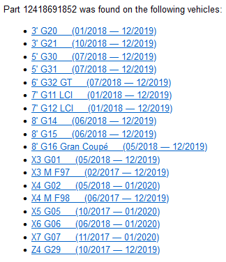

There's starter motors on eBay. It's BMW/Japanese Denso part. Labor..is labor. $900 is steep but I don't know what components they have to disassemble. Check TIS or service manual in one of the threads...
