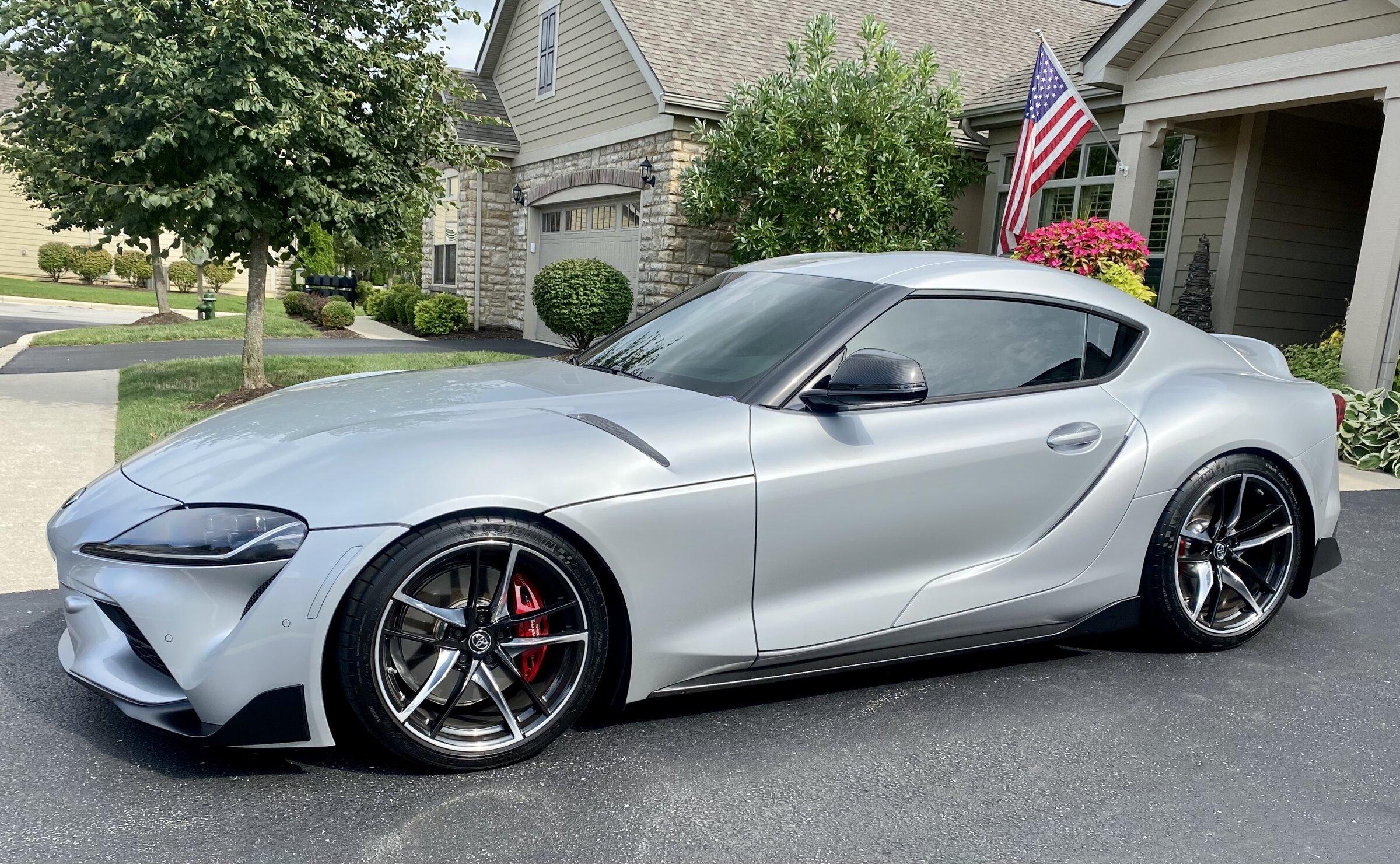

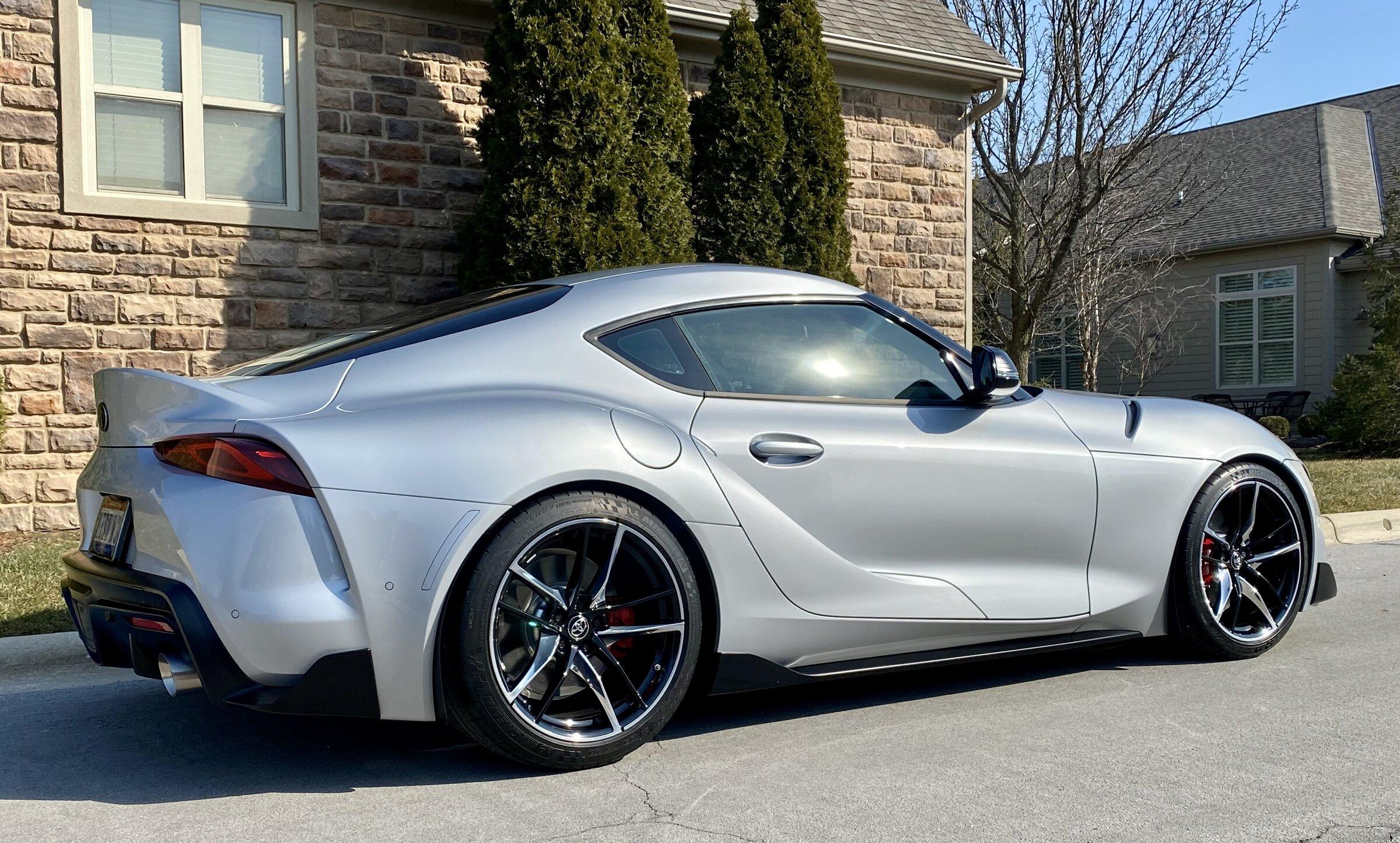

Hopefully I can assistā€¦
I personally wanted a slightly more aggressive stance than stock but without a pitch (lower front & slightly higher rear). Hence the reason I went with the Euro Eibach Z4 Pro-Kit Springs with an even lowering of .8ā€ front and rear.
The look is oem plus and the ride very near stock but with less body roll and less wheel well gap.
I also added Burger Tuning wheel spacers 10mm front and 13mm rear to complete the look.
Also be certain to trim the rubber bump stops front and rear when installing lowering springs on the Supra.
Zero regretsā€¦ the perfect stance imo.

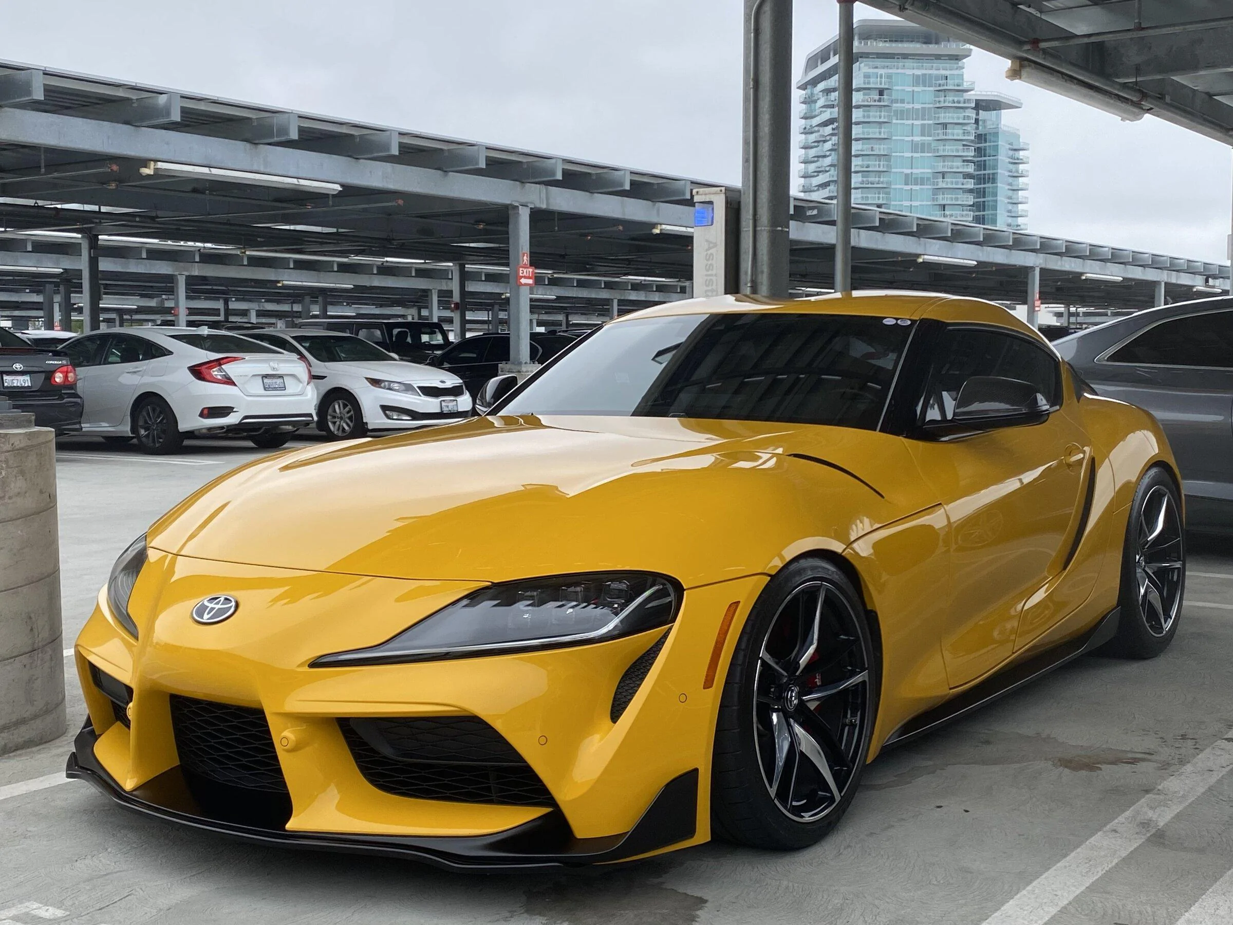

PearlSup
Dec 17, 2021
210
230
SoCal
21' Premium Phantom
Hello all, I am am asking for the folks that are on springs how their ride is. Granted I am looking for 1" in the front and 0.75" in the rear. For folks with similar setups, what springs have you found the be the closest to OEM ride stiffness. I understand the lower you go, the more stiff the ride will be because of physics but are there any brands yall have found to have better ride quality. I do not want to do coils as I want to keep the dampers. Thanks in advance.
The exact specs you are looking for, 1ā€ Front & .75ā€ Rear, can be achieved using H&R lowering springs.
I have them on my Supra 2.0 (lowers the car an additional .2ā€ because OEM springs are taller), and I am very happy!

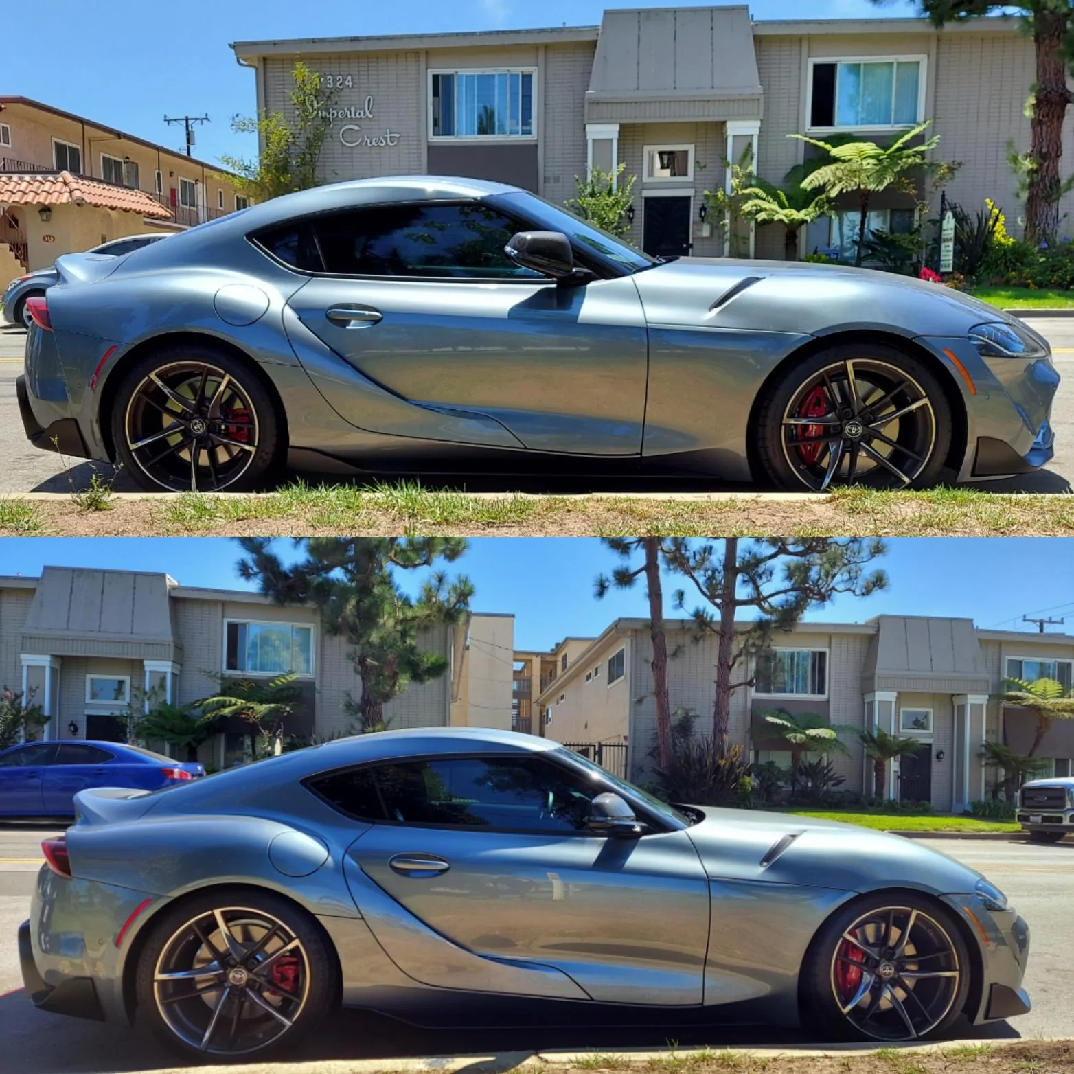

Zenon
Nov 5, 2020
San Diego
GR Supra 3.0
I went Eibachs, supra fitment, not euro, which came with replacement bumpstops and everything needed.
Love the ride and love the drop. No complaints here
Before and after
does it really ride like OEM? I had the adjustable HKS setup to around this drop (a bit less) and they do feel kinda stiff; I can feel the land markers ā€œcrashinessā€ in the cabin - stock felt sublime, even in sport mode
