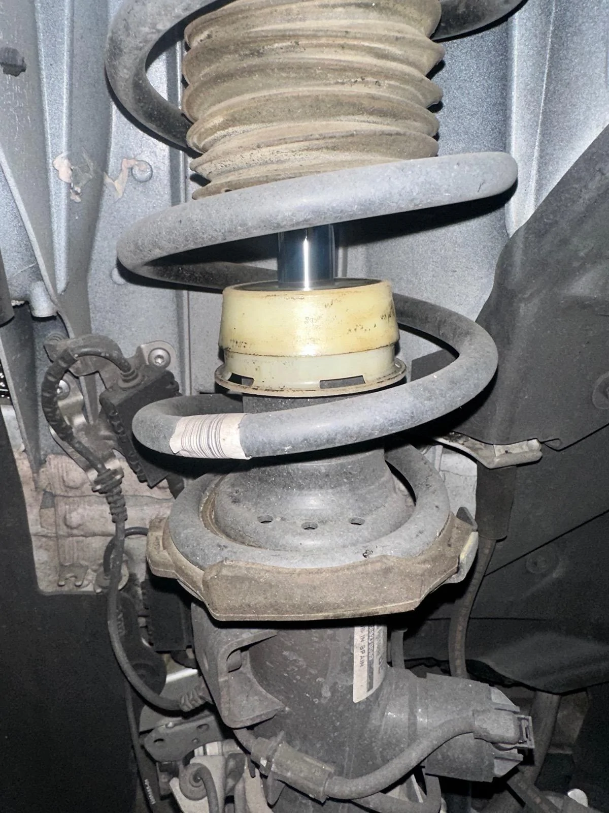

Is this plastic piece supposed to be on there saw that some dealerships forget to take em off was wondering if this is it? Thank you

That's not the shipping spacer. That stays.

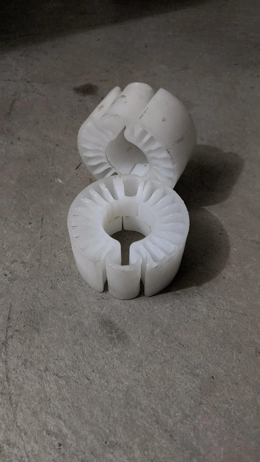

THIS is the shipping spacer... :)
My man! Good call. That’d be me ripping shit out because I read it or saw it somewhere 😂
Might be a dumb question, but shouldn't the rubber strut dust boot attach to the bottom plastic piece? Fully protecting the strut?

Sometimes, but on most BMW suspensions the dust boot is a little shorter. So when the car is lifted up, the boot is pulled upward, as it is semi connected to the top spring and bearing. It's not connected at bottom.
