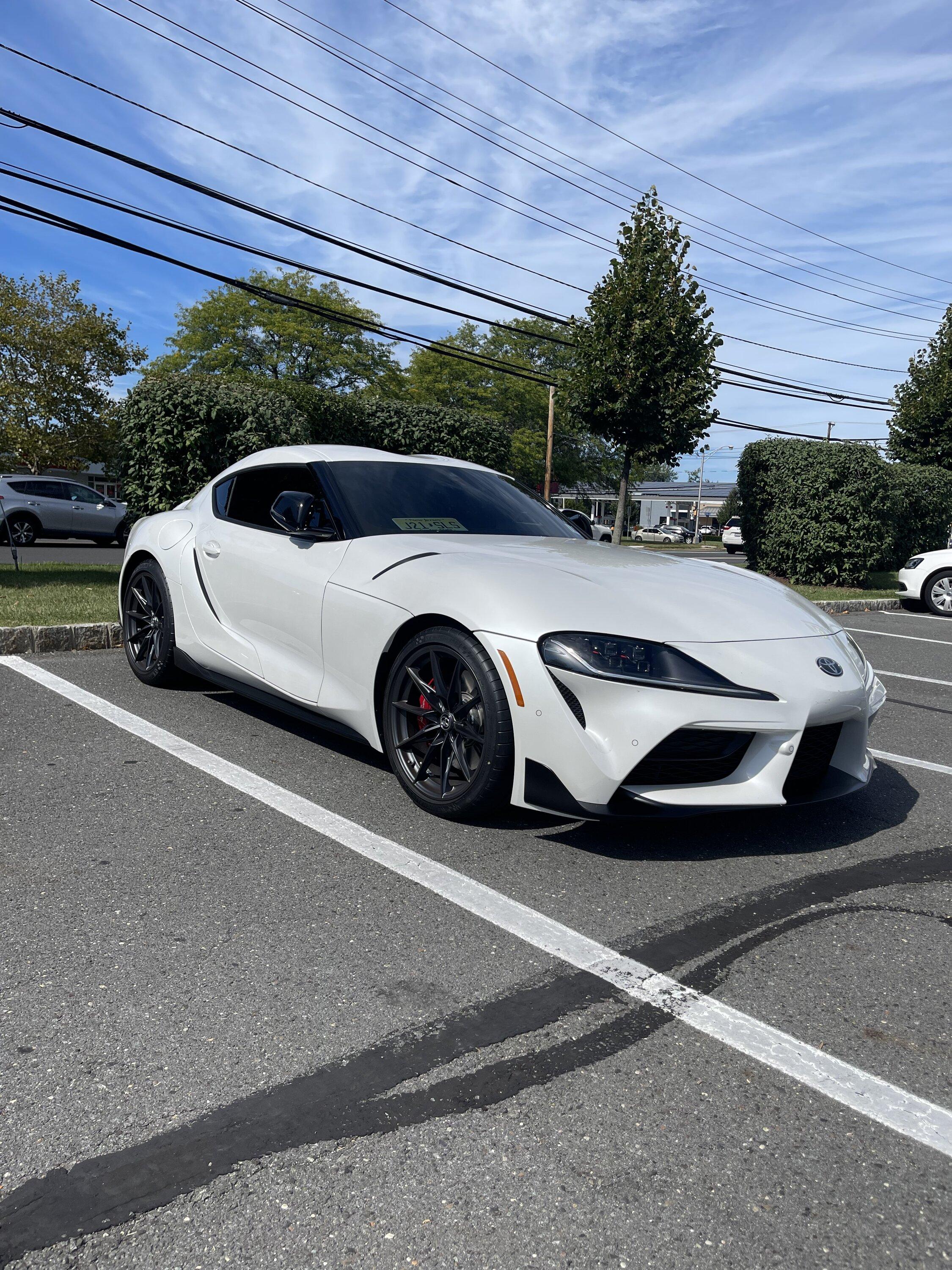

Everyone keeps asking me what I’m going to do with the monster truck wheel gap at the moment and I’ve been looking into options. Every time ppl talk about it, every single person has such a strong opinion about one over the other.
sooo my question for you guys is what did you end up going with for your supra and what made you pick that 👀 pros/cons idk I’m just trying to get a better feel for it all

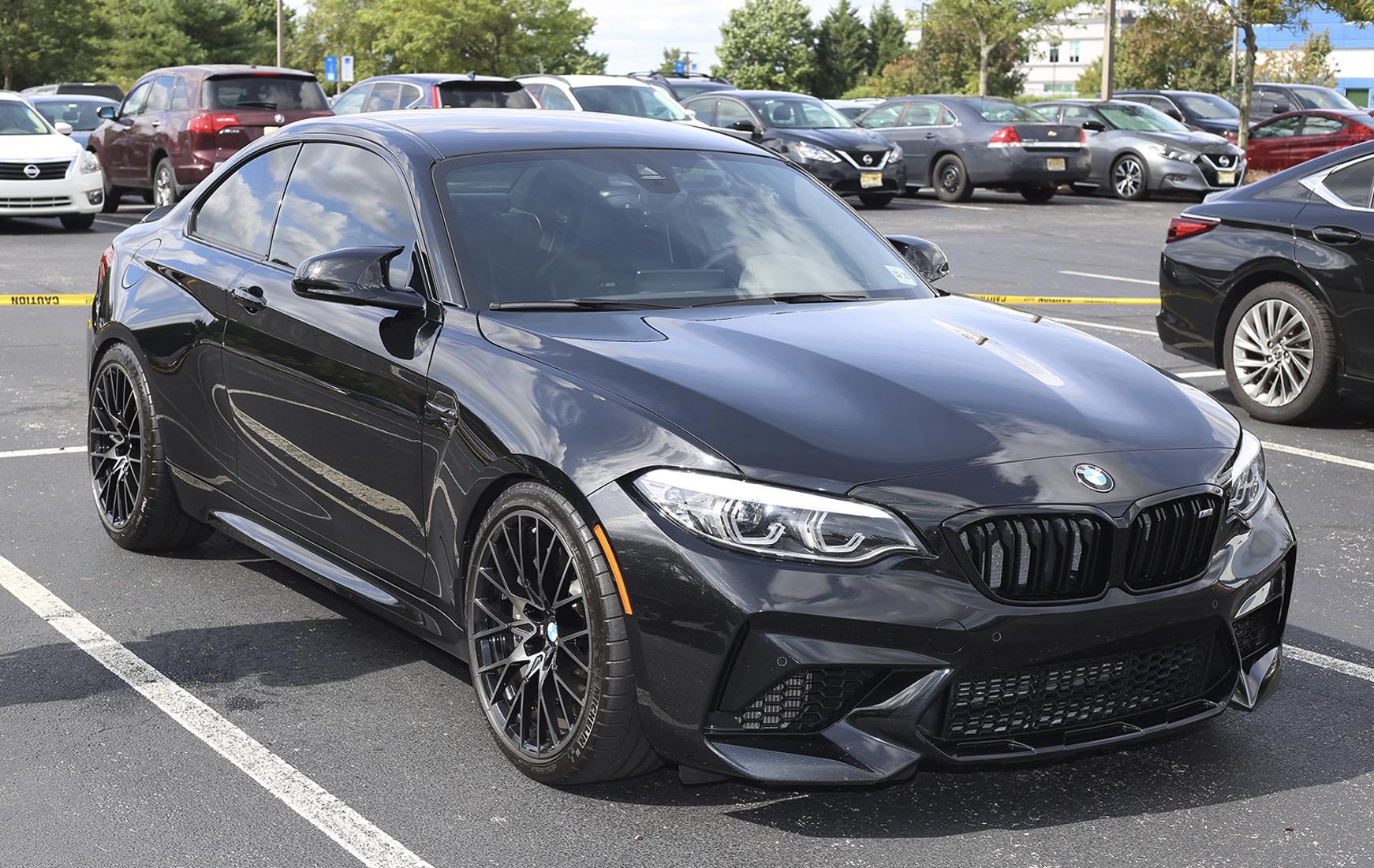

i haven’t decided what exactly my end goal is yet. My first car and first ever build tbh. I’ve never been on a track so I’m using the free day you get with the car to judge if I’m built for that life lol
my workplace had a little car show and this M2 won. When I was looking at pictures of that car vs mine. The wheel gap just sticks out like a sore thumb to me now 😂
This was helpful tho. Thank you!!
