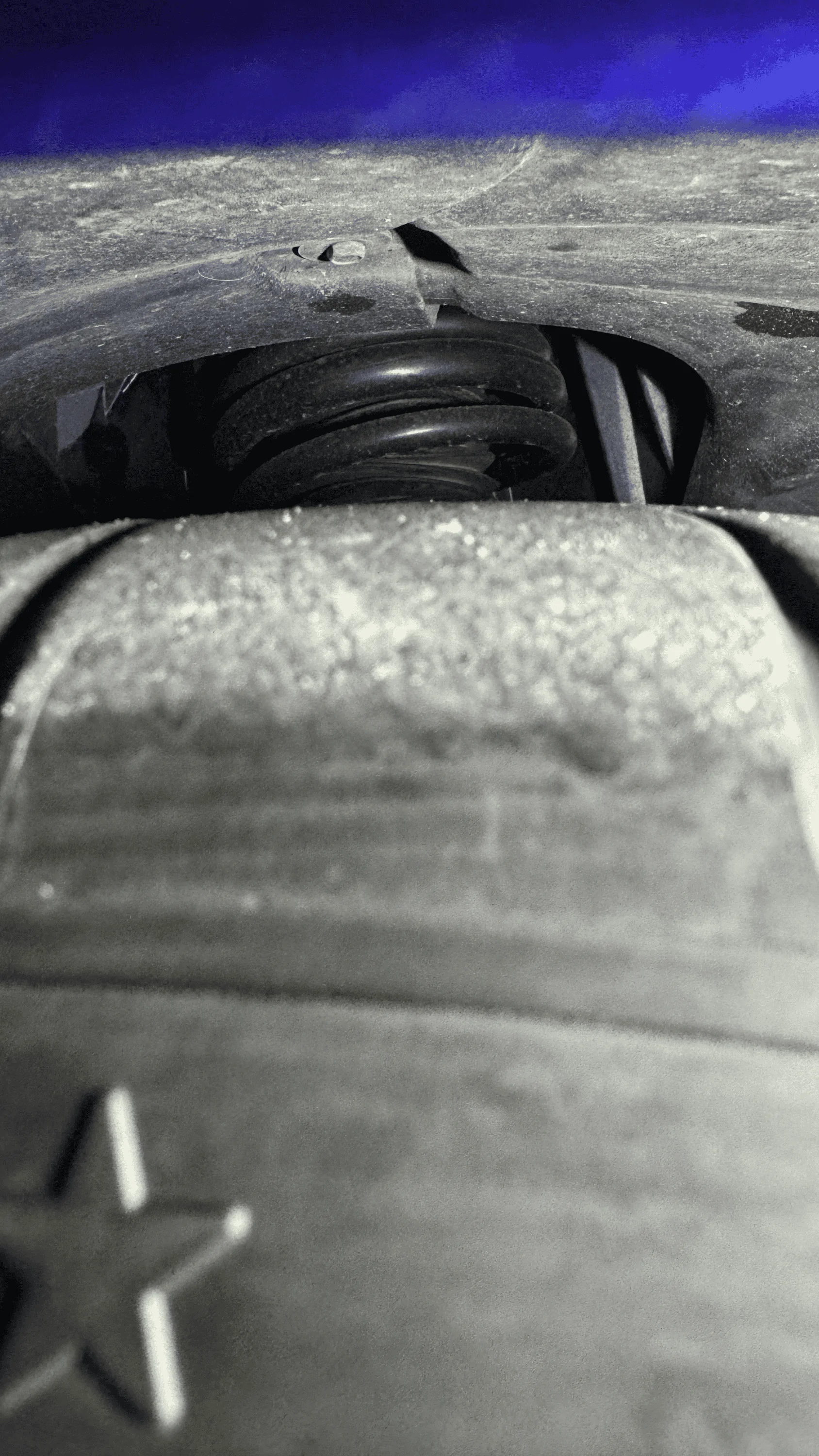

I'm starting to wonder if the noise is coming from the coils making contact with themselves in the front and need wraps. Most people with this issue seem to see it in the rear though.
Any suggestions? These are Swift springs.
Picture 1: Coil under load

Slight update, I installed Tein coil silencers on the fronts where I noticed some places where the coil was making contact with itself.
I'm still getting the same noise, but it seems to be far less frequent than before.

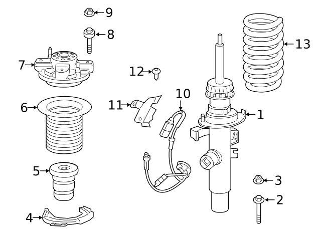

The nut was hand tightened, then lowered and torqued to 56nm. For reference, I'm referring to part #9 in this diagram

I understand you need some pressure on the strut so it doesn’t just spin. Seems like you did that part correctly? Those coils seem damn close under load. Were they installed in the same / similar orientation to the stock springs? Away bar end link tight?

As far as I'm aware, they're installed properly. They're certainly sitting in the upper and lower boots properly.

Must be that the coils are touching or rubbing somehow? Especially if the noise decreased with the silencers.

Yeah I'm starting to wonder if something is still making contact. I did not disassemble the fronts when I installed the new spring silencers so I couldn't see everything.
I've ordered some replacement nuts from Toyota and will likely disassemble the entire front again and see what I can find.
