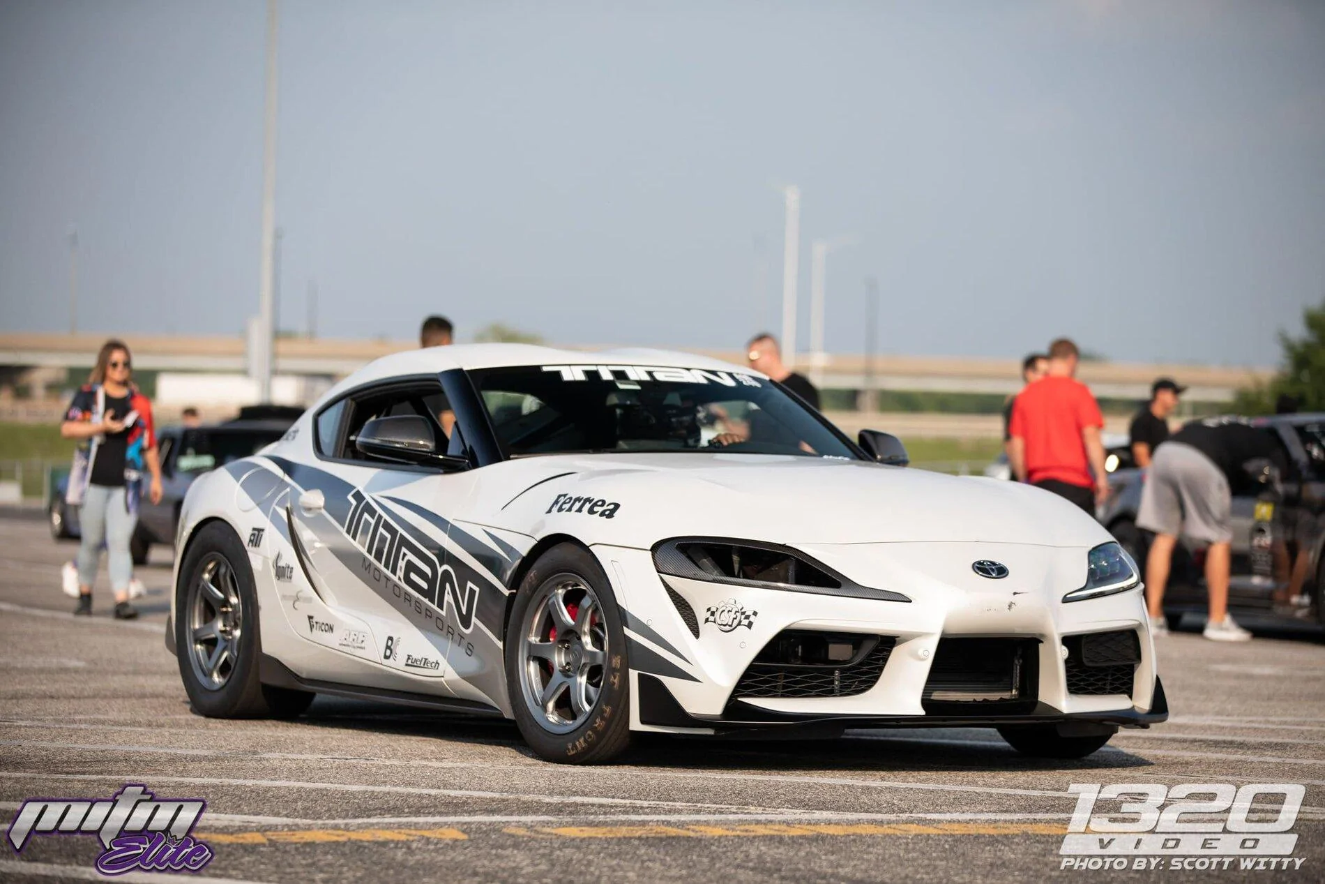

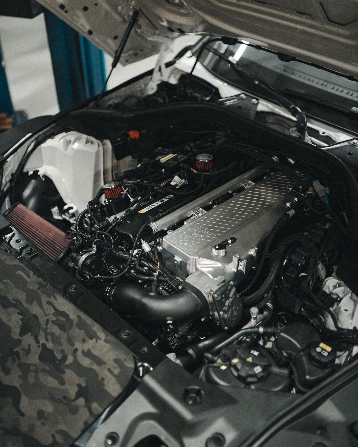

Our shop car started off in July of 2019. We purchased one of the first supras in florida. From then on we have used this car as our in house R&D Car and currently is one of the fastest A90s on the streets.
This car has been 8.93 @ 152.55MPH in the 1/4mile and makes a little over 1000hp to wheels.
Current Accolades:
  1. First A90/B58 Supra in the 8s
  2. Fastest Stock Location turbo Supra
  3. 2020 FL2K A90 Class Winner
  4. 2021 MITM A90 Class Winner
  5. Current #4 Fastest supra worldwide ( Our sister car is #5 )
Drivetrain/Performance:

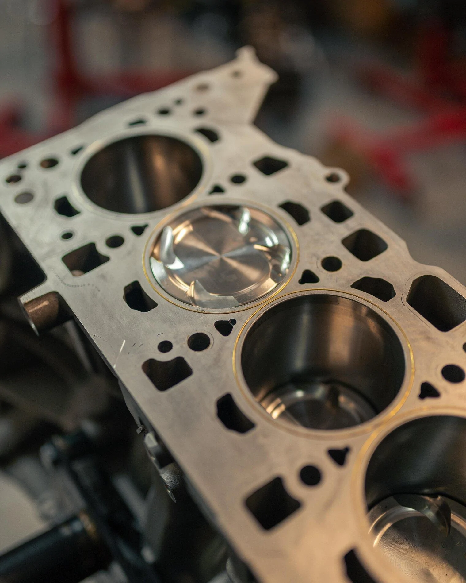

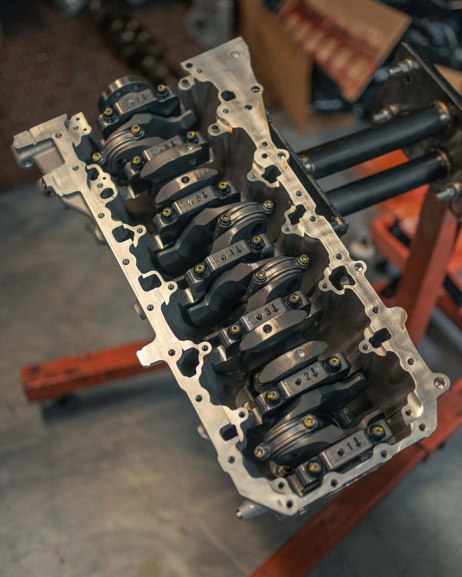

  • Titan Motorsports 3.2L Stroker B58 Package
    • Brian Crower 100mm billet Crankshaft
    • Carillo Connecting rods with 3/8 Carr bolts
    • Custom CP Stroker Pistons with Upgraded Wrist pins
    • ACL Rod bearings
    • ARP CA625+ Head Studs
    • ARP2000 Main Bearings
    • Titan Motorsports Billet Main caps
  • Titan Motorsports 6-Port Cylinder head package
    • CNC Port and polish
    • Ferrea +1mm Exhaust Valves
    • Ferrea +.5mm Intake Valves
    • Ferrea Springs and retainers kit
  • Titan Motorsports Fuel System
  • Titan Motorsports Stage 1 Transmission
  • Titan Motorsports Upgraded Convertor
  • Titan Motorsports Breather kit
  • Titan Motorsports Intake
  • Titan Motorsports stock location turbo upgrade
  • Titan Motorsports upgraded axles
  • Titan Motorsports DriveShaft
  • Titan Motorsports engine damper
  • Titan Motorsports Nitrous kit
  • ATI Flexplate
  • CSF 5-Piece Ultimate-spec Cooling Package
    • CSF CSF x VF Engineering billet intake manifold “ Super Manifold “
      CSF Heat exchanger
      CSF Transmission cooler
      CSF Auxiliary radiators (x2)
Suspension mods:

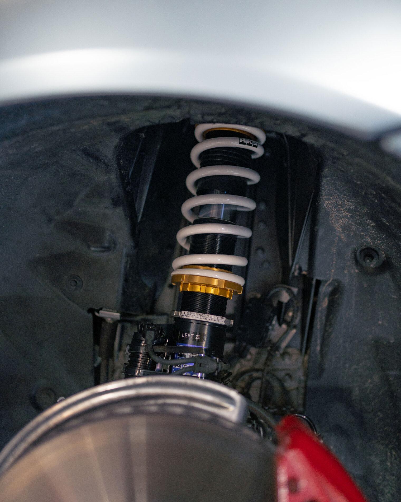

  • Titan Motorsports x SPLParts Rear multilink suspension package
  • HKS HiperMax SP Drag Coilover s
Safety
  • Titan Motorsports Roll-Bar
  • Tillet B1SC With Titan Seat Brackets
  • Titan Parachute Kit
Wheels/brakes
  • Weld S77 Drag Pack
    • Weld RT-S77 17x10.5
    • Weld RT-S77 17x5
  • Titan-7 x Titan Motorsports T-D6 Drag pack
    • 17x10.25
    • 17x4.5
  • Endless MX72 Brake pads
Tuning
  • Titan Motorsports FuelTech Port stand alone ecu package
  • ECUTEK for stock ecu
  • Tuned by our in-house tuner, Darin “doubleD” Dichiara

Do you have any data to share regarding the hks drag coilovers? Do you feel the difference in squat/separation that results in better 60ft?
