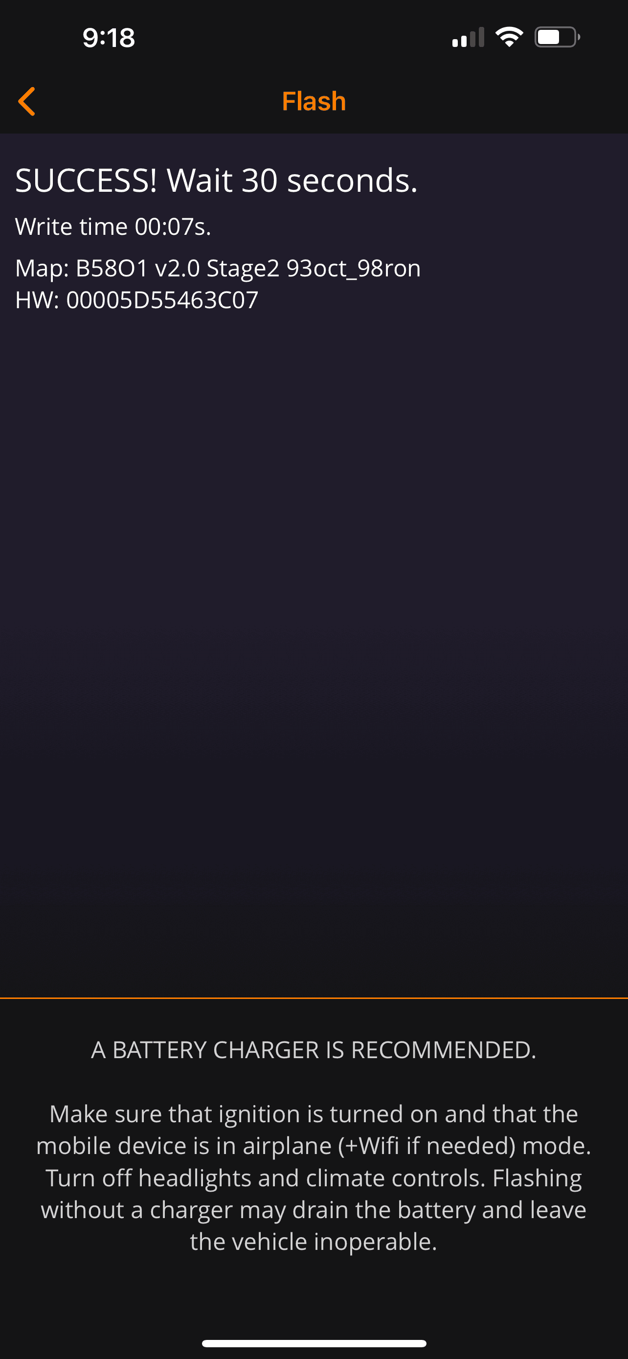

Unless you can reflash at the pump, yeah it's problematic in my opinion. I'm thinking it's a laptop and flashing software procedure?
Takes 7 seconds to flash a new map on MHD from my phone:
