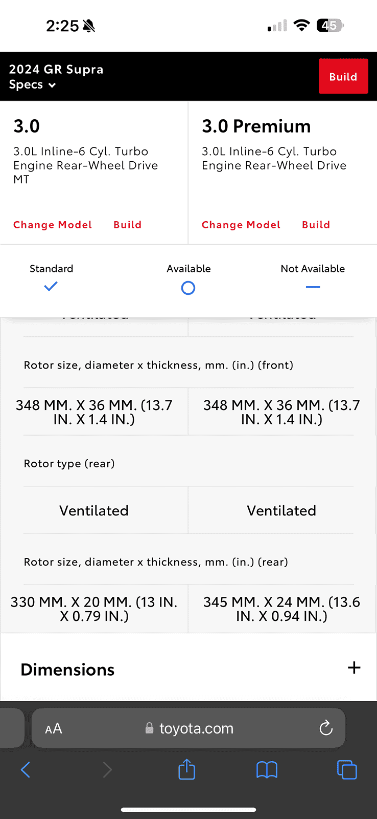

Hi,
What brakes does the 3.0 with the 6 speed manual non-premium come with? I was reading the rear rotors are made of aluminum. Is that true? Are the calipers the same as the premium just not red? I plan to track drive the car and was thinking it might be a good idea to switch to gyro-Discs right away and stell the stock rotors vs destroy them at the first track session.
anyway, I have the car on order but havenā€™t seen it or one like it in person yet. Any one have a similar model and can shed light on this topic? Thanks in advance!

From what I heard, the mt cars get the better stuff. So bigger rear brakes. They all get the same fronts. Stock rotors are just fine for track duty. No need to upgrade those. Just get better pads and fluid.

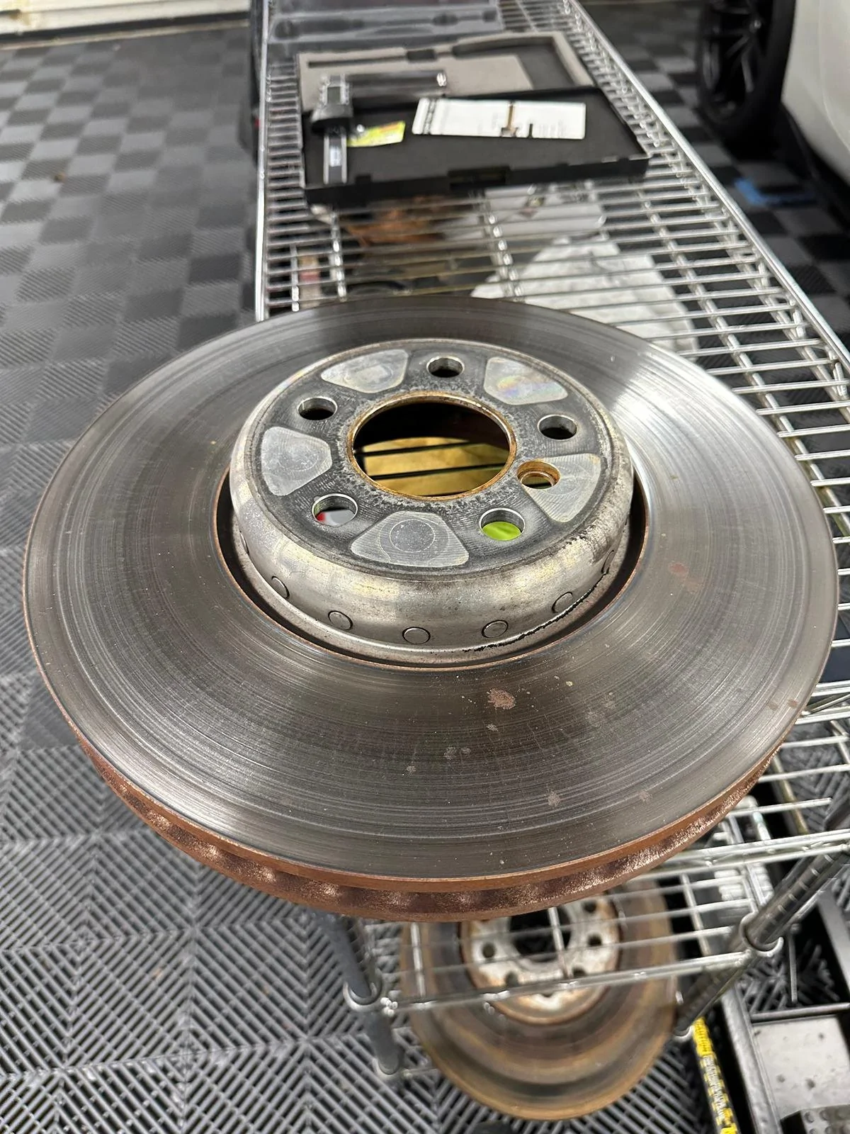

Rotors are never made of aluminum. They are typically made of a cast iron alloy.
concept
Dave
Sep 1, 2023
720
517
Southern CA
True, but I believe that when most people refer to rotor material, they are referring to the rotor disc material. As you know, the vast majority of brake rotor discs are made of cast iron alloy. An XRF alloy analyzer is often used to verify correct alloy material percentages. I used one during a time when I was designing stainless steel brake rotors for police vehicles. Those were coated with chromium in a PVD chamber.
