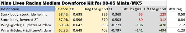

re PR material: aero maps would be a lot more useful as a published metric for these "packages", vs a line chart that basically just shows v^2... even a simple table of l/d f&r for a single speed is more useful.
e.g. this:
re adding aero: aero balance makes a bigger difference in laptimes, but a poor one with massive rear imbalance (static margin) adds to driver confidence when they first start out with aero (e.g. "look how long i can keep the throttle pinned and plow through a corner with high scrub")
