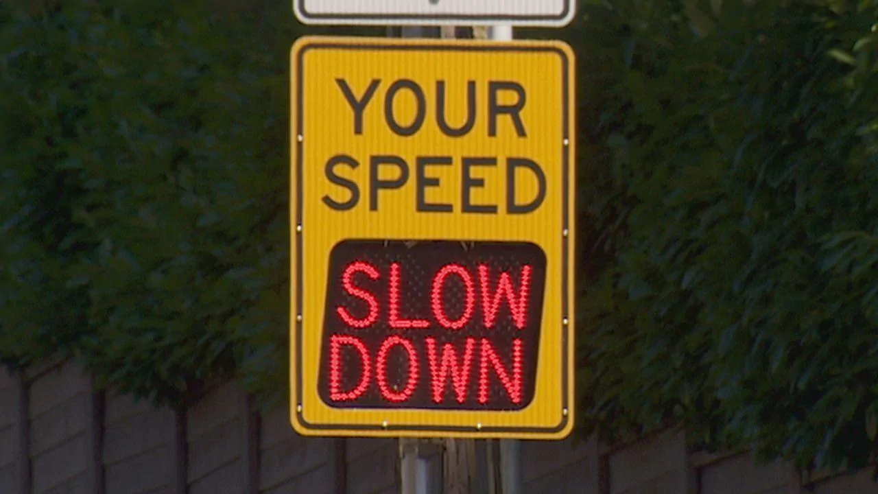

We have a few places around here where the police have been gracious enough to put "calibration signs" up... all I know is my speedometer is accurate to "SLOW DOWN" - whatever that means. :rolleyes:
I have these signs in my area & I recently realized not only do they say "SLOW DOWN" but also, "TOO FAST" at a certain speed threshold. Ive discovered this the other day driving the Supra lol.
