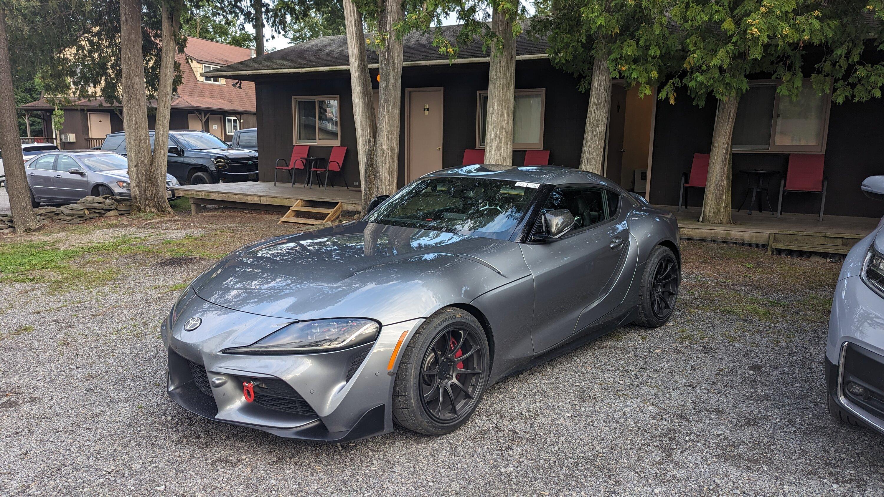

I'm running 18x10.7" wide Titan7 T-R10s square with 275-35R18 tires and Motorsports Hardware 15mm spacers. This is on stock struts and springs using SPL LCAs to dial in ~-3° of camber. I'm getting a very small amount of rubbing on my front left wheel liner under HEAVY cornering on-track.
I would prefer to be running 40 AR tires, but the Kuhmo V730s only come in 275-35. The tires are definitely a tiny bit stretched, but the turn-in is fantastic. Next season I may go with 40 AR Nankangs since I'll be on coilovers of some sort.
(Picture was taken at Seneca Lodge. Those that know, know...)
