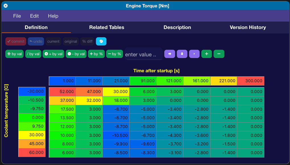

As stated, cold start warm up and start up roar are two different things.
Start up roar is set by requesting additional torque request on startup, which causes that rev flare.
You can see how it acts with OEM programming in this main table:
OP, do you have GTS startup roar selected in the BM3 preferences?
BM3 only has "On, Original, and OEM" settings for the GTS start up roar settings. There's no "off" option.
There is no ON or OFF option. Mine is left alone (OEM)
