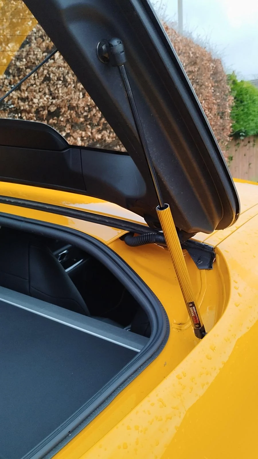

Just a small Update: Emerald Struts completely ignored me in regards to seeking there product to fit, not even "we dont want to help" type email.
Not used the car much due to a mixture of terrible weather and working from home so cant update on the effects of temperature on the struts at the moment.

Very pleased with them, seems well made..... how long they're gonna last....is anyone's guess

Does it stop the trunk\boot from closing after you've popped it and then close the drivers door? That's my main annoyance.
J29DB03
Dec 14, 2021
1,724
3,270
2021 Absolute Zero 3.0 Premium
Windows down prevent this. Not a solution but maybe helpful.

Ive had the boot closure issue for a long time. As stated by J29DB03 windows down or door open stops it because its an air pressure issue. Once you close the door it forces the air to lift the hatch and its just enough for it to latch back down which is infuriating. One thing you can do is adjust the rotational stoppers protruding from the plastic light cover so they are higher. I did this and it didnt change anything but many people on the forum have had good results. Mine are at the maximum the thread allows and it still locks but i think thats because of the failing struts.
Yes they do..... just tested it 👍
