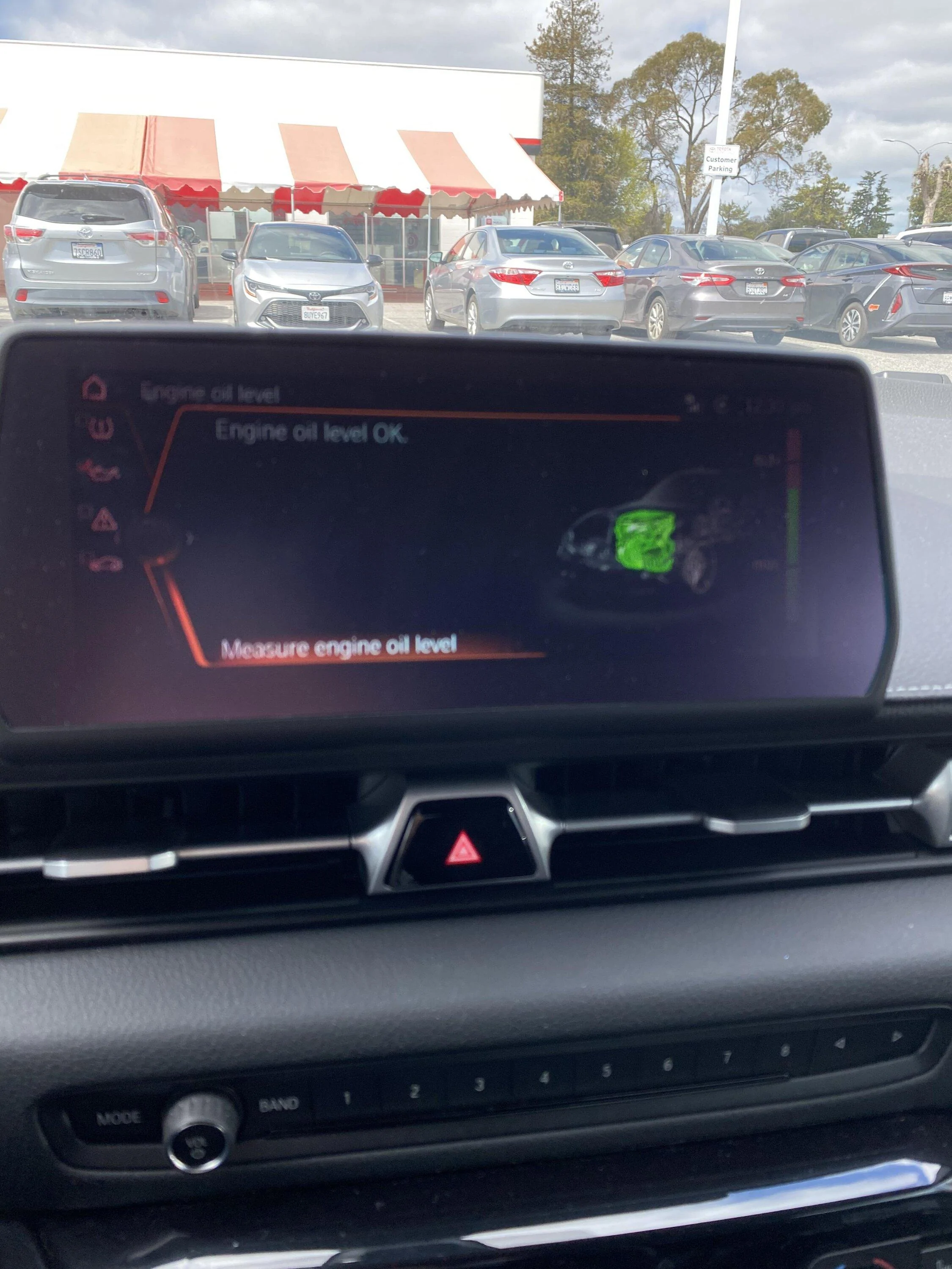

This seems within spec. You’re engine is still settling in. Did you take a measurement once oil was changed with an OBD app? The level should be 97-98mm when full.
It could also be that you started slightly less than a full top off.
Please keep in mind that you can burn 1/2 a quart before it goes below that top green line.
