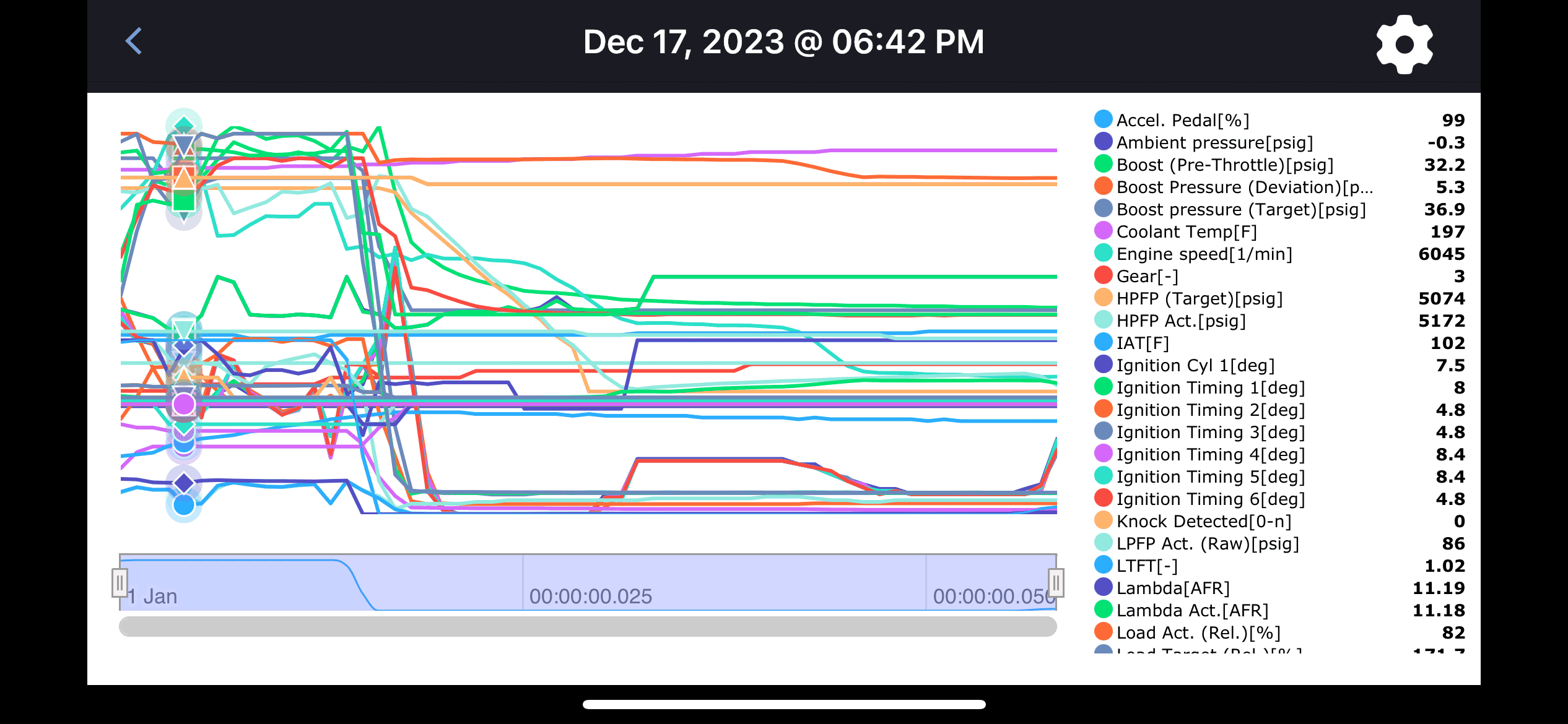

car feels and sounds great. Pulls strong with nothing out of the ordinary.. except the amount of boost. From the handful of logs Iā€™ve seen, it looks like most people with similar setups are doing low to mid 20s for boost with ethanol. Before ethanol, my car was logging those boost numbers. But now itā€™s saying itā€™s in the 30s. Both MAP and prethrottle boost have similar numbers.
Iā€™d imagine the turbo is well out of its efficiency range, but IATs are still looking good. Any thoughts on this?

doubt your pressure is in the 30 psi range. Subtract 14.7 and thatā€™s your boost minus atmospheric pressure. If you subtract the target boost with 14.7, thats right around 22psi.

+1 PSIA vs PSIG.

that sounds very reasonable; although I did double check my settings, and my readout settings for pressure is set as ā€œrelativeā€ vs absolute. Iā€™m under the impression that ā€œabsoluteā€ would not correct for atmospheric pressure- but this is out of my wheelhouse.

Contact bm3. I had the same issue even when set correctly. They had to do some updates to their software.

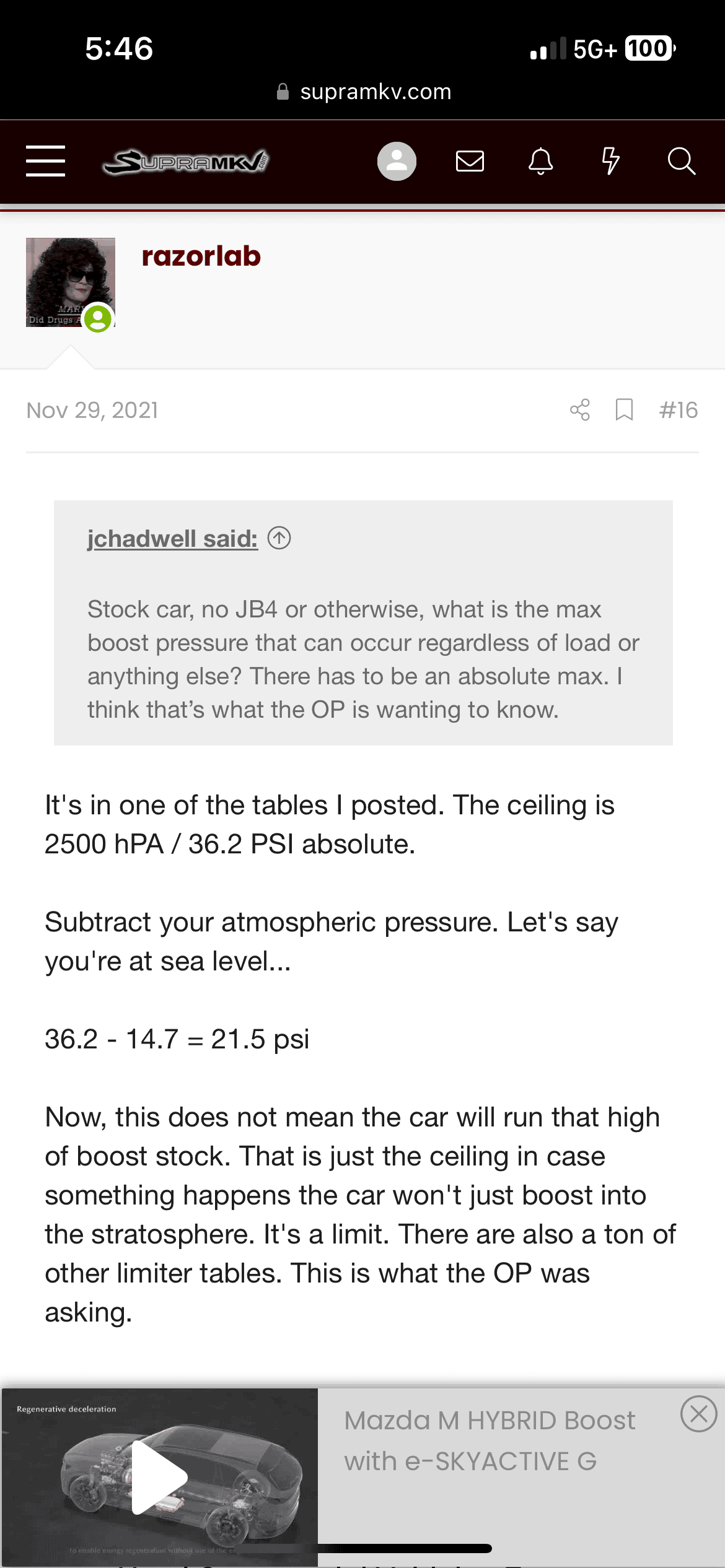

thank you for sharing your experience. @black_sedan reply actually lead me to an old post you made. This seems to be the right direction!
Obviously off putting when the screen shot of my data log shows ā€œpsigā€

i suspected that it was a unit labelling bug too, but wanted someone with hands on experience to confirm. sometimes no info is better than bad info.
