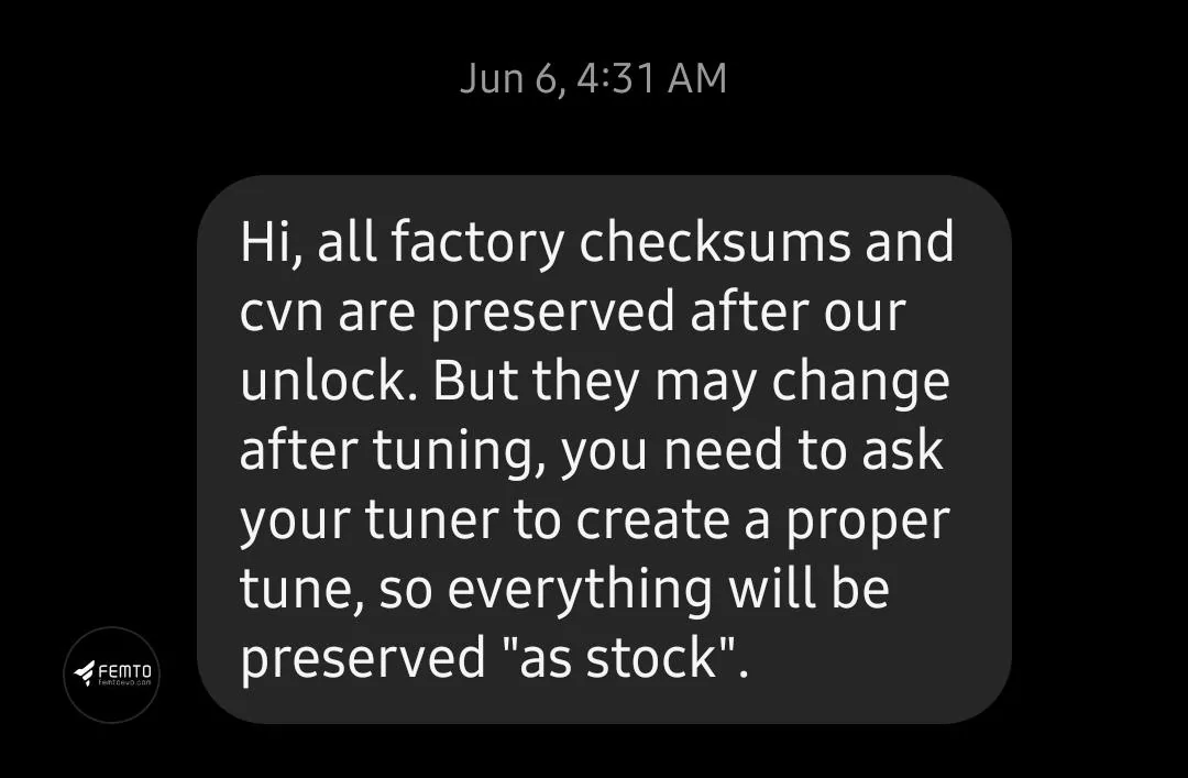

If you are in any state where emissions is validating the checksum of your ECU, you need to look into tuning more as most of them will change the checksum, or if you flash back to stock will not return the checksum to the OEM value - your only alterantive at that point is to get a reflash/lock from Toyota and then do the Femto send off all over again.......OR get a secondary ECU and run ECUTEK.
According to Femto, factory DME checksum is preserved/saved as part of the unlocking process.
This is in the context of bench unlock and using BM3 CustomRom. I would agree that the safest and full proof way to pass would be cloning.
