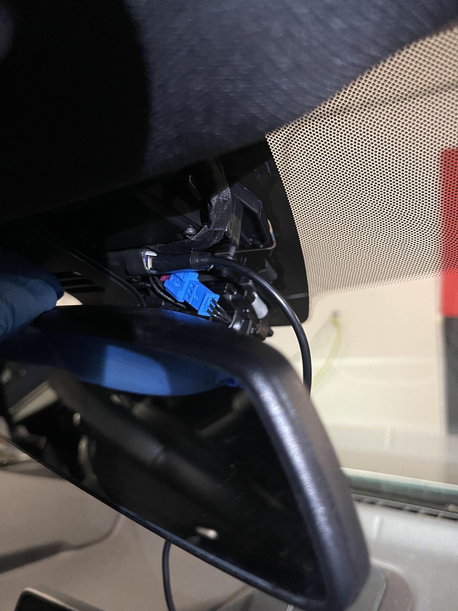

I use a dash cam and wanted to have a clean install other than running that long power wire around to the cigarette lighter. So I was given an usb splitter from
https://dongar.tech/products/porsche
I installed this and everything worked out well. There is plenty of room under the plastic covers for you to tuck the harness. There is enough space between the plastic cover and the window to allow the cable to come out just about anywhere.
There is only one thing that I noticed, the 3 pin connector inside the rain sensor compartment appears to have power on all the time, which means your dash cam will stay on constantly. I have tried to lock the car with the remote, the power does not cut out, and the dash cam stayed on overnight. So you have to manually turn on and off the dash cam itself.
for full disclosure, I received this harness for free as parts tester
picture 1- this is how it looks when you first pull off the plastic cover, the red connector is the one needs to be removed

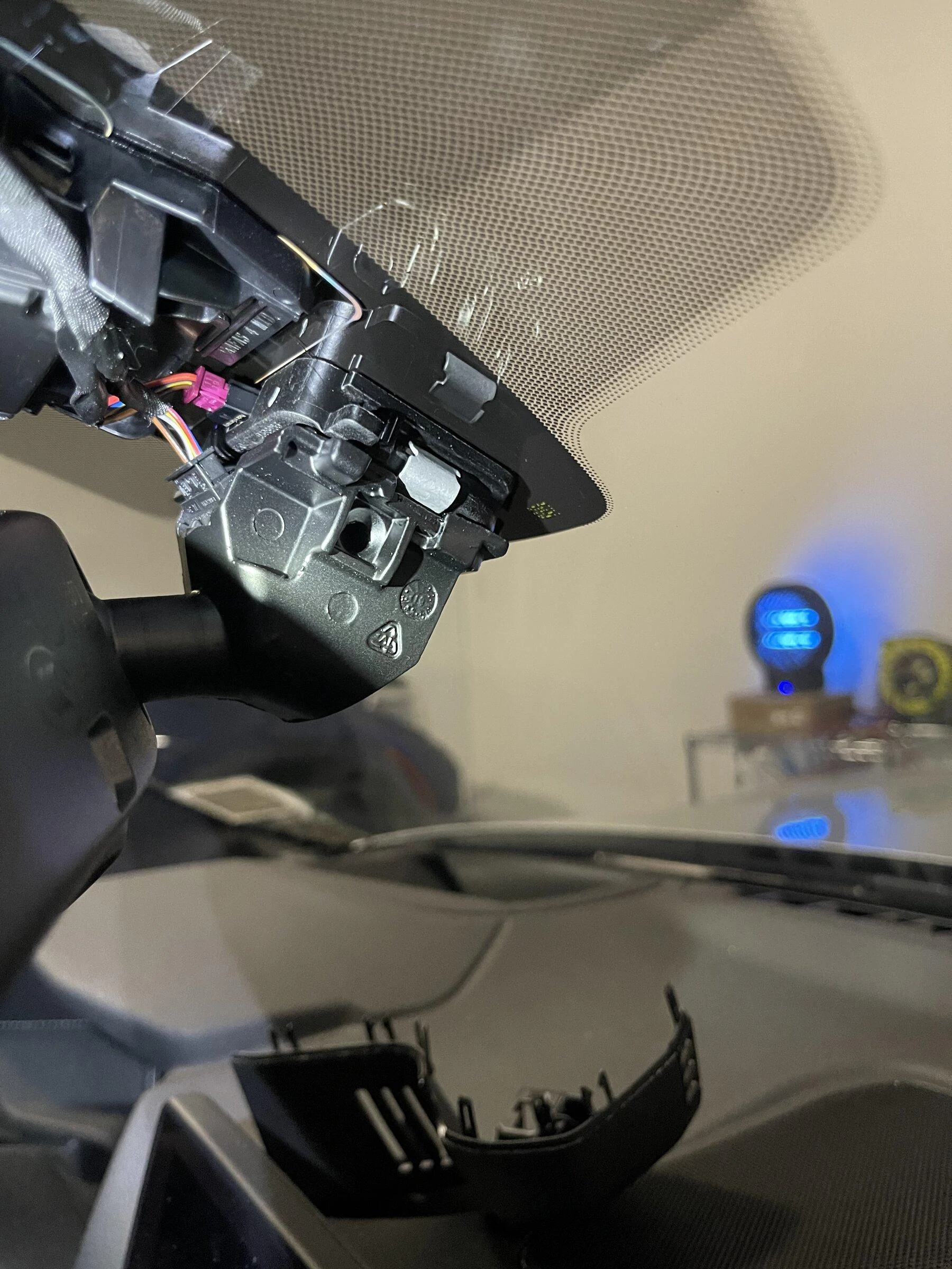

Picture 2 is what the harness looks like before installation

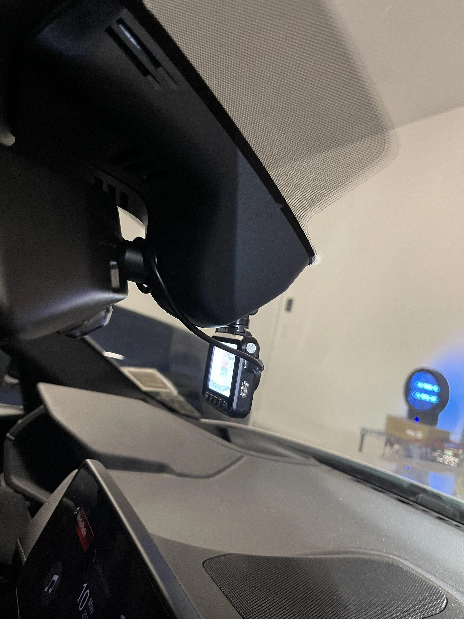

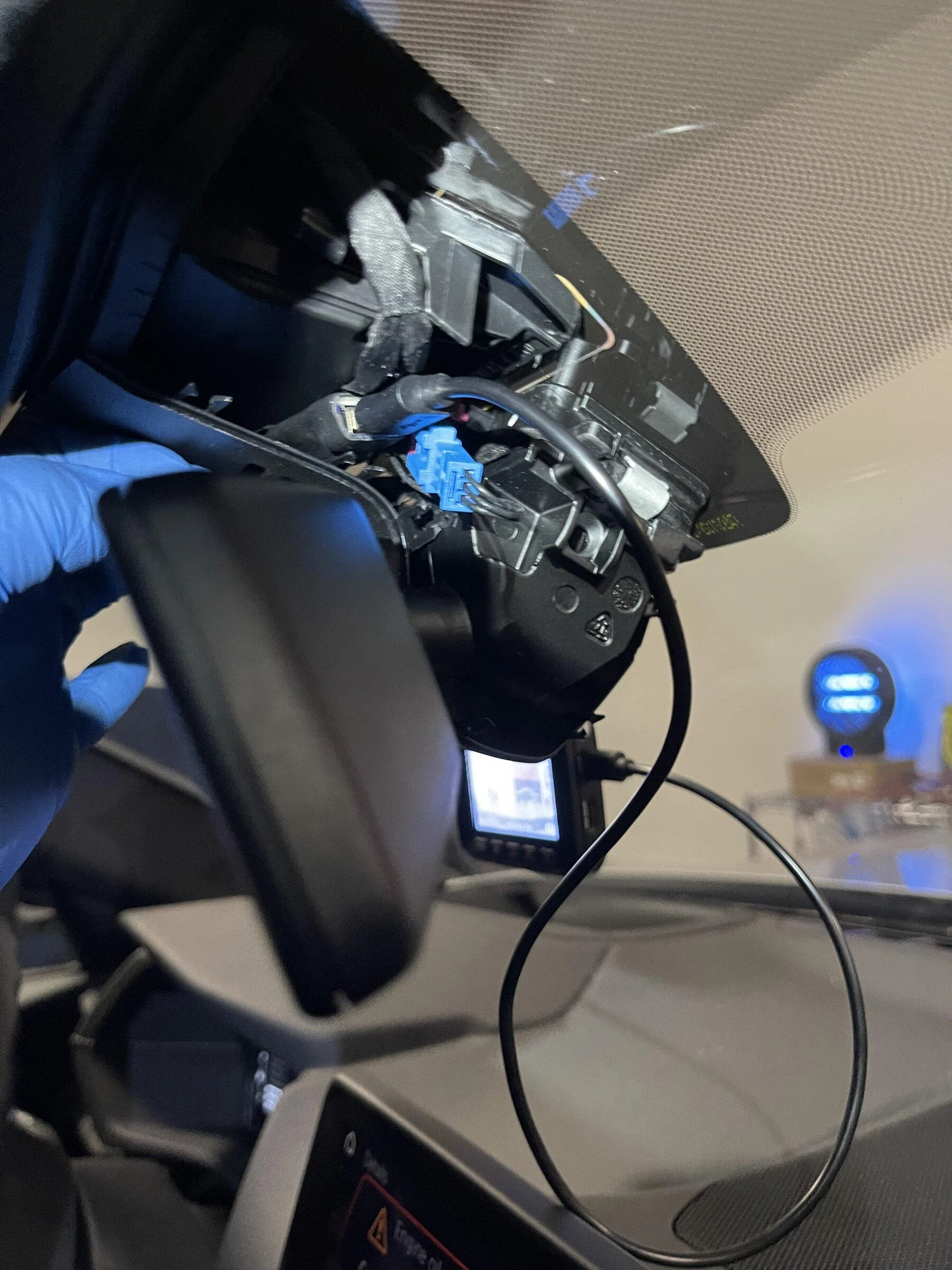

picture 3 and 4 –show there is plenty of room to tuck in the harness under the plastic cover

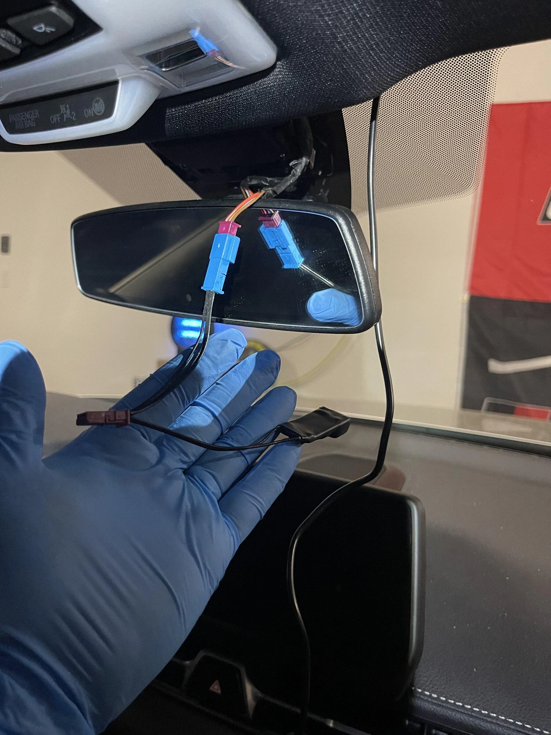

picture 5 - after re-installing the plastic cover
I found the best way to separate the two pieces of plastic cover to expose the rain sensor is to use a flathead screw driver. Start to wedge the flathead at the very top of the seam between the two half,you Can easily wedge it in at the crack where it meets with the headliner. And then slowly slide the flathead down towards the center and then gently twist and separate the two halves.
