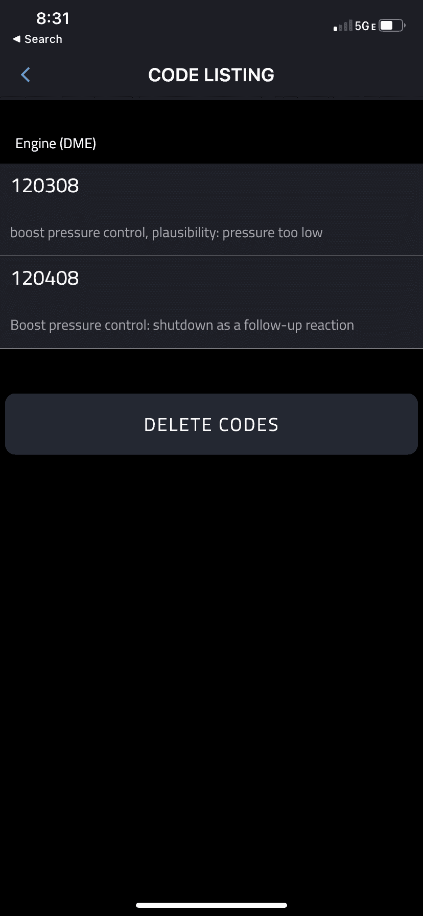

Well, what's the code brother. We can't do anything until you give us the code.

This is really weird… I just turned it back on and it disappeared lol

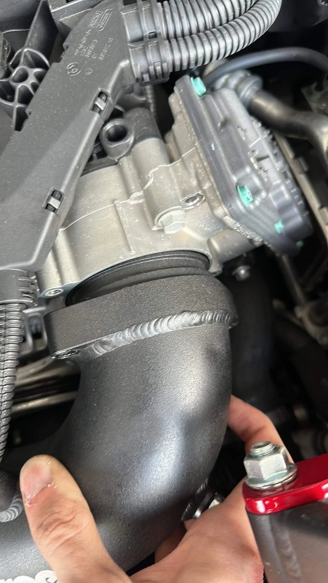

When I said the car was stock i meant not tuned it had a ftp charge pipe, armaspeed intake, and catback exhaust. I just did some research and there is another guy with the same issue with an ftp charge pipe and an armaspeed intake which I find interesting

Boost leak.
Cheap the charge pipe couple. Make sure the chargepipe is seated properly. Make sure you didn’t @Jrob it and properly transferred both gaskets/o-rings.

Thanks will try that!

Having bolt ons doesn't make it stock then... changing any part will add different variables that will cause issues. In your case probably a loose clamp.
