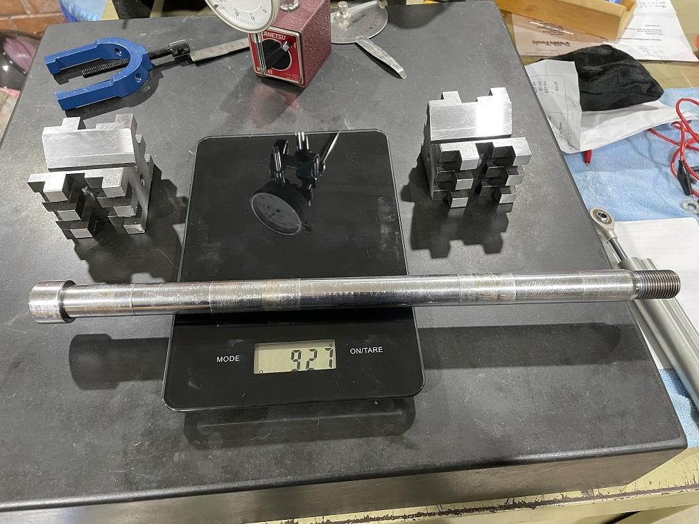

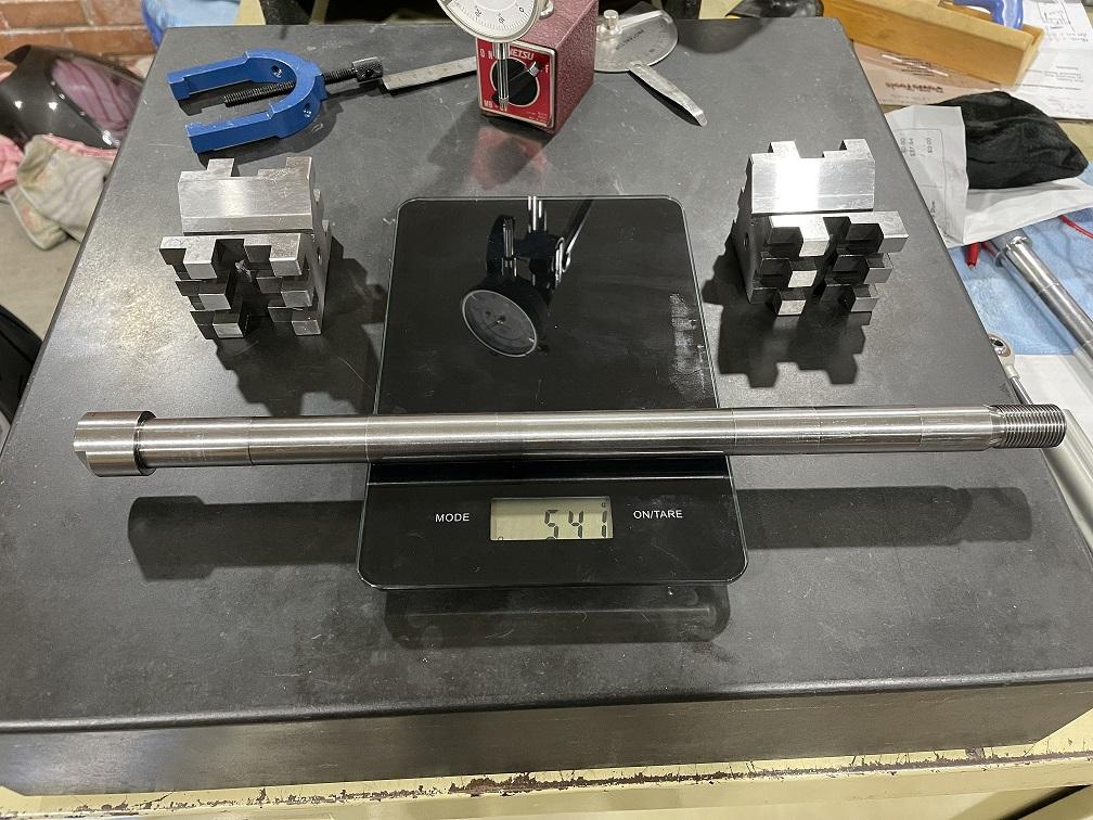

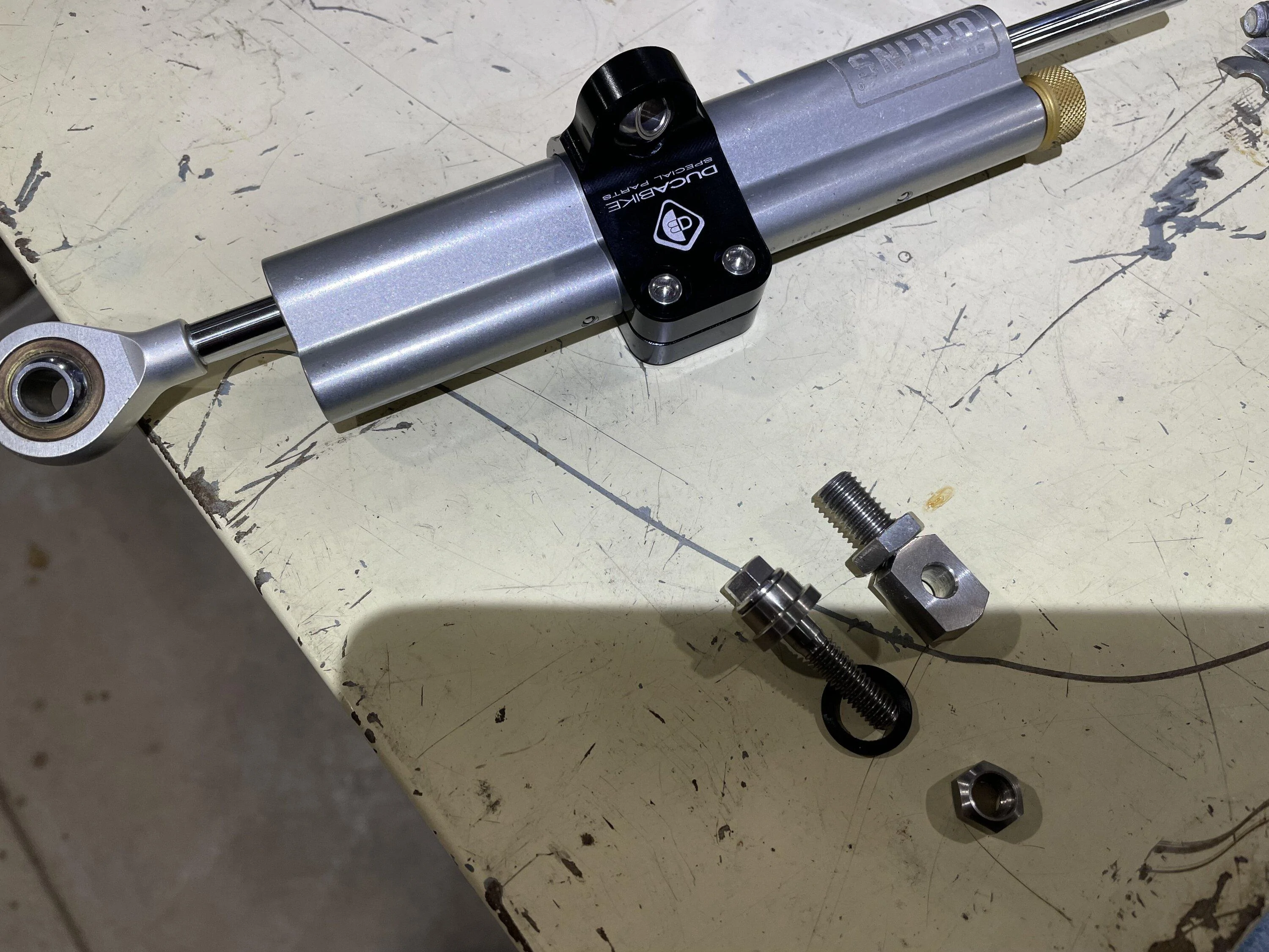

Not meant to be misleading just informative. What should be done and what is done are different things. Manufacturers don't lube lug nuts and their torque requirements are based on dry figures. Ti is much worse than say grade 8.8 steel bolts for galling. I know Ti material pretty well as I machine my own Ti components and use it extensively for fasteners. Have for many years both in automotive and aviation. Just saying use them by all means but remember to use anti seize.
A few items I've made recently in Ti. Steering damper attach fittings and a rear axle for one of my bikes. Ti axle weight V original steel axle.
