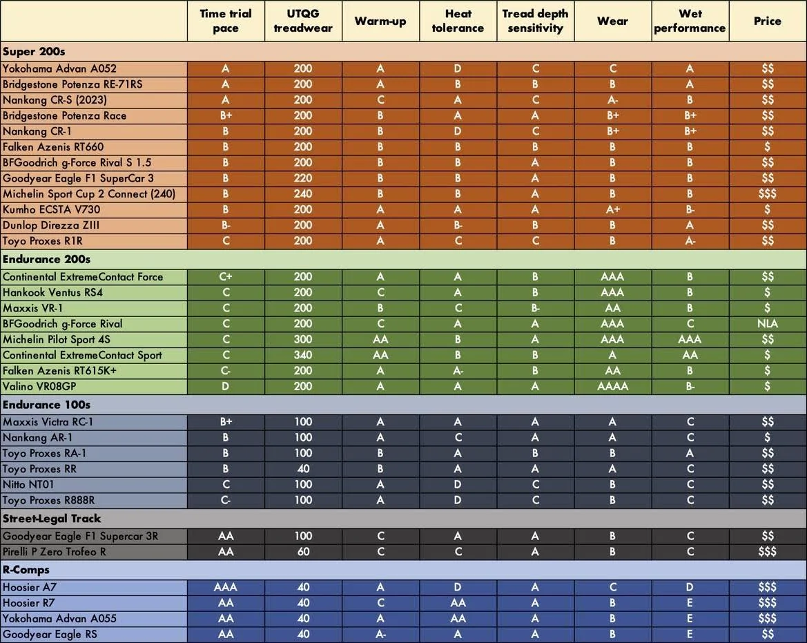

Also looking at continental or ps4s once these are worn out. Any inputs

And because you asked about tires:
Unless you’re driving 20k miles per year in town, the Kumhos are a lotta bang for the street to track buck. Endurance 200s will last you longer. Have fun!

Not a 1:1, but I had 265/35/19 and 295/35/19 PS4S tires. Got 6 track days --> ~10 laps per session x 7 sessions x 6 days = ~420 laps (1050 miles) out of them, but was definitely worn on track day 6. But I'm also on aftermarket suspension with a different alignment, so my wear characteristics are likely different than yours.
Best I can say, take a look at the end of each day at the insides and outsides to see what's going on
