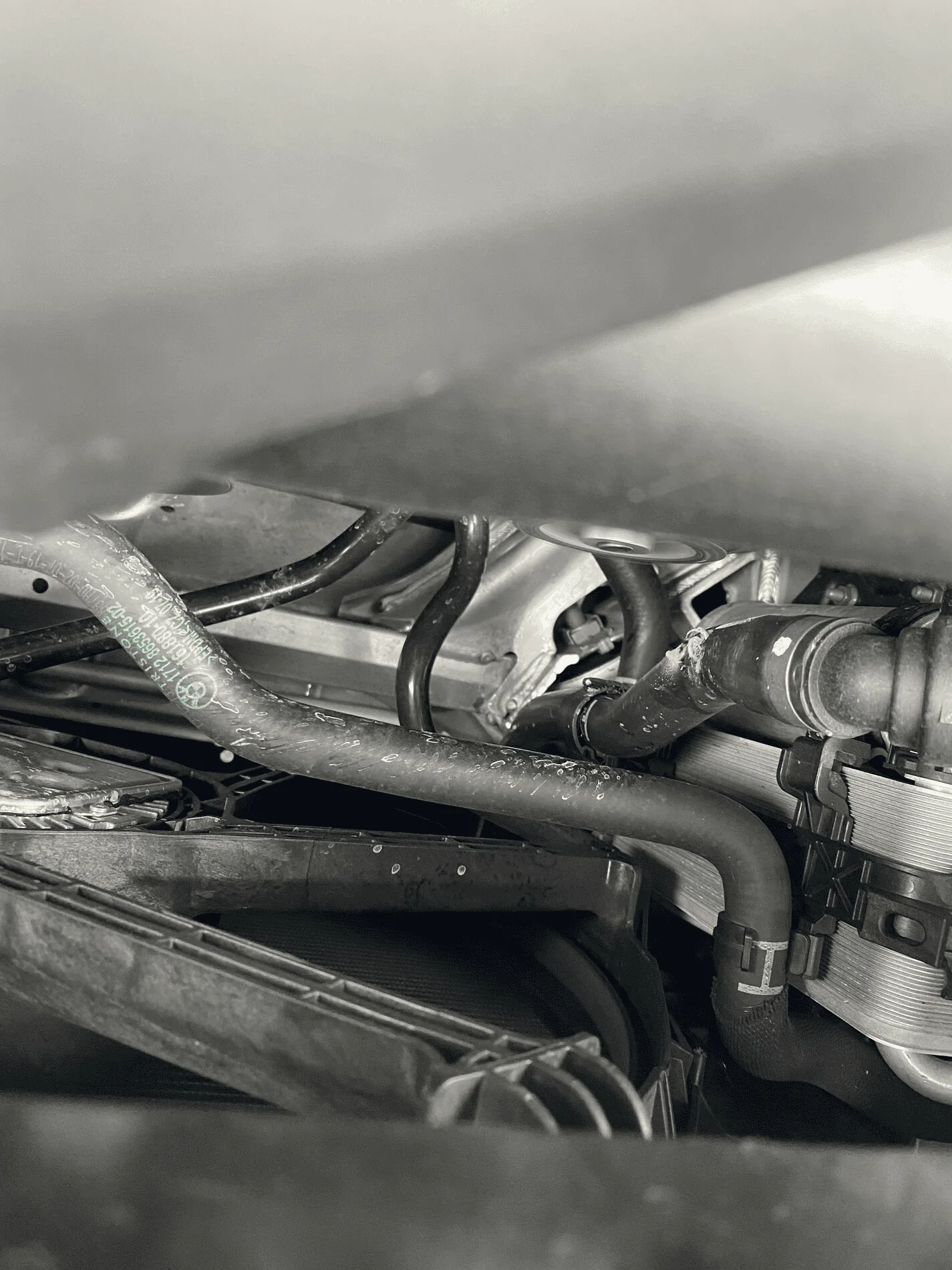

Been looking online parts catalog but I cant find it..
Any toyota part reps in here?

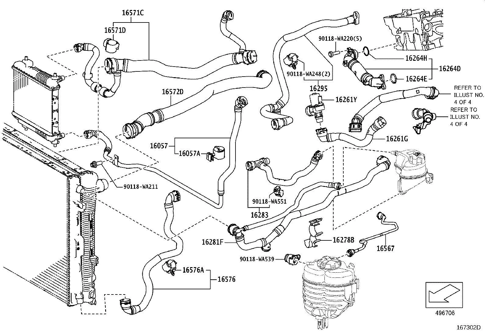

I've no idea, when I just searched for 16057-WAA02 this came up:
https://toyotaparts.mcgeorgetoyota.com/oem-parts/toyota-water-hose-16057waa02
Your picture seems to suggest, the hose is going to the remote radiator on driver side.
Perhaps little more search is needed... sorry for sloppy work here, didn't even realize this before you pointed out!
Honestly, I truly appreciate the help anyways! I've ordered the part, hopefully the "right" one comes. Apparently some "rodent" walked in to my engine bay and decided to chew on the top portion of the hose and caused a leak. - (Toyota)
