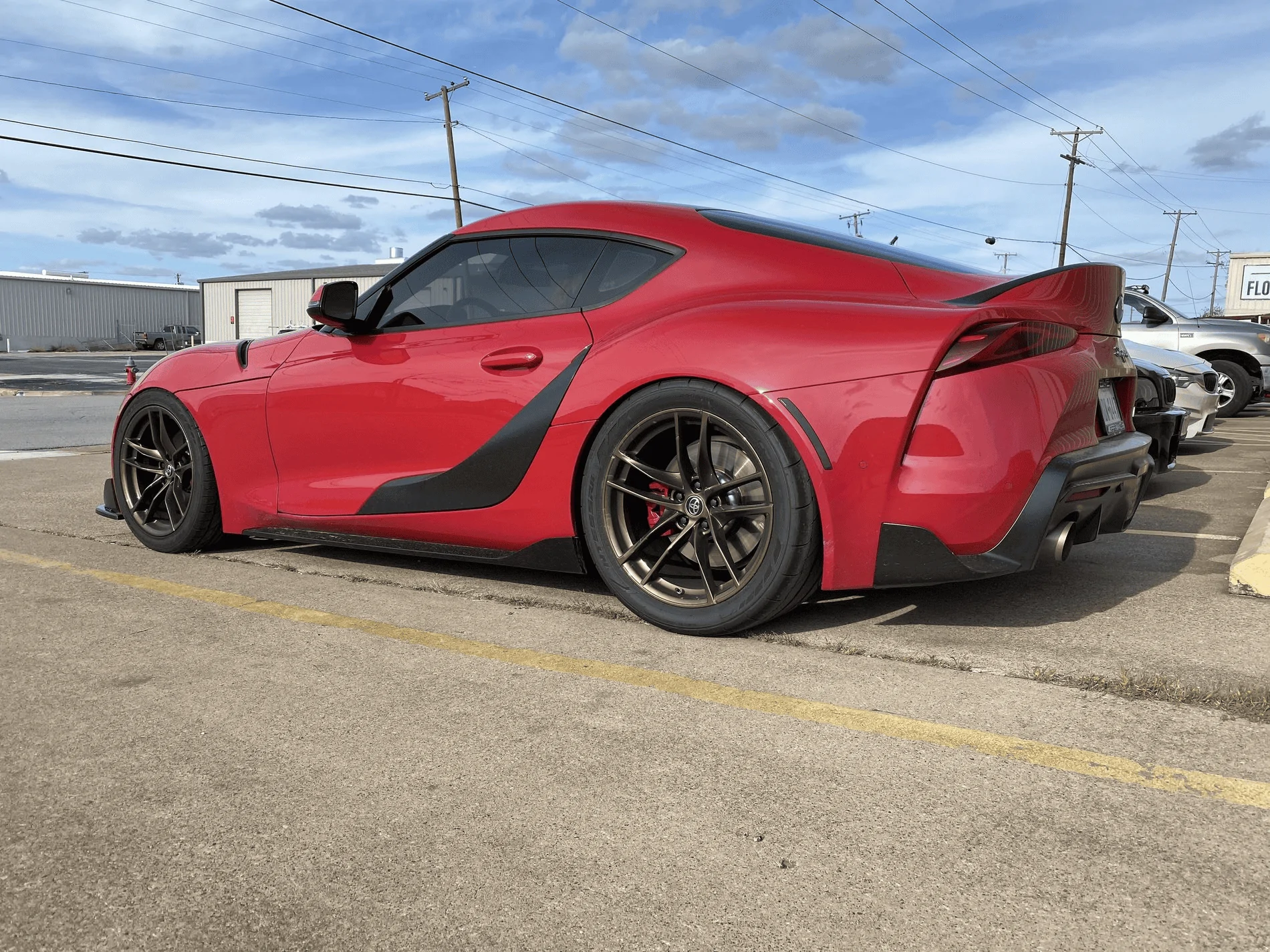

I have a 295/35 and the tire looks way to bubbly(for my taste)...
I should have went with a 30 series tire...
I think a 40 series would make the tire look like a drag radial...
With the 295 rear it car still spins but not as bad as the factory 275...
At stock power on a 21...
