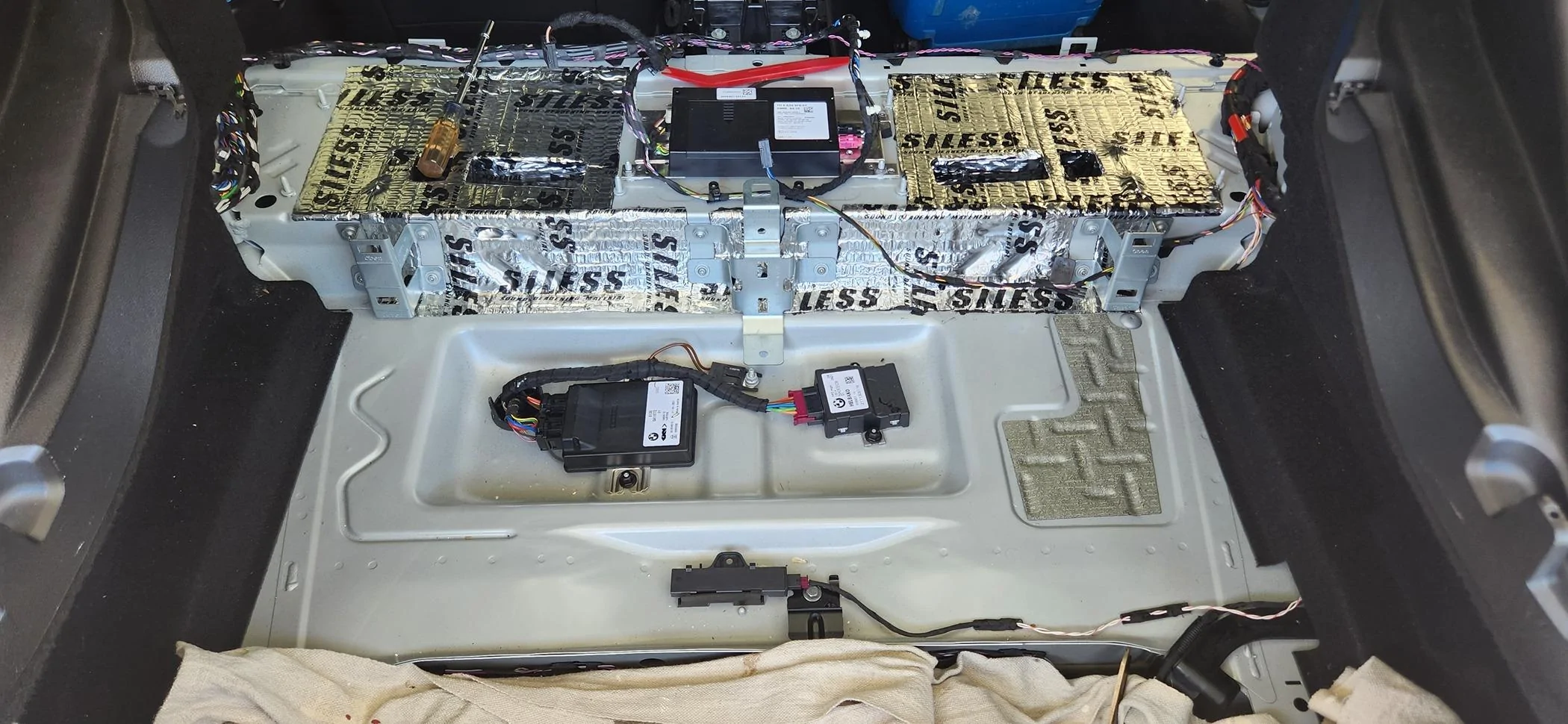

I personally chose to improve the stock subwoofer enclosures while adding ports. Literally a <$50 parts upgrade (+ my time) that improved bass response 10x.
