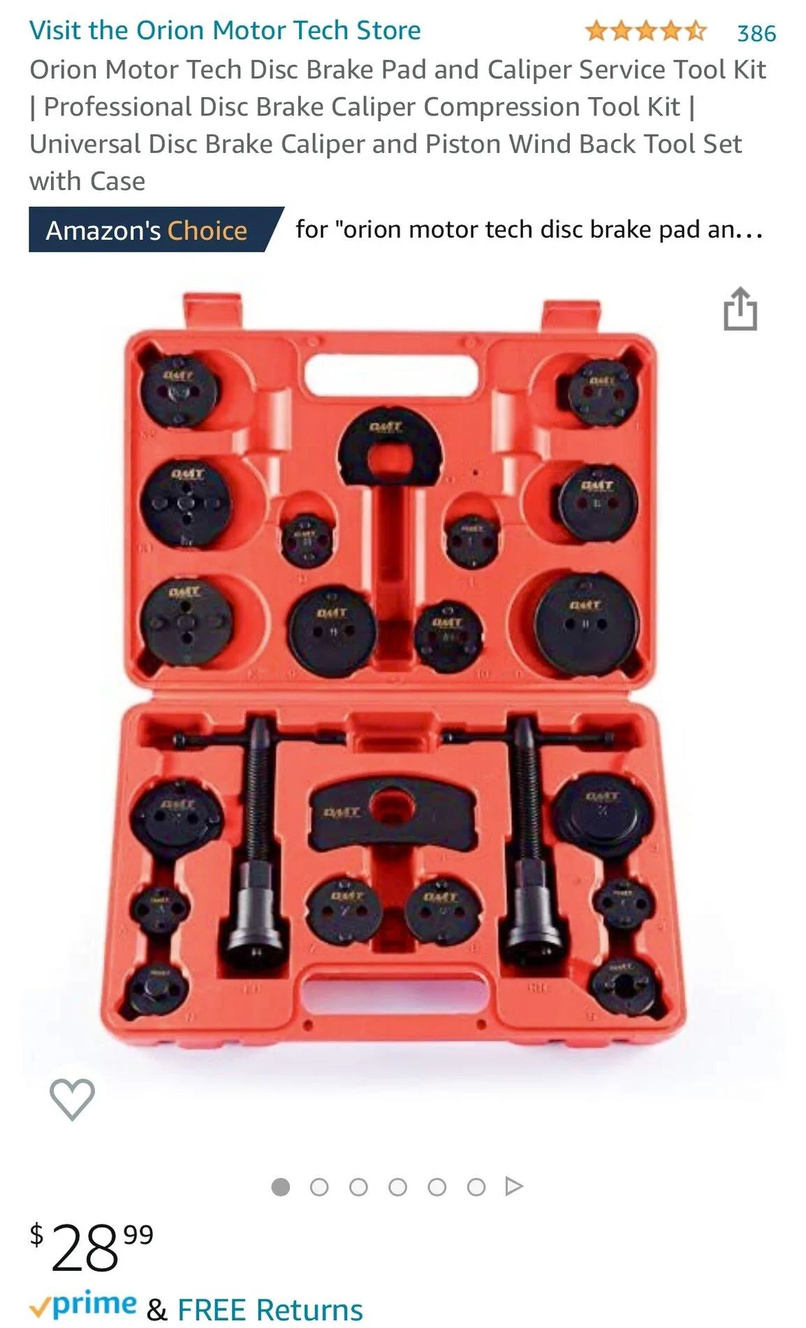

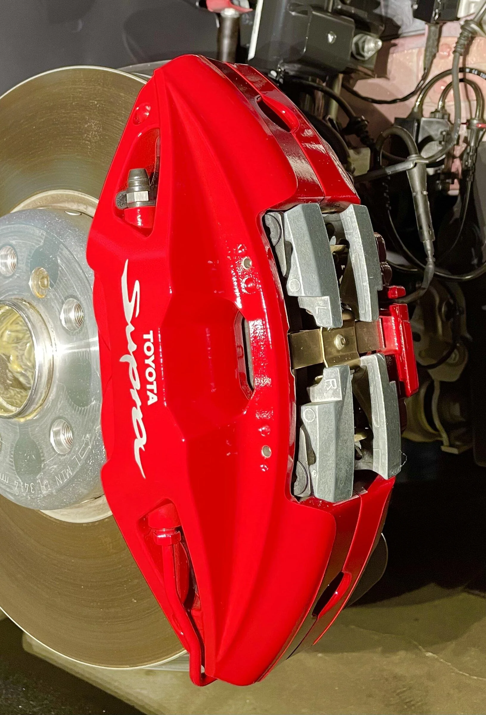

Looks super easy exc for getting the rear piston retracted. No way am I using needle nose pliars and channel locks to twist it. There is a BMW tool for that job??? Suggestions. Also how to get the glued on pads off the first time. Prying on the painted caliper also seems like a terrible idea.
This is the kit I use to retract the rear calipers. Also, Iā€™ve never pried on the front calipers. I use a few pieces of oak wood to remove them. I tap them out from hub side.

Orion Motor Tech Disc Brake Pad and Caliper Service Tool Kit

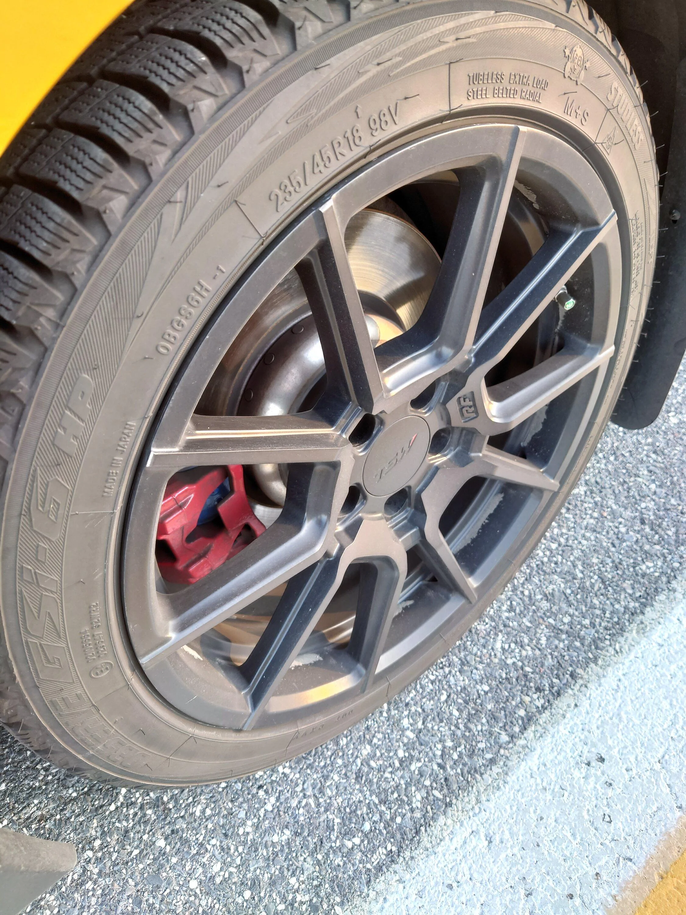

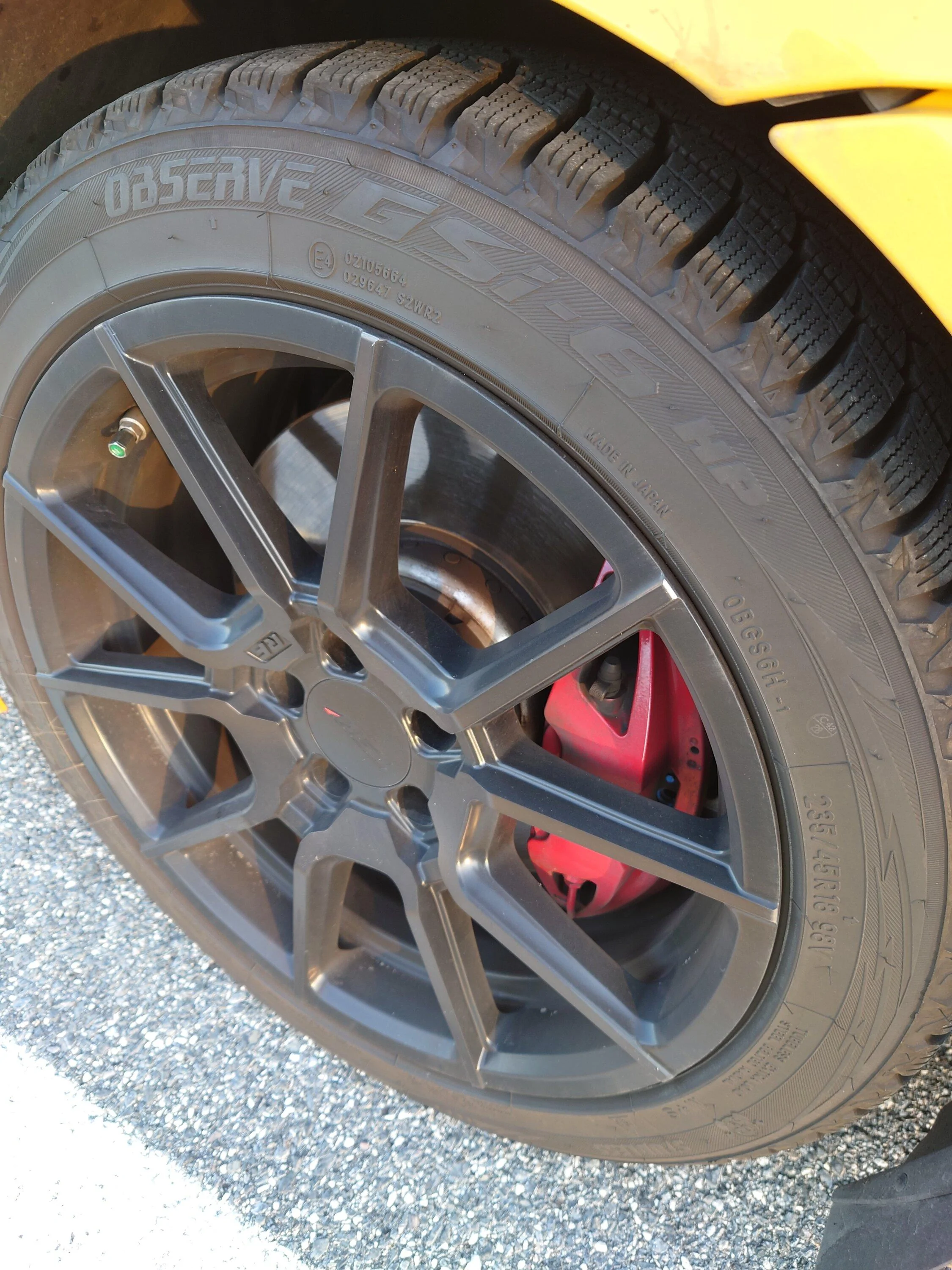

I've had Endless SSM Plus on for three months and like them. Good feel, no noise, some dust but it cleans way easier than stock. I don't have experience with any other pads though.
Fronts show very little dust and rears have some clumps

Finally! So glad to hear from someone running these.
Someone in the thread said the Powerstop Z16 seem like 90-95% less dust compared to stock, how many % less dust would you say for the SSM Plus? How many miles before dust shows up?
Does braking feel and performance improve compared to stock?
