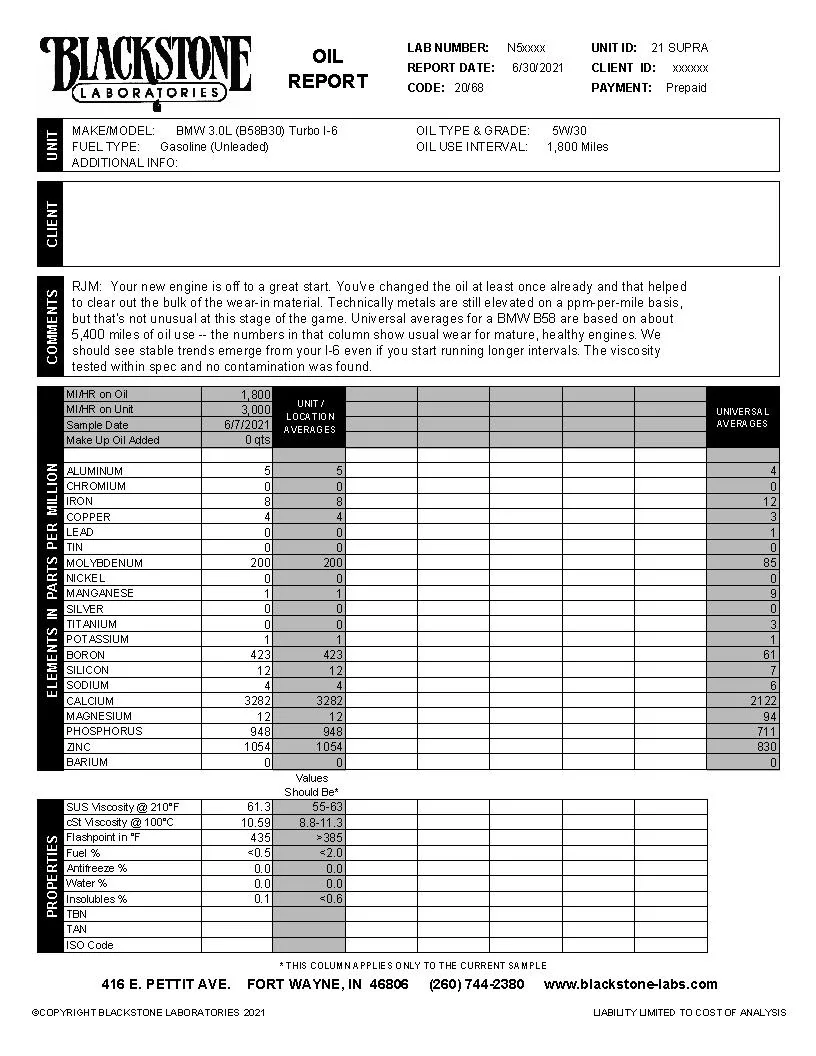

My Blackstone report just came in. I’m going to run another report at 5,000 miles to see if anything changed.
Stats:
- 2021 with June 2020 build date
- Hard engine break-in
- Dumped factory oil at 1200 miles and switched to Liqui Molly 5w-30
- 1800 miles on lab sample oil
- iDrive showing max oil level at all readings
-RJM

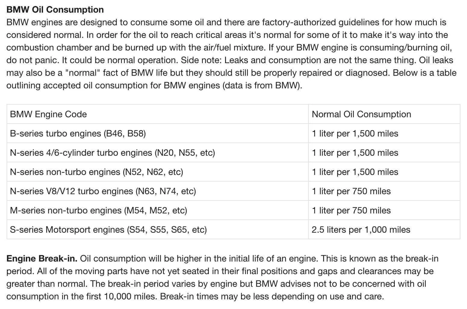

1 quart every 900 miles is definitely not acceptable. Have the dealership check the cylinders for scoring and defective ringlets.

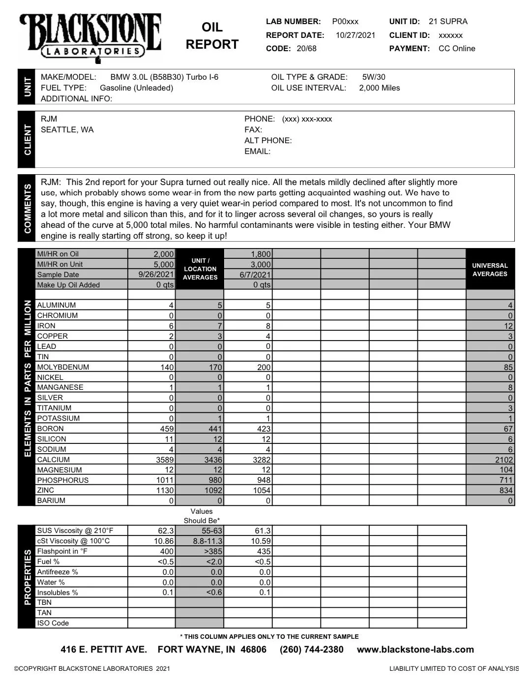

Adding the report for my 5K oil analysis from Black Stone. This was for the Liqui Moly 5w-30.
-RJM
Upmost respect for you, side note, but what does this tell us? I used to just put oil in my car when it looked "dirty". Sometimes I'd add oil in between oil changes if low. Life was good. Now I own a Supra/BMW. Can I just buy liquid molly 5w-30 (or 40) and call it a day?
The report is just peace of mind that the engine health is doing well as mileage increases.
Its a case by case basis. If your car is slightly low between oil changes then switching to Liqui Moly 5w-30 will improve the oil consumption.
If your like the guy above that burns a quart every 900 miles then no oil will improve that.
Also if you’re tuned like me and pushing 20+ psi of boost then you will see more oil consumption than normal.
I measure my oil level with an OBD app every time I’m at the gas station. If my oil level is a few mm low I will add a swig when I get home.
