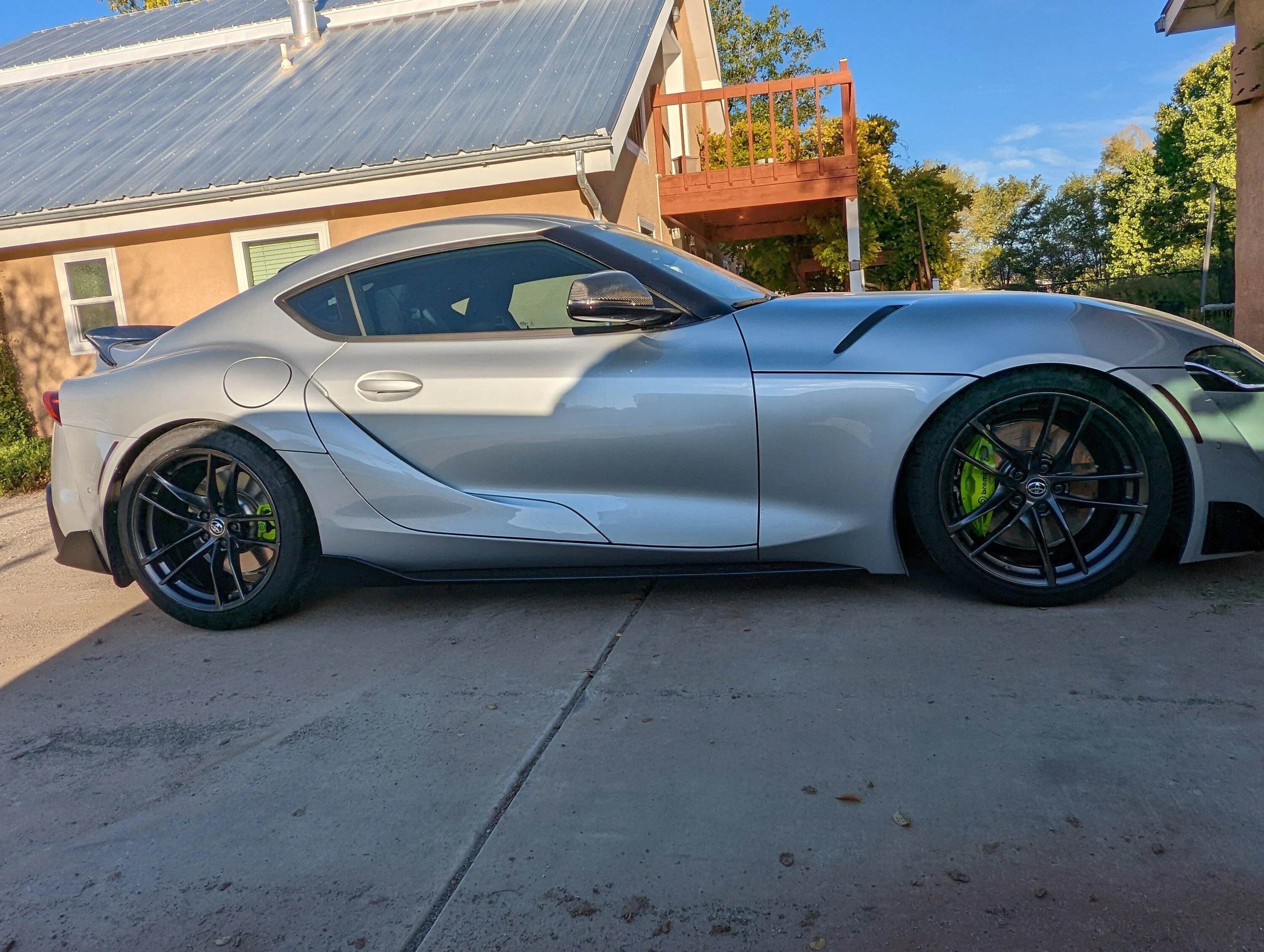

Did they happen to say how they did it?
Just using paint/powder stripper. Could also media blast it. Both are commonplace at powder coating facilities - usually a step 1 before powder coating. The person who posted that picture actually had stripped it before powder coating and liked how it looked so kept it as-is.
Be careful using stripper though, one person's shop left it in the stripper for too long (overnight?) and actually deteriorated through many sections of the wheel - permanently destroyed and pitted the wheel.
You can also mechanically polish or machine/brush the wheels after and then clear coat it to preserve the look and make it easier to maintain.

Yeah, that definitely doesn't look media blasted unless it was polished out after. I'll have to strip mine and see how they look.
