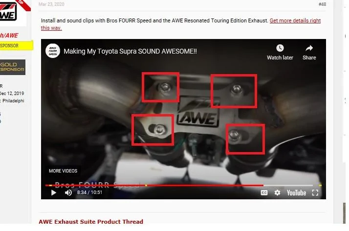

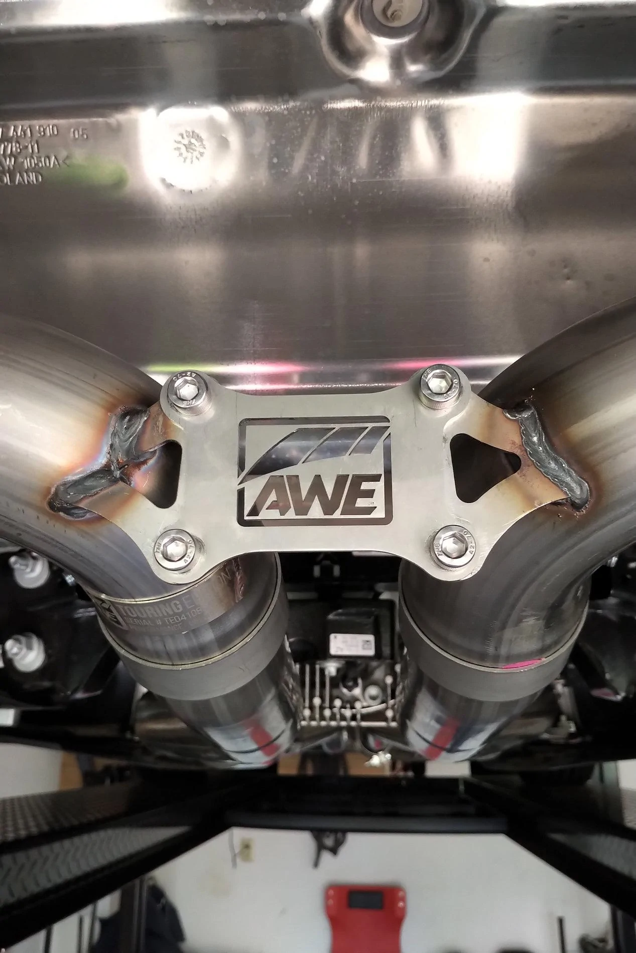

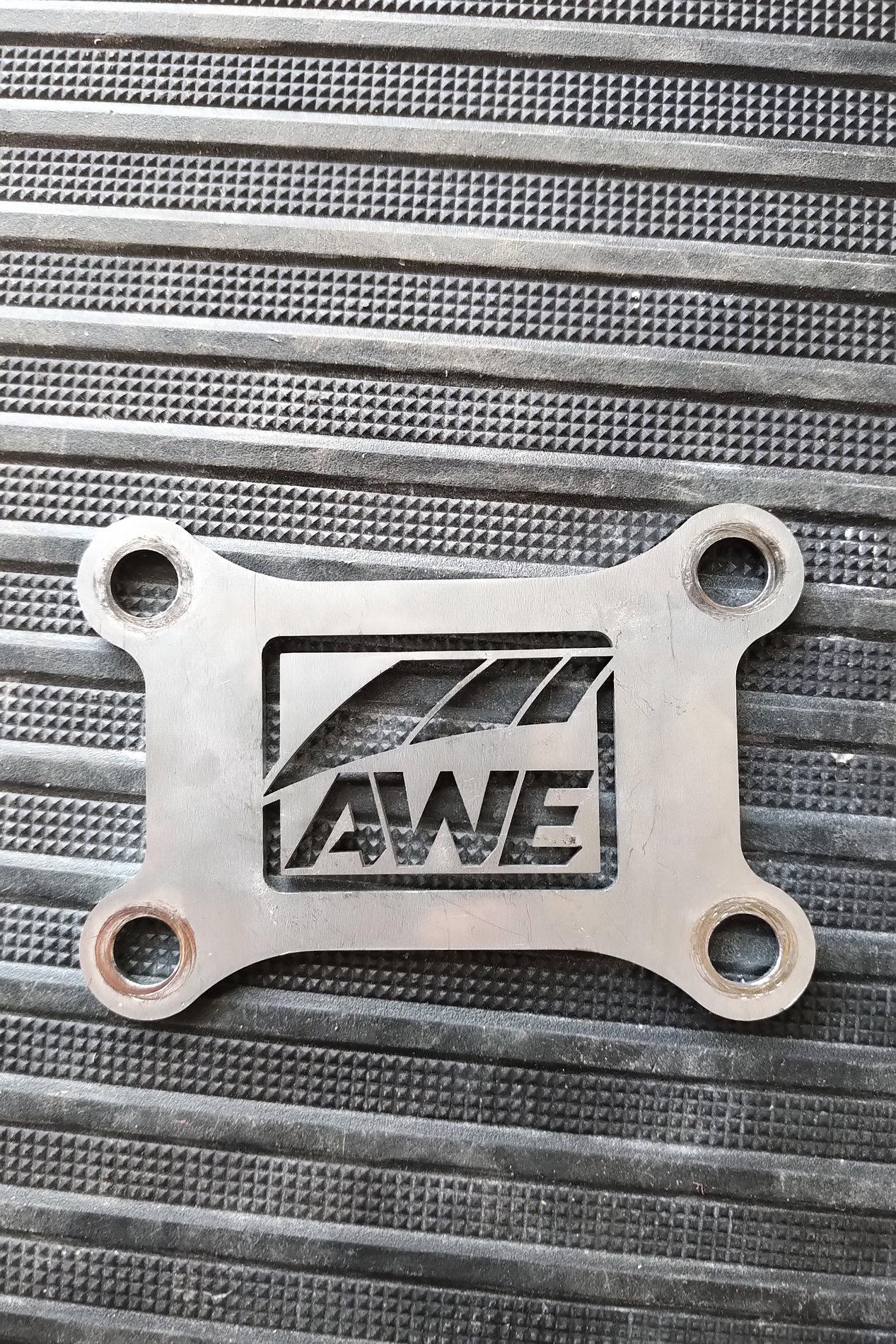

I have this exhaust and while I like it in general, I have been going crazy trying to get the fitment right. I just cannot do it. It is to the point where I had to order all new clamps. The tips pinch the inside of the bumper and hang too low. I was directed to the "how to align" videos but that is not the problem. After carefully studying the brothers video I think I found the issue but do not know how to resolve it (why don't you contact awe support?) --because there is such a crazy amount of info wanted to fill out that form I might as well be filing taxes.
It looks like much of the alignment of this system is dependent on that center "AWE" plate to space and position the mufflers. Compare what I actually have to the brothers video it is really apparent what the problem is. The actual system has nearly no play whereas the brothers version has an enormous amount of adjustment ability. Worse off, it appears to be on the bracket side not the plate side. There is not even the material to drill out the plate to give the kind of play that appears to be needed. Look how far out the brother adjustment is.
I wonder if I was sent an early model of this that has since changes..... How does one go about fixing them? creating a new plate? Replacing the muffler assemblies with the right brackets? I hate to post this here but the support form is way to overblown.

Without the plate, does everything line up correctly? If so, than the easiest fix would be line everything up, bolt it in place, measure the plate size you need and get a plate cut and drilled.

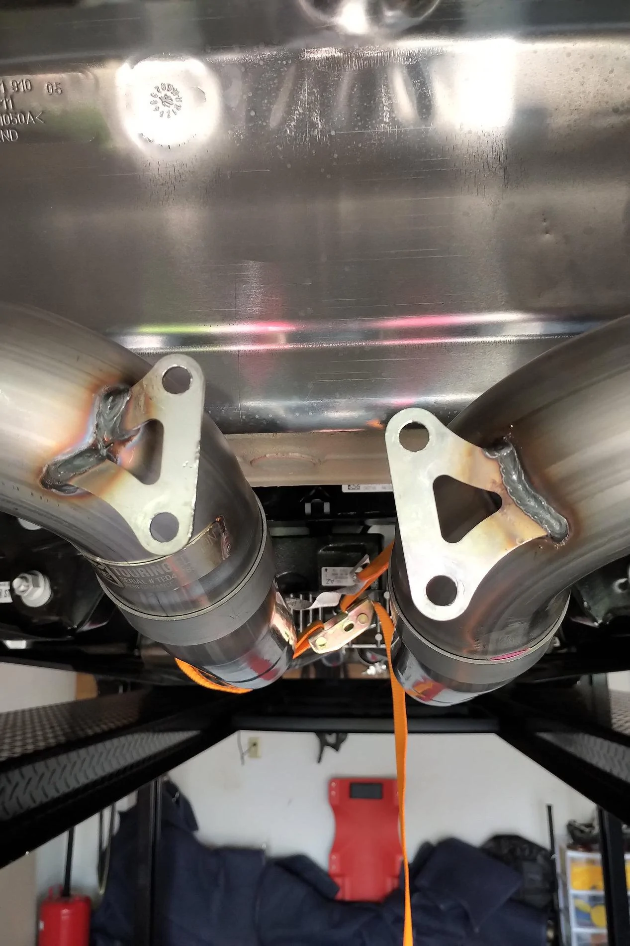

So without the plate, the driver side is extremely loose (hence the orange strap) and the passenger side has some movement ability. I can push it all into position but without the constant pressure joining the exhaust (IE this plate) it is hard to say if it will stick there or there will be sagging. I honestly suspect it will stick there and judging from the brothers video it will take a lot of adjustment. This join point of the exhaust will ultimately control how close or far apart the tips are, the rotation of the muffler pipe I suppose will determine how high into the bumper the tips sit but it is impossible to tell unless I jerryrig something

Your adjustment lies in the mid pipes. Clock them around and adjust the rear section to perfect alignment. I know you mentioned it, but please lend a few mins and fill out the support form to enable us proper documentation on our end.
You'll also get contacted directly by one of our engineers to assist ya quickly.

Push it all in position, then measure the distance between the holes. Go to a hardware store and have a plate cut and drilled.
What I would do, is cut a piece of cardboard, mark the holes and use it as a template.

Its not the midpipe, look at the bracket pictures, they can only “point” at each other one way, IE the muffler pipe can only line up one way. There is no play in those brackets nor the AWE plate. I think the pictures of the video version against the real version are pretty clear.

I filled out the massively long overkill support form (I better be getting some extra trump cash its like filing taxes). At present the tips pinch and hang about an inch too low (stock hangers). If this gets resolved I will be sure to recommend but at present, the fitment pictured in videos and marketing isnt exactly accurate. I hope it is just me, but the midpipes only twist so much (especially that one side has the hanger bar so you know that is going to need to be level) and I can force the tips out with a ghetto replacement plate. How to raise the entire system is also not exactly clear.
