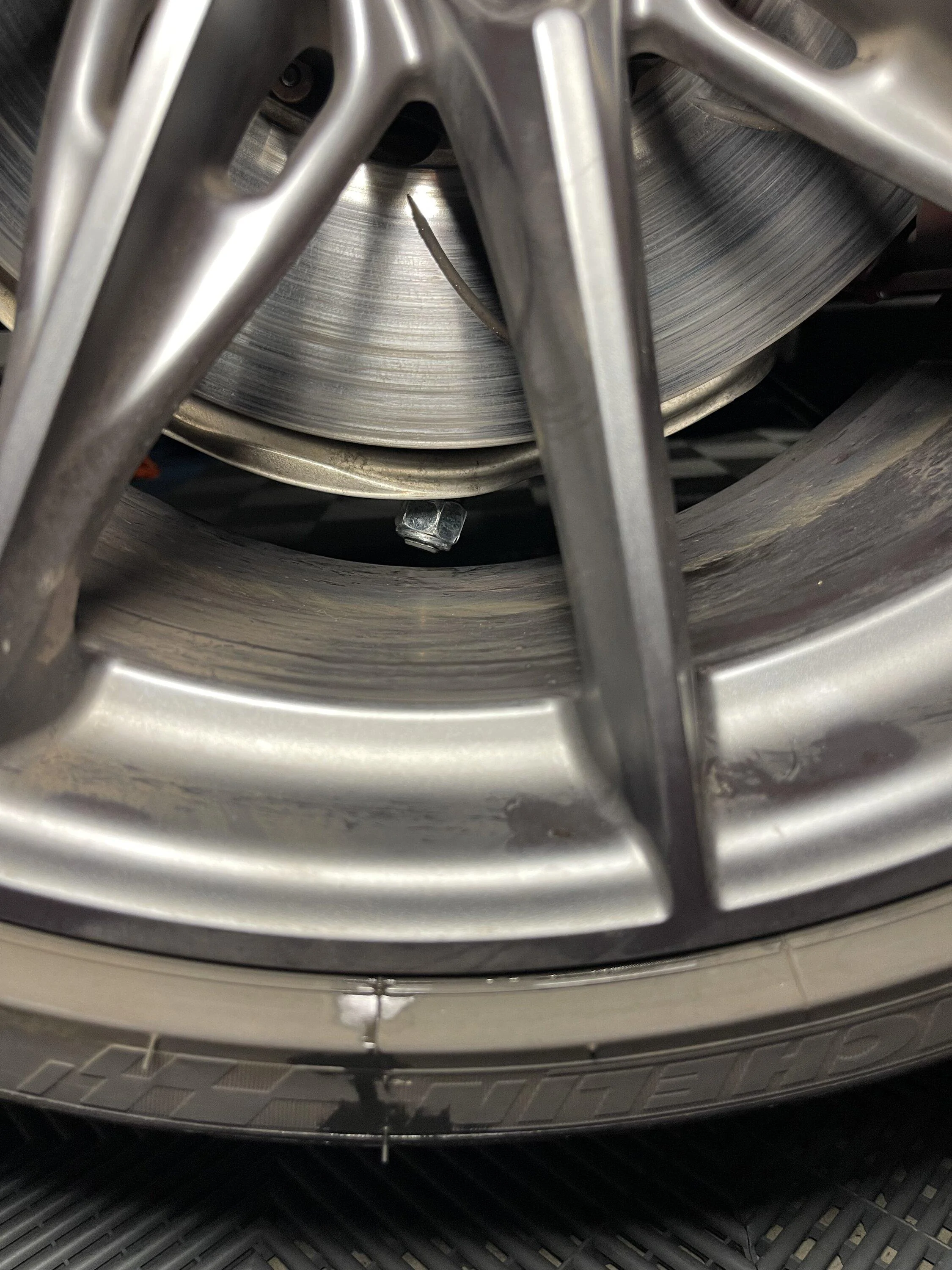

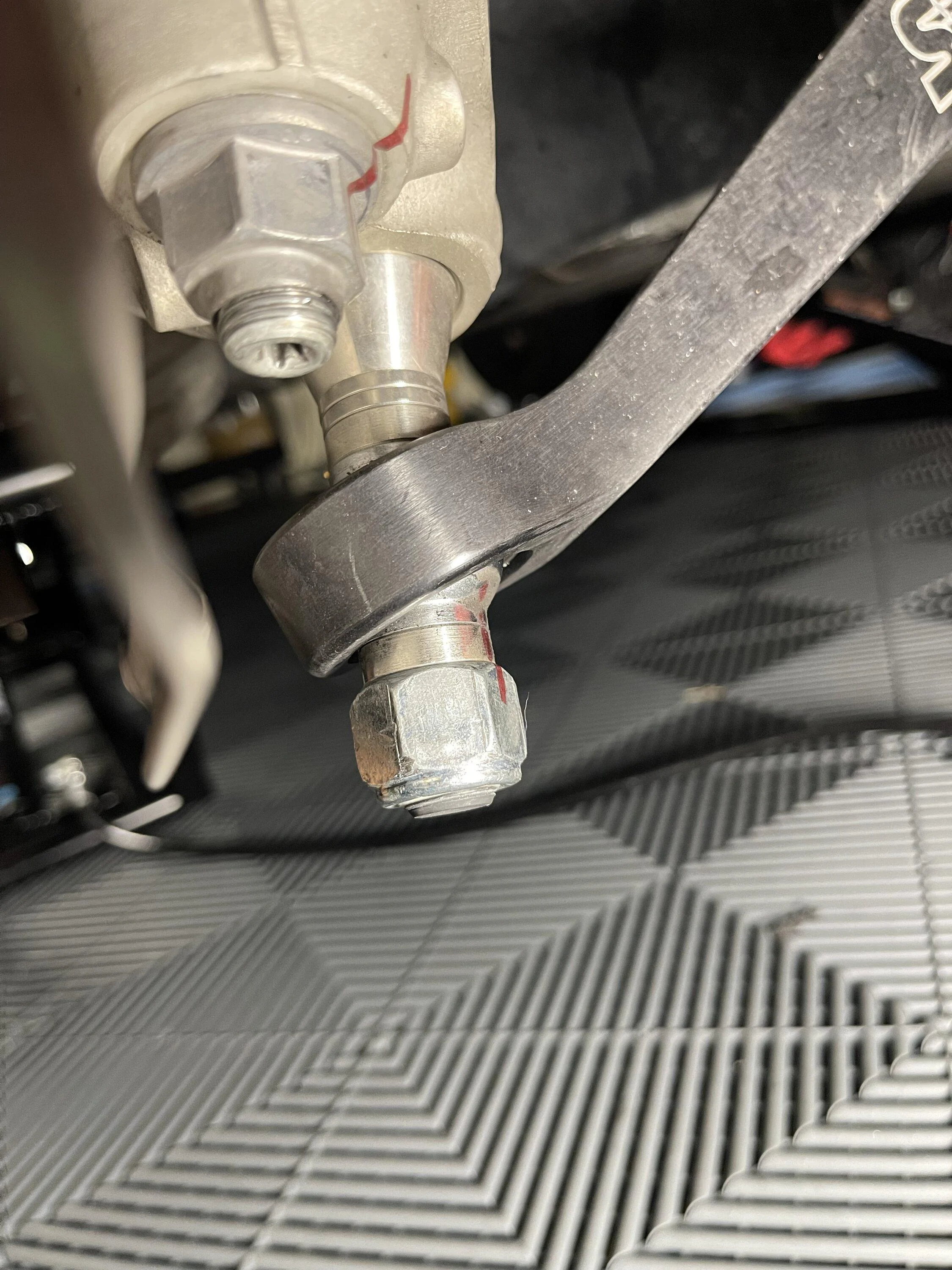

I just installed the SPL lower control arm but there seems to be a fitment issue. The ball joint bolt is sticking out too much that I’m not able to fit 18 inch wheels without contact. Has anyone had this happen before?
My OEM 19 inch wheel fits fine(attached).

I was kinda worried that might happen with their new bolt, it sticks down far more than the old one

I have been running spl arms for over 2 years and both bolts eventually broke right above ball joint. So I was probably one of the first to order replacements that I believe influenced the redesigned bolts as I talked to them directly. I am now on my second set of original bolts and have been waiting for the new design for 6 months. I just re-connected with them and they confirmed they have two lengths of bolts. So anyone running 18 “ wheels they have them sized to fit. They advised to call them and they can get the right length for your set up.
