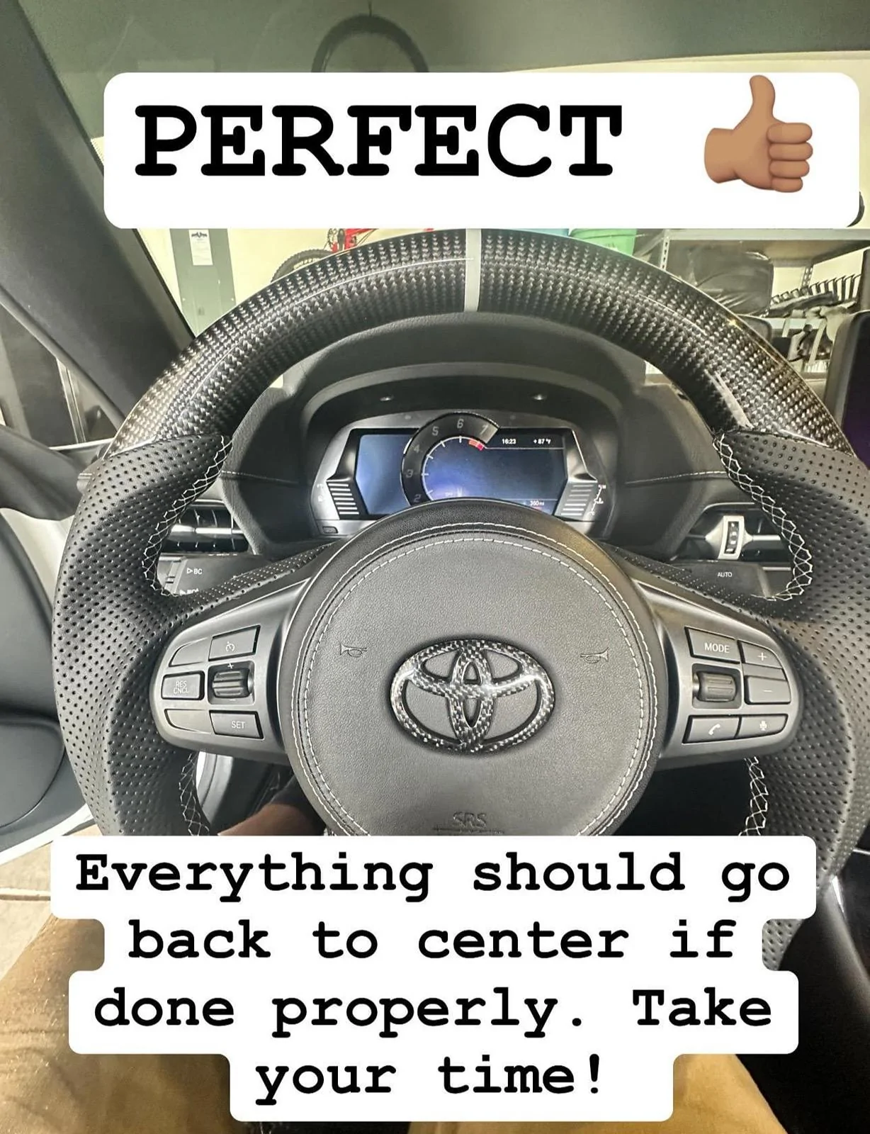

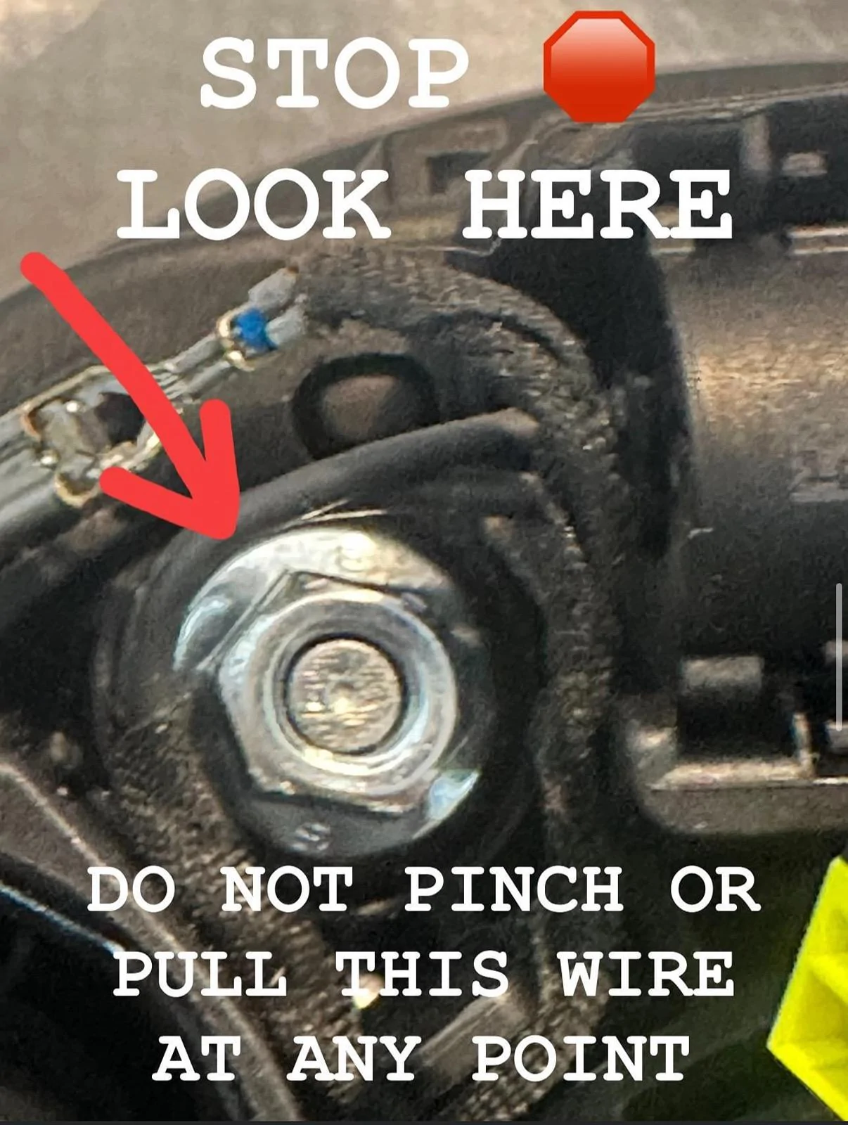

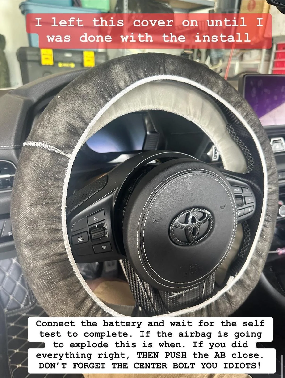

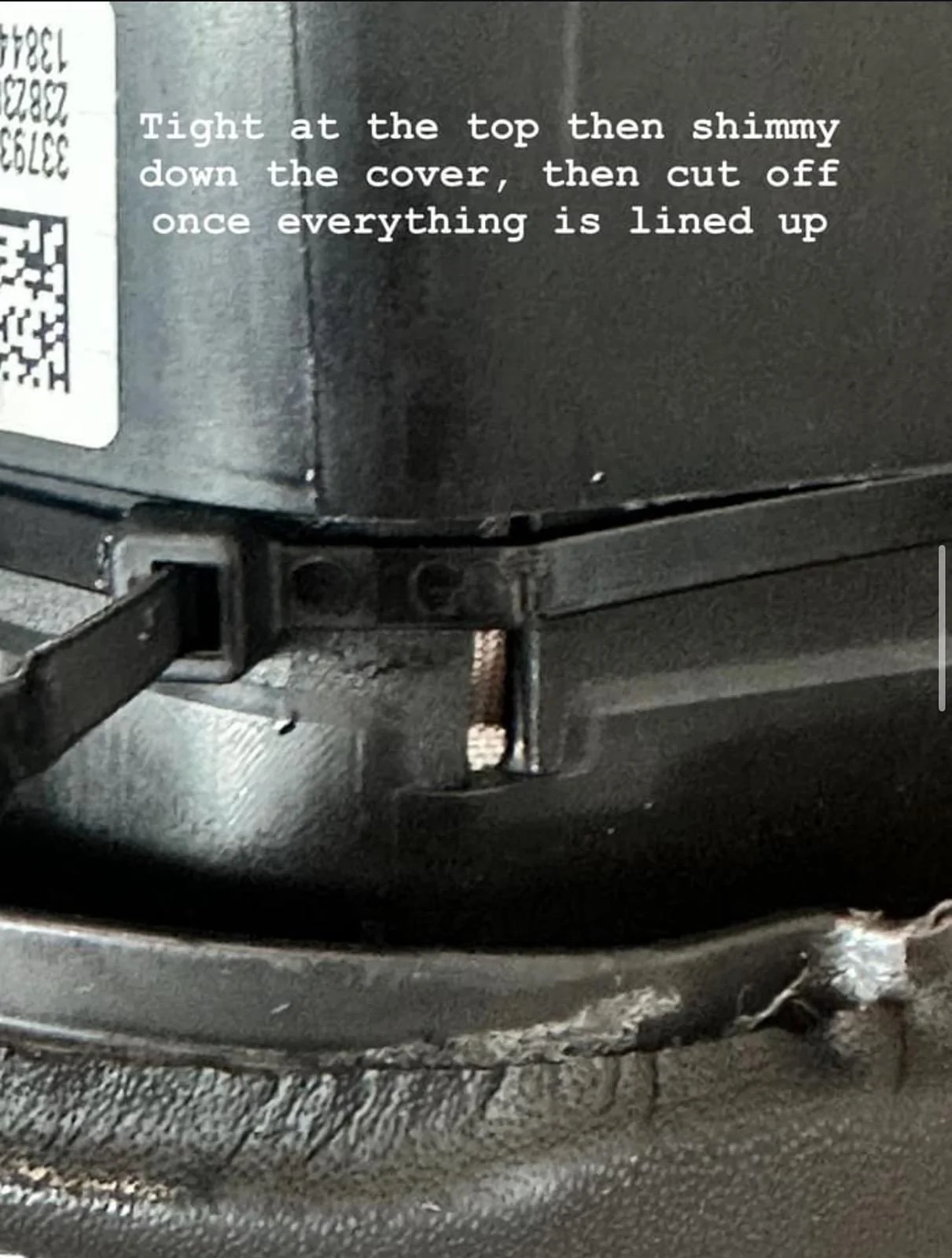

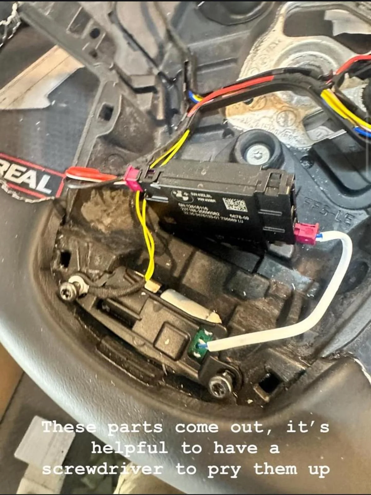

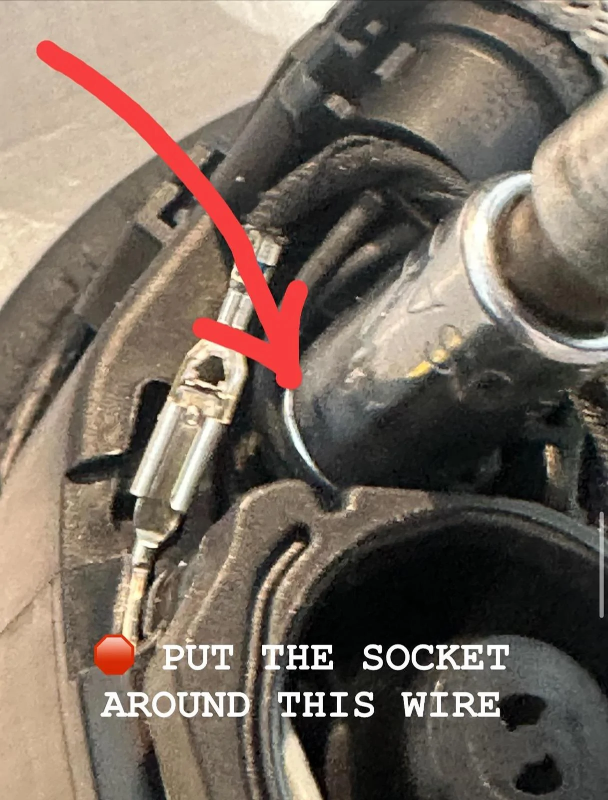

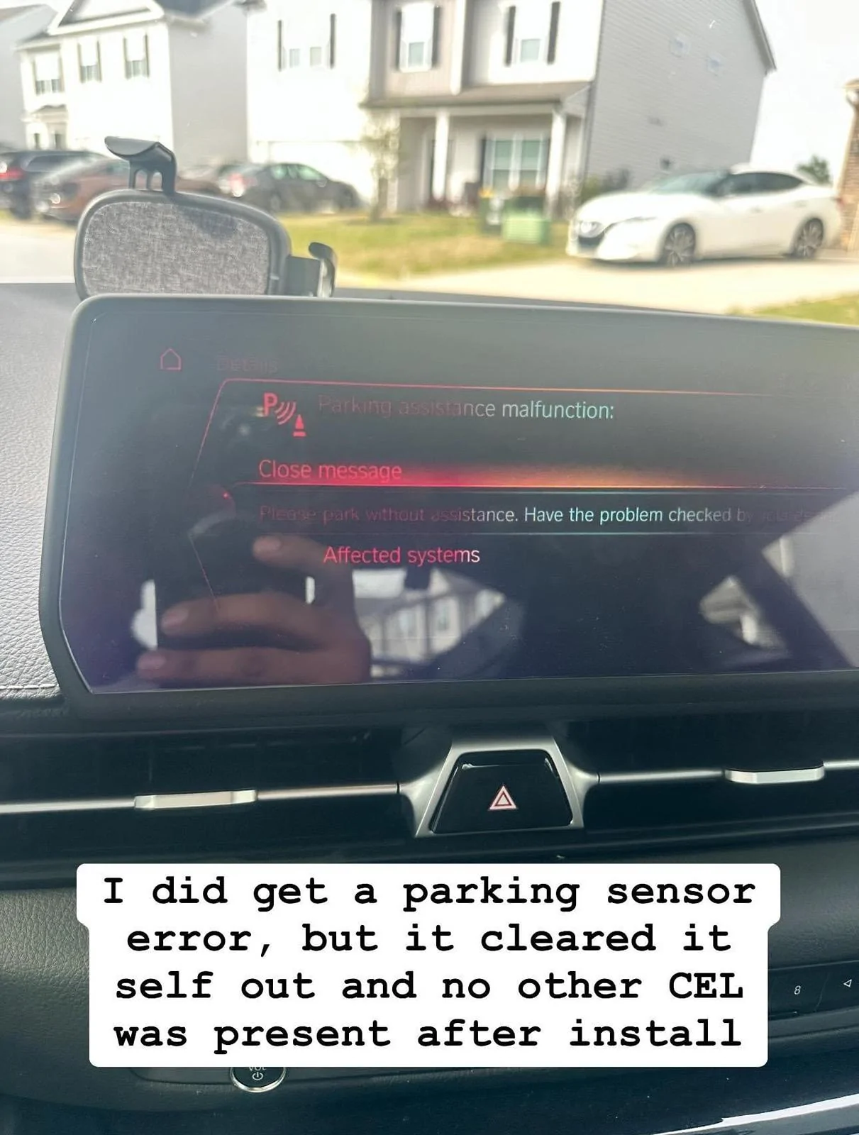

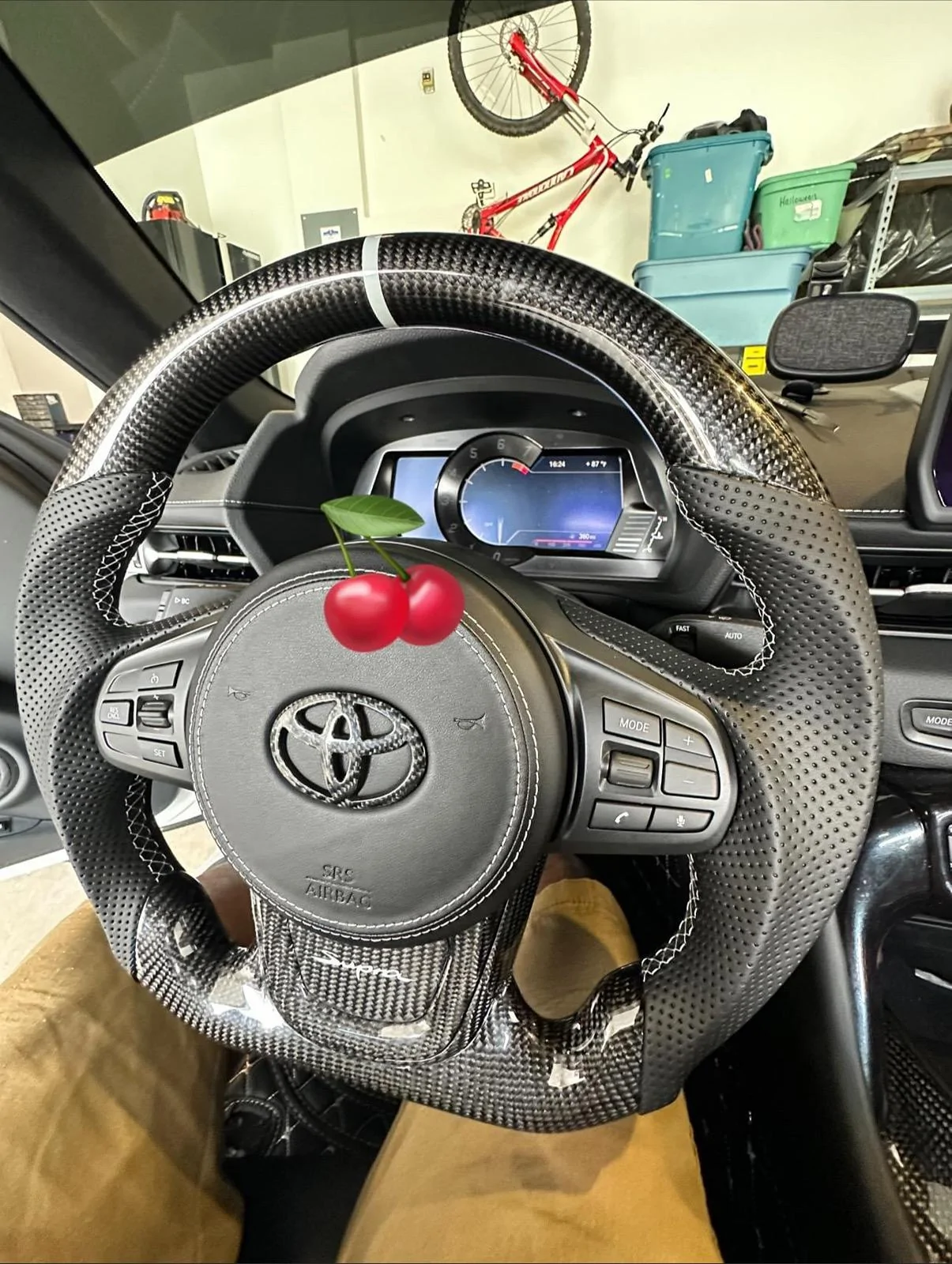

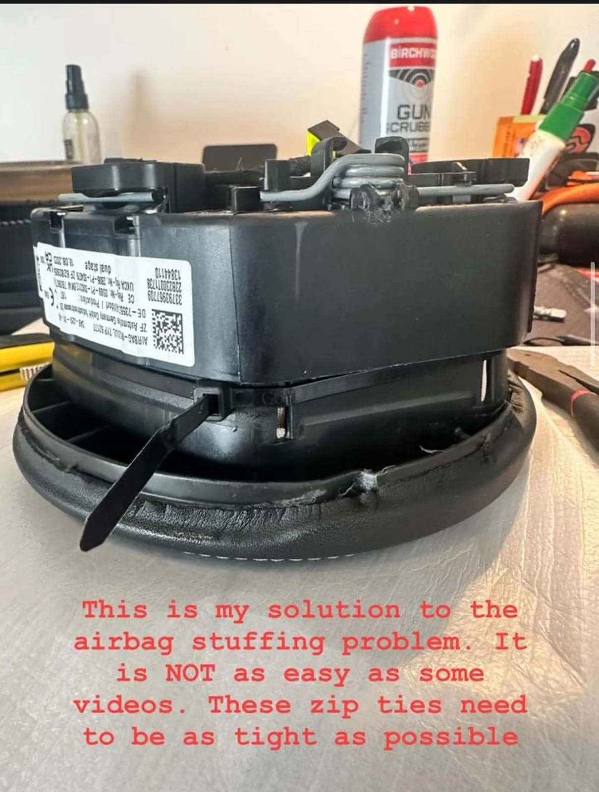

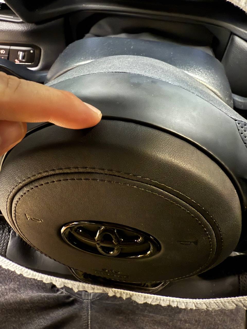

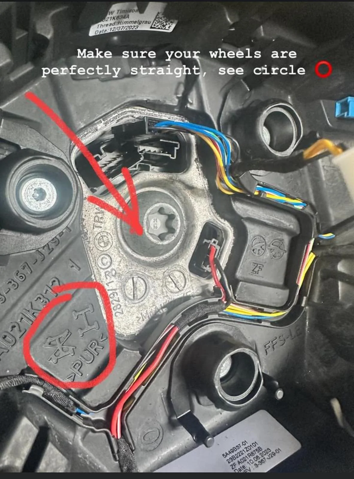

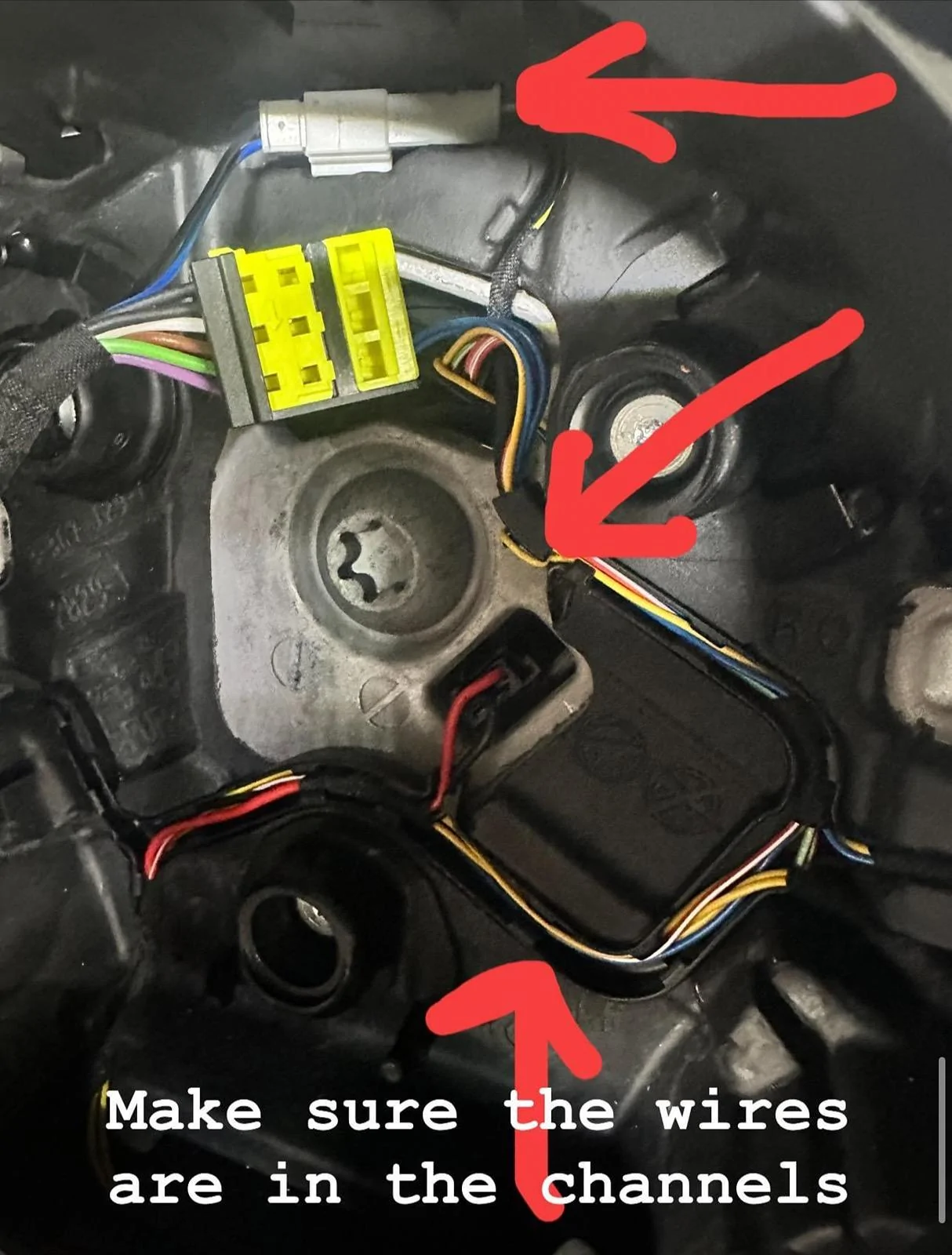

The details here ARE NOT MENTIONED in the videos.
If you are thinking of swapping out the steering wheel and airbag you need to watch these videos and read THIS post carefully. I was going to make a YouTube video but with my unfortunate demonitization, I’m not inclined to make any more new content. However it is where my source videos reside, so I’ll link them here.
Watch the entire videos first…. Then start your install.
NOTE: ONLY REMOVE THE NEGATIVE BATTERY TERMINAL.
KEYWORD: Steering Wheel, Airbag, Air Bag, Carbon Fiber

Two days too late 😭 I wish I thought of the zip tie idea when I tried to transfer the airbag into the new steering wheel compartment. That’s a brilliant idea. Thanks for the tips
