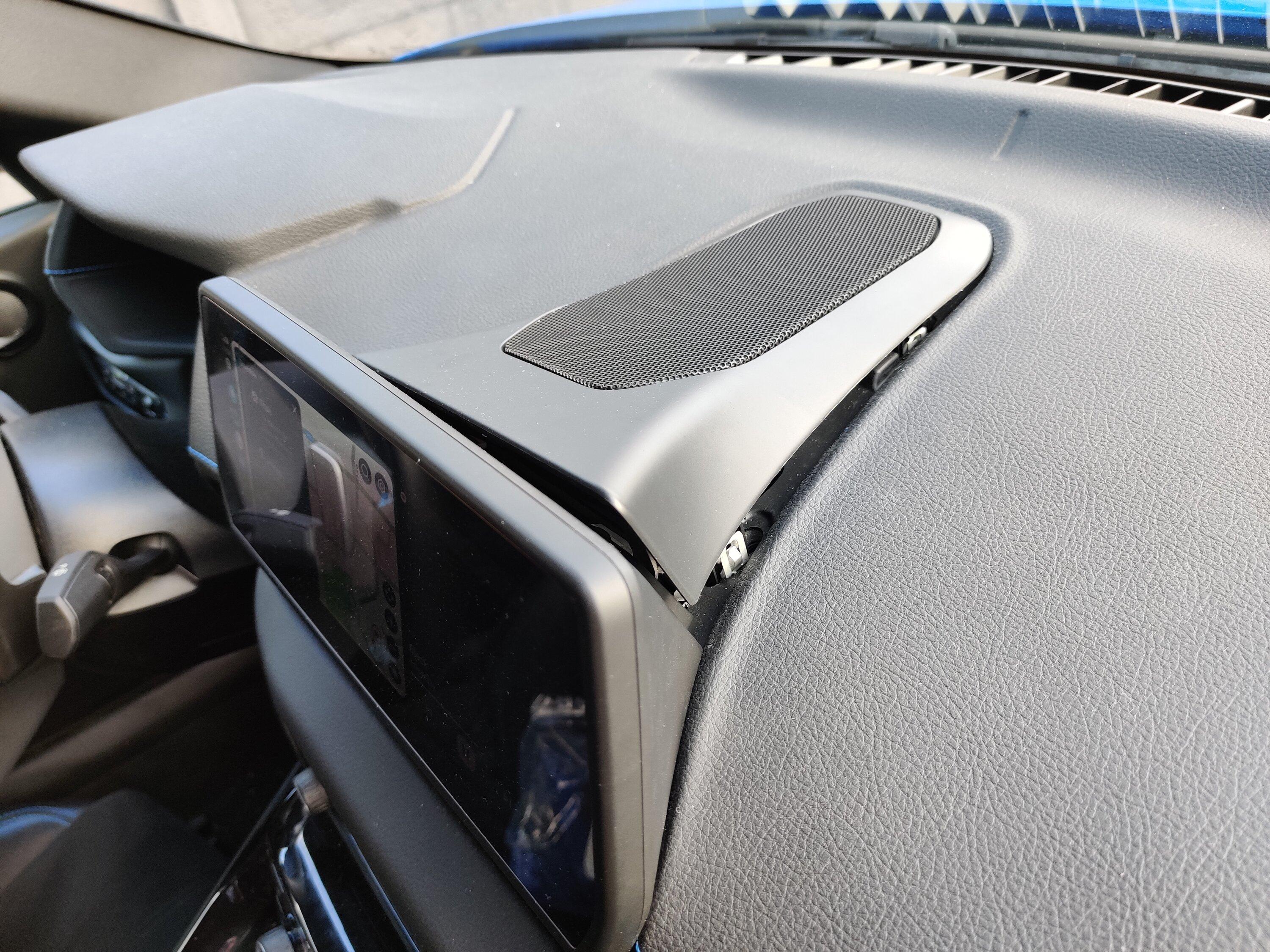

Today I fixed an annoying creaking and rattling sound coming from near my infotainment screen.
This guide on how to fix the annoying sound can be, diagnosed as caused by 2 parts: The infotainment screen and the metal parts used in the plastic speaker grill.

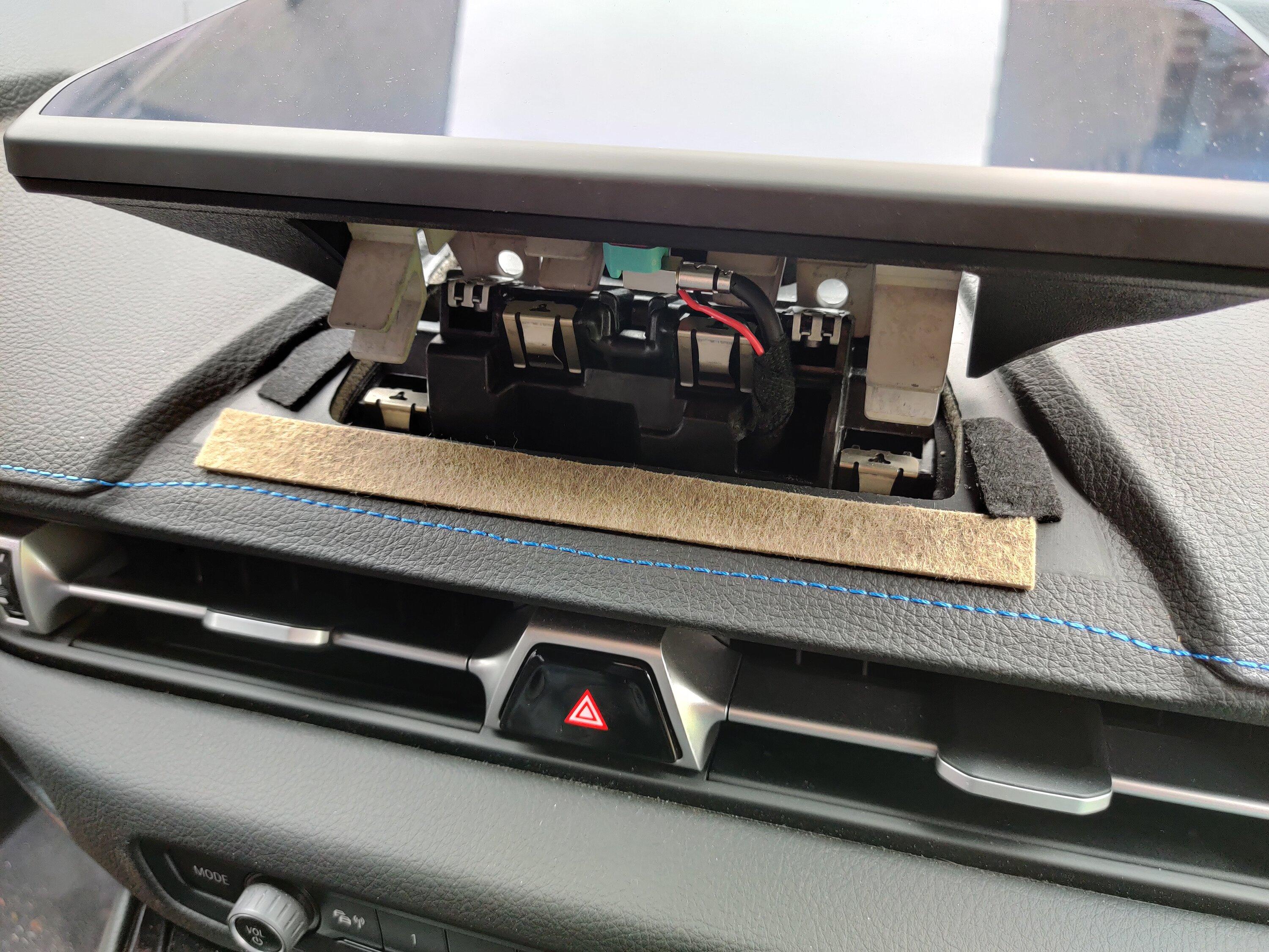

1. Gently pry open the plastic speaker trim behind the display. Some leverage/force might be needed to get the first push pin pulled out. I noticed it was easier to pry it open from any corner closest to the infotainment screen. I pried open 1 side after which I went to the other side.
Important: Pry it open from both sides and don't just tug it off from one side, as that might break clips/hooks.

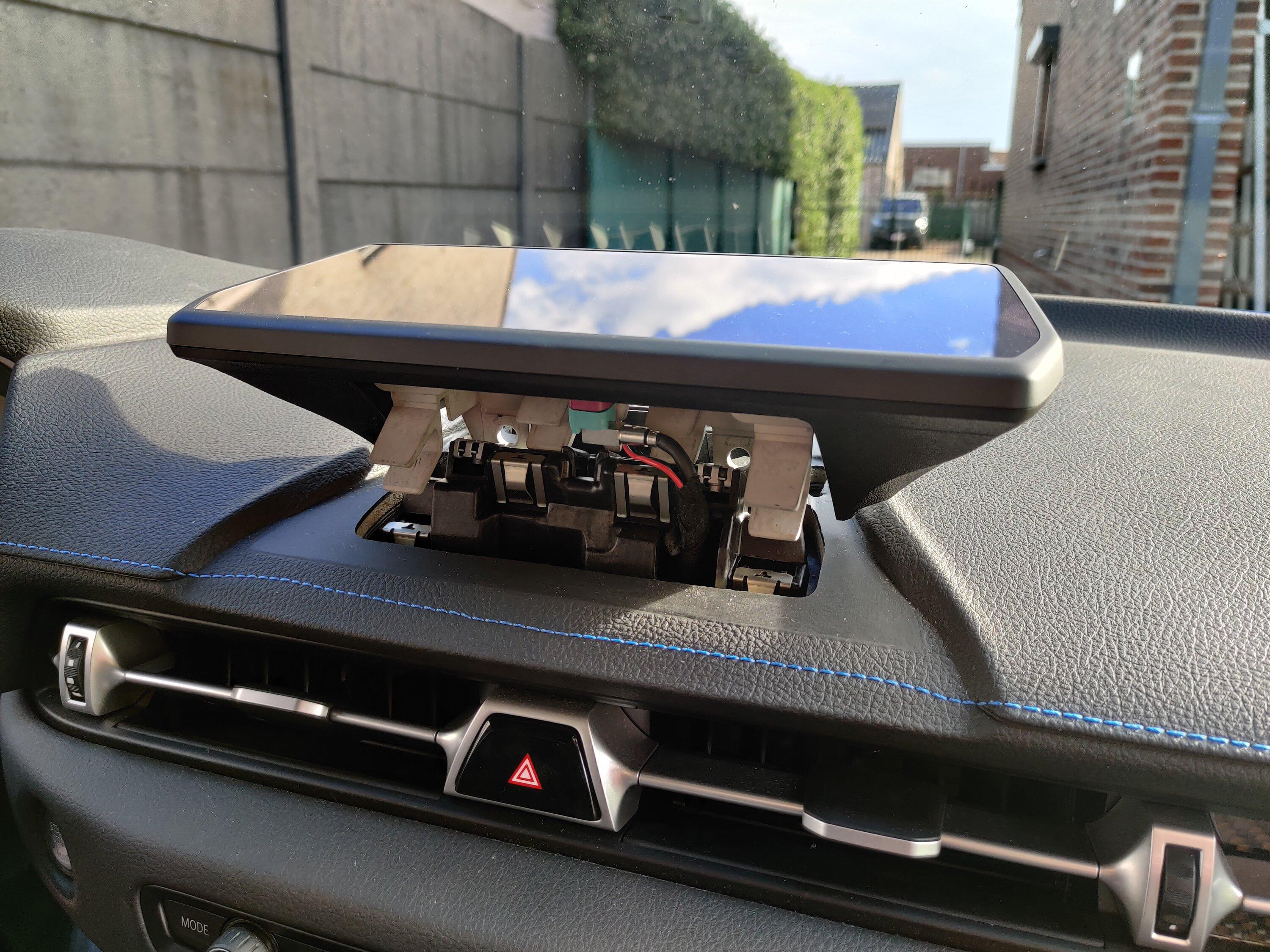

2. Remove the 2 torx T20 bolts from behind the infotainment screen
3. Pull up the infotainment screen and gently fold it back. There should be enough margin of freedom to have the screen gently rest on the metal parts behind.
4. Tape your velvet tape in the same spots I placed it. Doesn't have to match exact.
Please note: On the picture there are 2 colors of velvet tape. At first I used a brown one because I thought it was invisible, but black is recommended as it might be a tiny bit visible on the sides, hence you see 2 black velvet tapes on the picture.
5. Place the infotainment screen back into the guiding slots and screw the T20 bolts back into place. Screw in the T20 bolts tight. Do not over tighten! I used a screwdriver but a ratchet might easily over tighten them. Use common sense
6. Important: Drive around without speaker grill attached.
Look for roads that are not that well maintained. Near my place there was a road with paver stones. Hopefully the rattle has been fixed. If you still hear it. It is likely something else that this guide does not mention. You might start hearing a rattle again IF you reinstall the plastic speaker grill now. That is why there is a part 2 of this guide. Follow it to have a bigger chance of stopping rattles after re-installation.

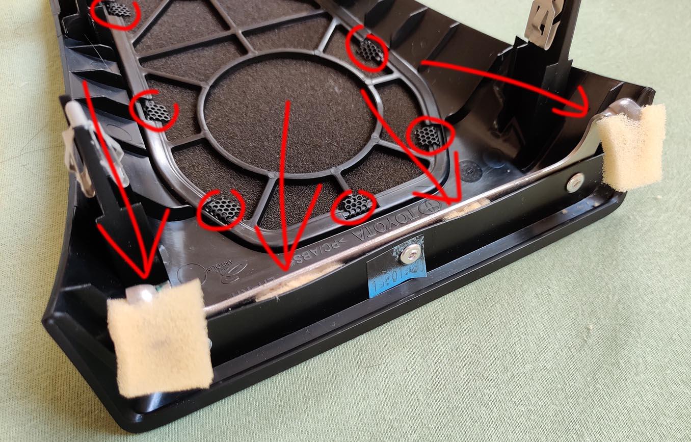

1. Inspect the speaker grill assembly and check out if you notice the same creaking/rattling as shown in the showcase video above.
2. Pry the metal plate with the 2 hooks open and jam some foam into the center of both halves. Make sure the foam is not too thick as it might crack the plastic near the pop rivets.
3. Make an incision in your foam and put the foam, as a sort of sock, over the metal hooks. Make sure there is enough foam to wrap around the hook.
4. Verify that all tiny speaker grill tabs are pushed into the factory speaker foam. Your speaker grill should look a bit like this now:
5. Install the speaker grill again. Make sure you place the hooks with foam, at an angle, under the display first. Then press it into the dashboard clips again.
Enjoy your silent infotainment screen. Pure bliss
