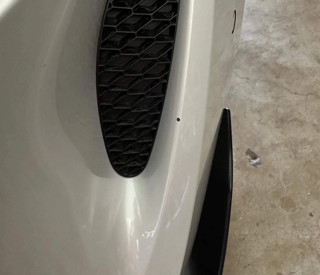

There are a few small rock chips on the front bumper I want to try and cover up. I have looked at getting the front bumper fully repainted but the local shops are charging about $600ish. I plan to eventually go that route (and get PPF) but for right now I just want to cover them up as best I can.
I have read on the forums that the paint from the dealership isn't that great, so was wondering what other options are out there that have done the job for you?

I have absolute zero as well. I havenā€™t yet purchased this but in the past I have always used these types of touch up paint with the separate clear coat. If youā€™re not afraid of doing a little wet sanding you can get great results. Traditional single stage touch up paint never fills in right and thatā€™s why it looks bad. With this, you get a super thin layer of paint, then let the clear coat fill in the chip or scratch and then sand/polish smooth. I would give this a shot bc you might do well enough to avoid the full respray.
ScratchesHappen Exact-Match Touch Up Paint Kit Compatible with Toyota Absolute Zero Tricoat (D01) - Bottle, Essential https://a.co/d/cJM1NVb
Again, I havenā€™t actually used this particular product it was just the first one that came up
