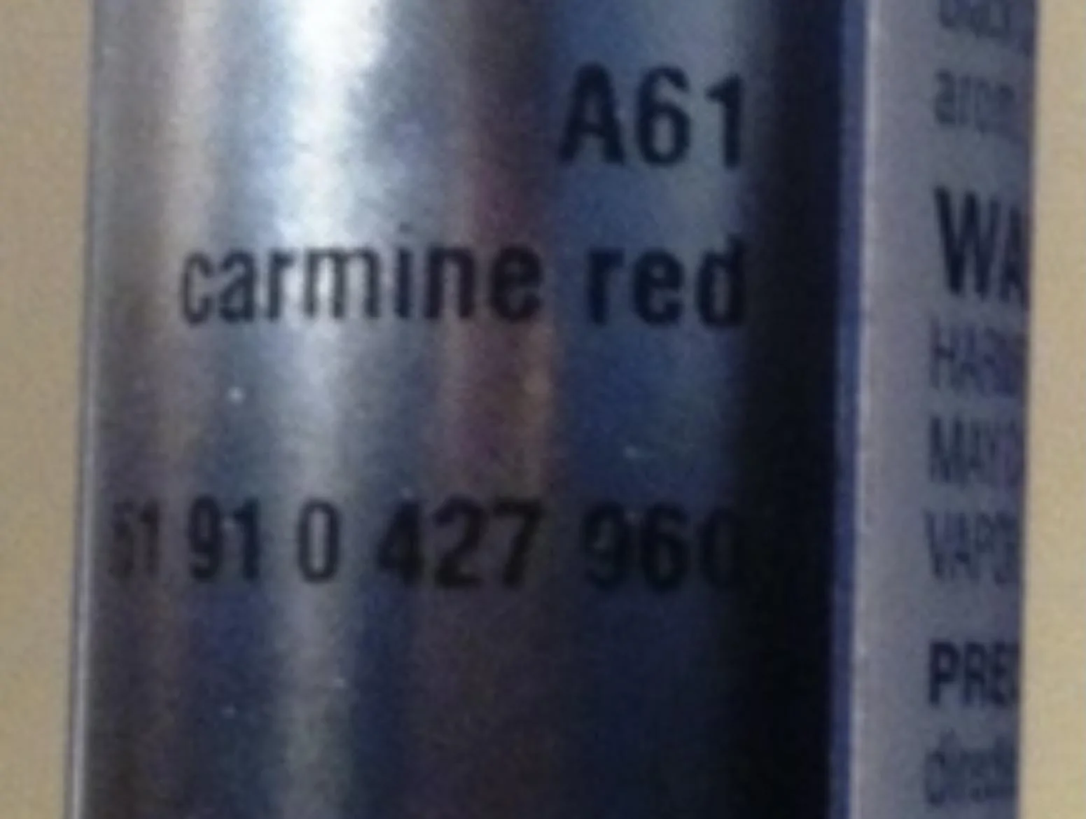

Thanks for posting this. When I used the part number at the bmw parts counter, they referred to it as Carmine Red and I ran across these pics on a BMW website confirming the name matches the part number mentioned in the earlier post.
I wound up ordering it since it was $33 through the BMW website and the parts counter wanted to charge me $75.

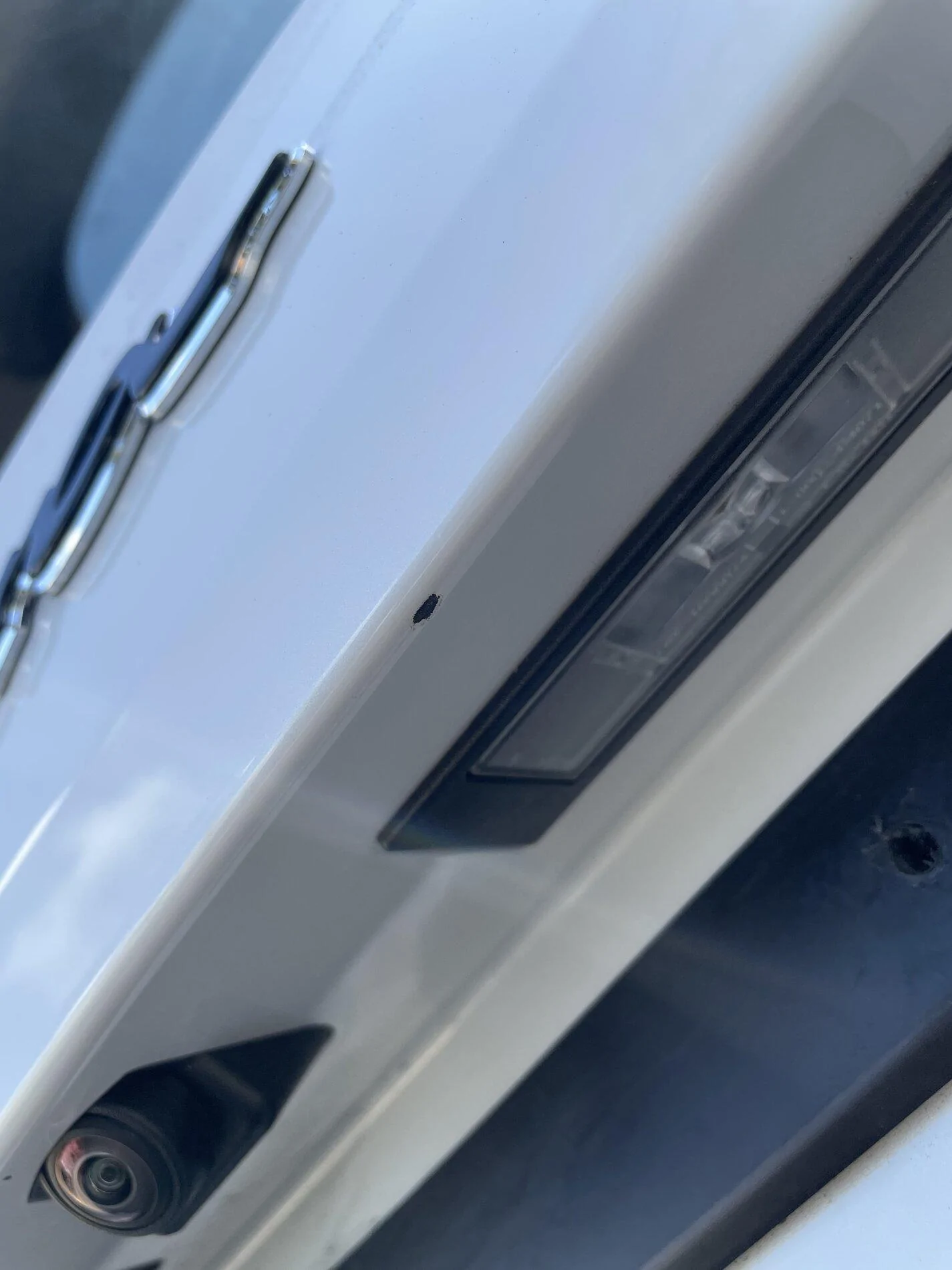

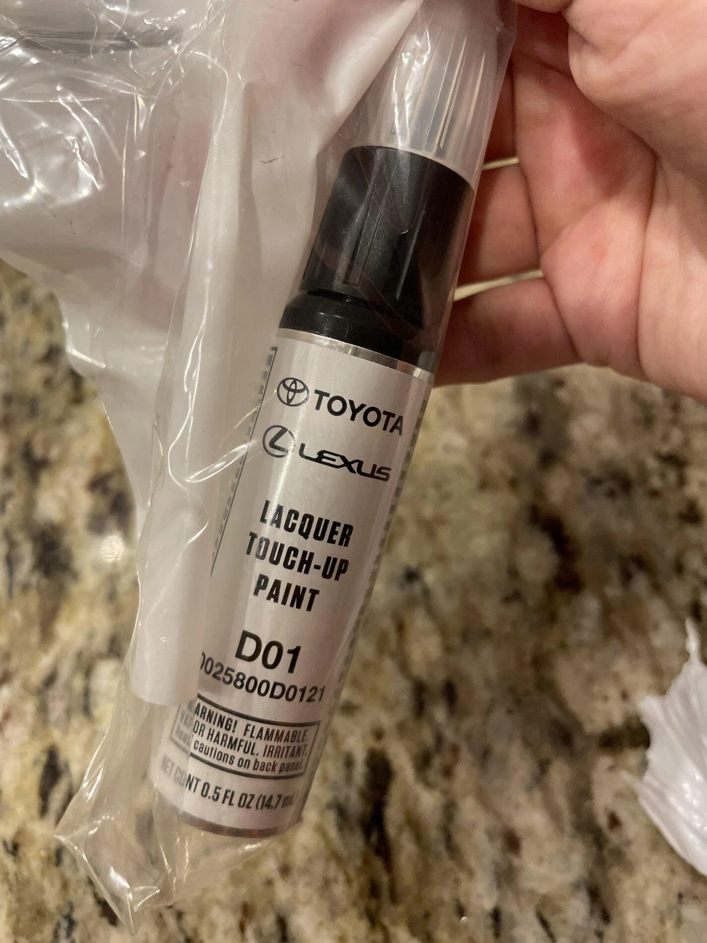

Hey guys, was just wondering if I have the right touch up paint for my Absolute Zero White 21 Toyota Supra.
