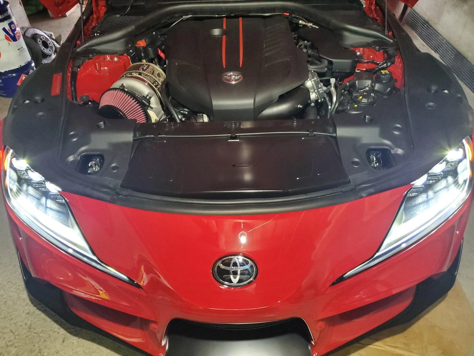

As some may have already seen on our social media accounts on IG or Facebook. We are set receive our 2020 A90 Supra Launch Edition. Dealer is telling me we should be taking delivery within a couple now.
This thread will serve as a build and dev thread for our Supra once we have it.
We didnt really ask for a choice in color, just wanted the very first arrival so we have a red with black interior.
It will basically be an R&D car for parts design and etc. Track and dyno time will be about the only real use for it outside some car events.
6thNo time frame right now, but will wind up being an all out build similar to our Mazda shop car. whereas the body would probably be the least modified externally. But things wil be moving fairly fast, as we already have some key parts in prototype mode right now. Should be fun. Feel free to ask questions or anything if interested.
Pic of what ours should look like at delivery:
What do you all wish to see made for this new platform? Feel free to Post your ideas.

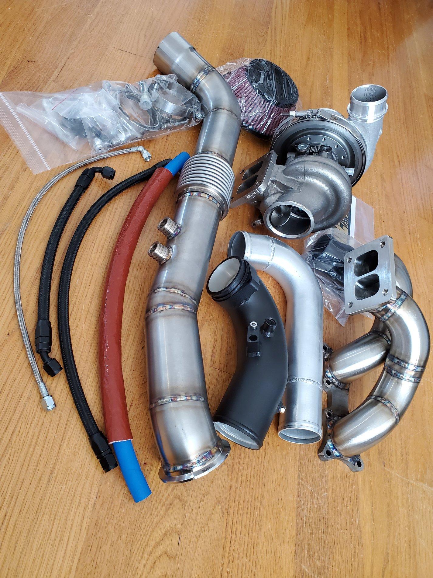

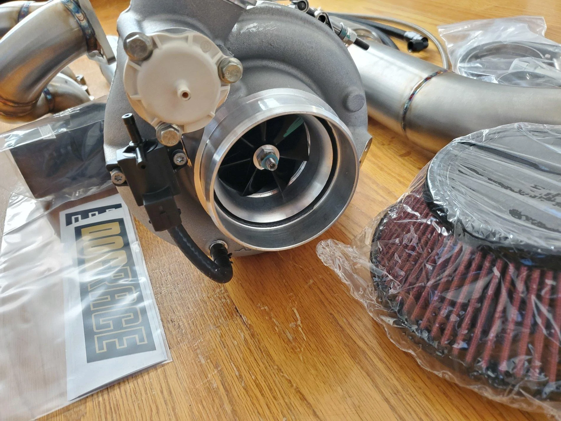

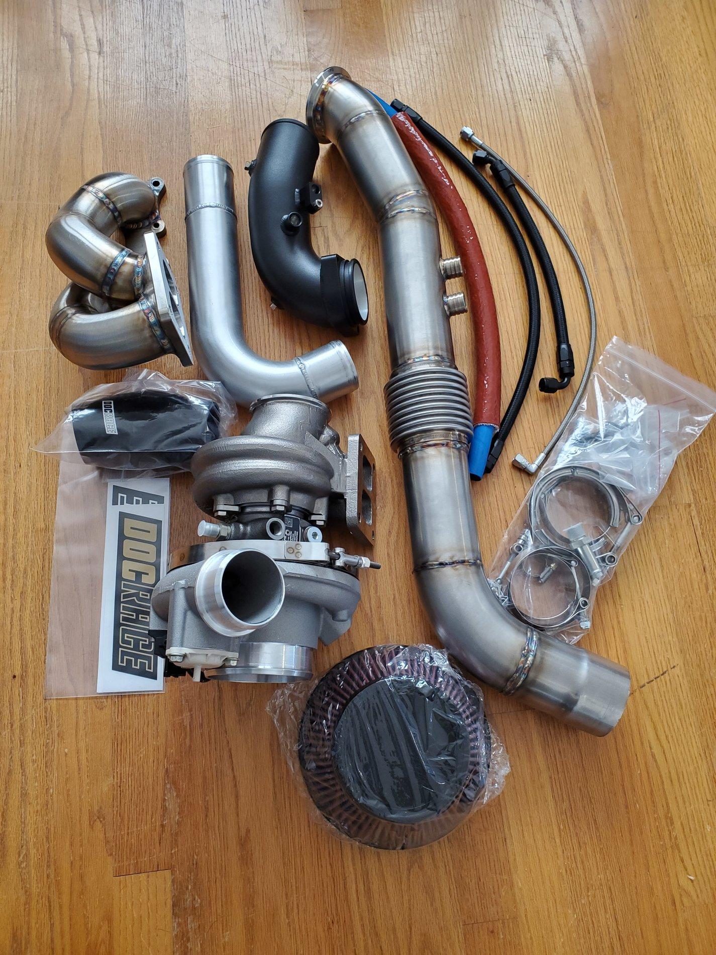

Going in this week. Goal is 850whp on the stock engine
Docrace kit with Borg Warner EFR9280

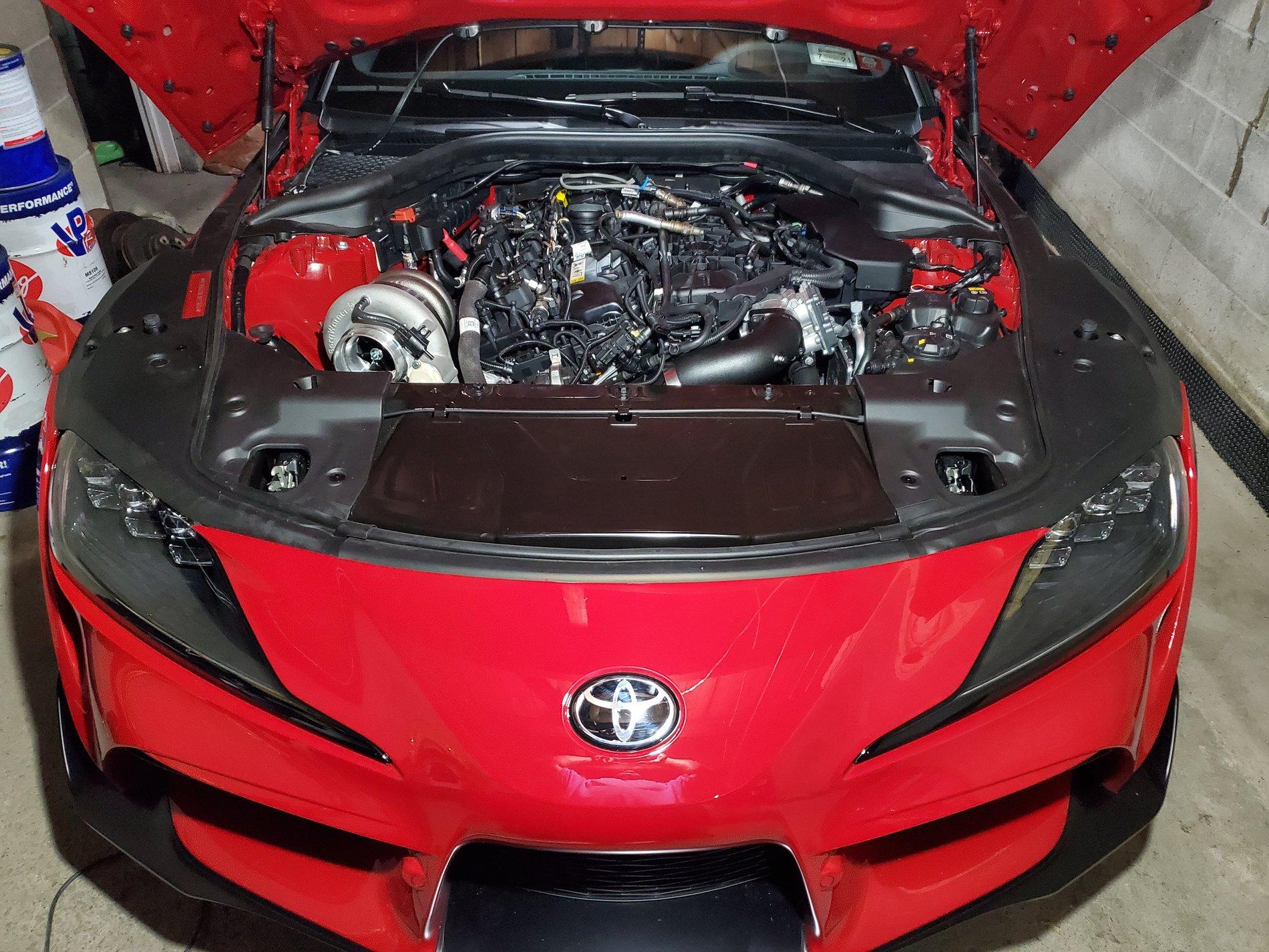

EFR9280 installed. Were in the middle of a snow storm here in the northeast so havent been able get her on the dyno just yet. Little started snowing as we finished the install. so dyno soon when we catch a break in the weather.
Short vid of some revs
