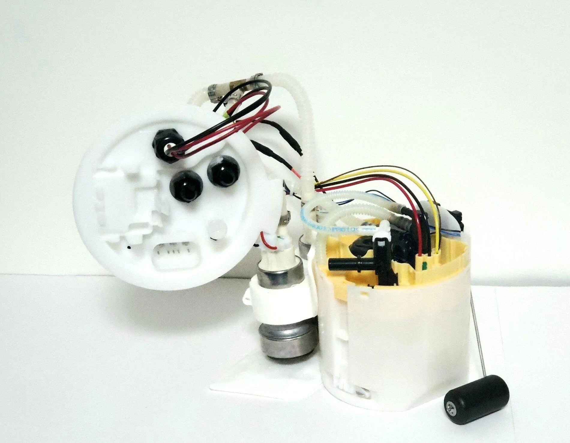

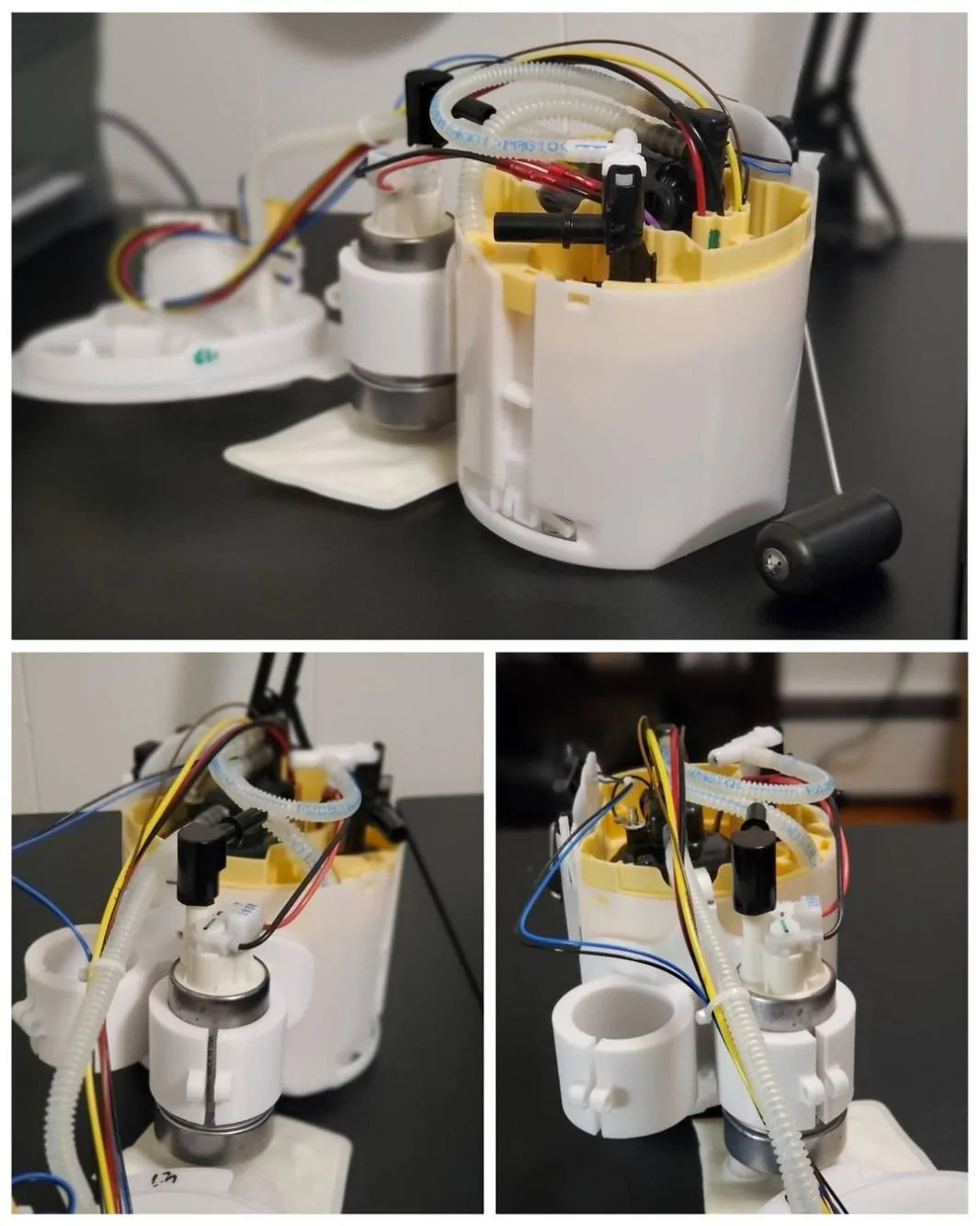

Since we have had several people ask, I Figure we'd give everyone a sneek preview of our upcoming Twisted Tuning CANBUS controlled LPFP fuel pump upgrade for the A90 Supra.
Stage 1 adds a single TI Automotive Hi-flow fuel pump to supplement the fuel feed with the OEM bucketeted pump. This configuration will flow enough fuel for 1000hp. Stage 2 adds a second pump in addition to the first TI automotive pump to then push fueling capabilities to 1300+hp. Upgraded feed lines will be offered to truly maximize fueling.
As always we try to release product that can grow with your goals. Best of all. This setup will be controlled via CANBUS for seemless integration and less chance of Hobb switch failures which most people are used to.
Stay tuned for updates on the ultimate LPFP solution for your MKV Supra!!!

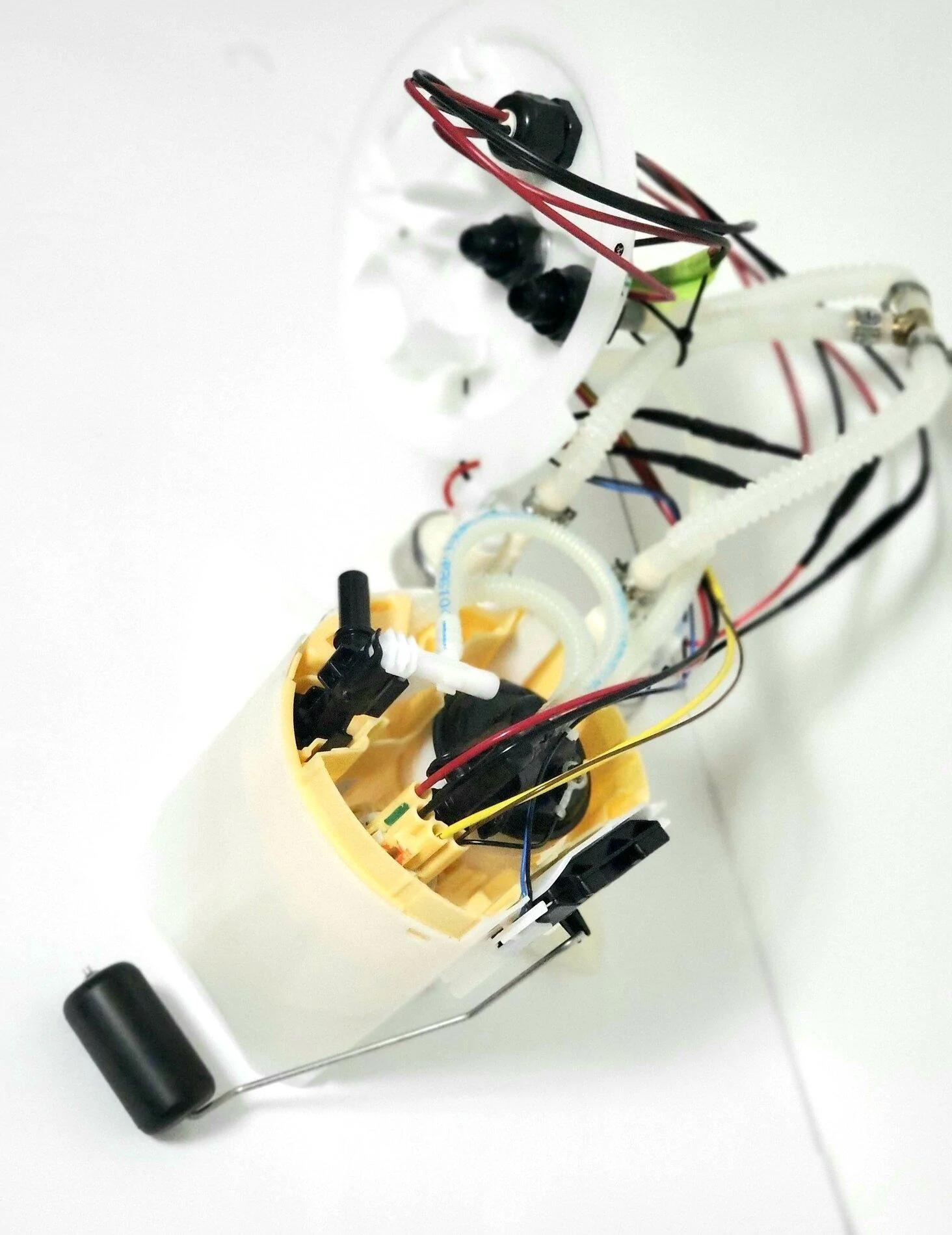

updated photo of our stage 3 LPFP with provisions for a return line.
