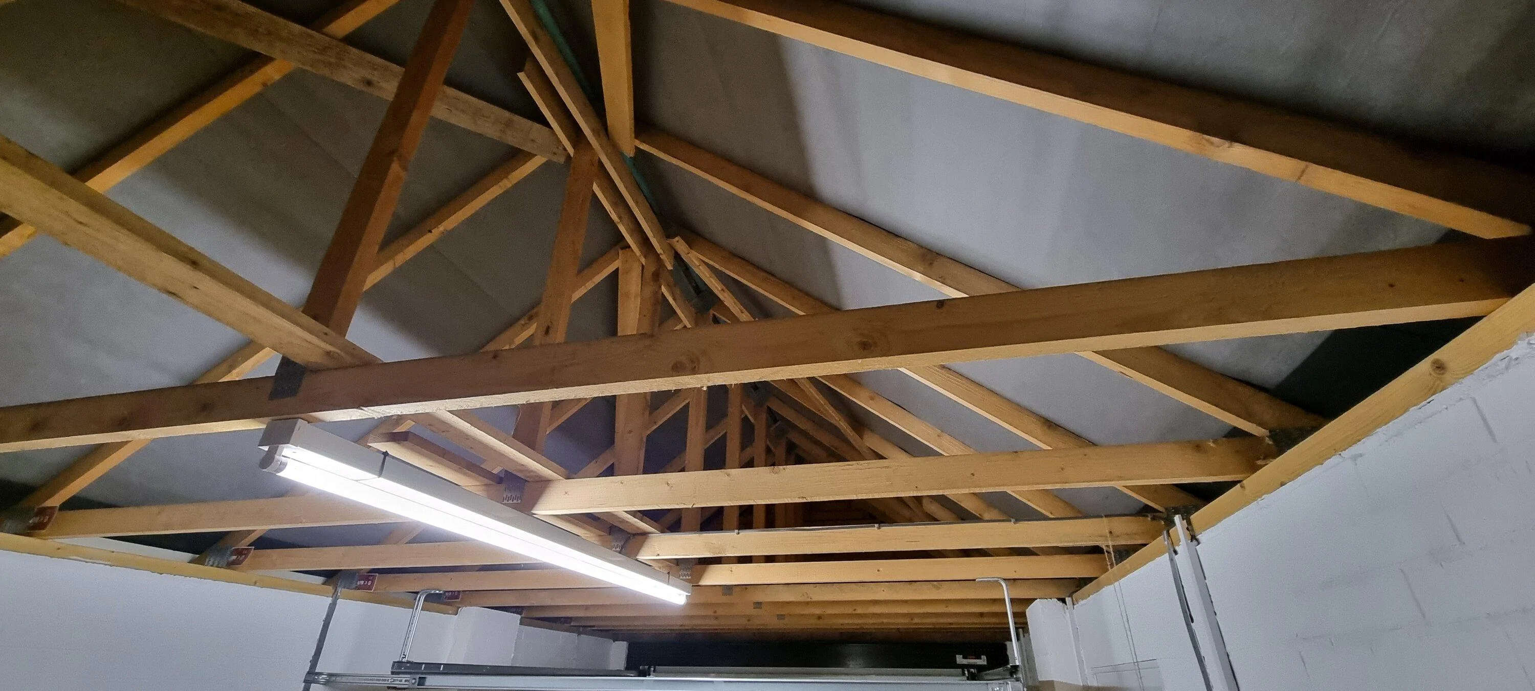

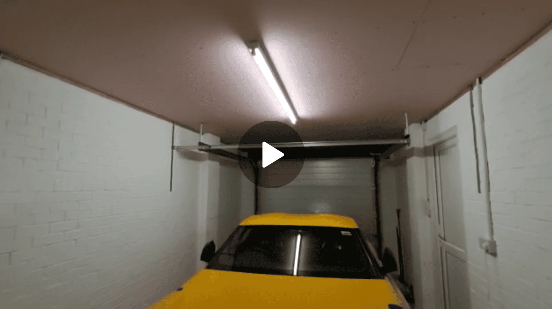

Here's my update with the pros and cons, sorry to anyone not in UK but all prices will be in £.
I spent £240 on an extractor fan, that works well and is on 24/7 with a humidistat.
I spent £800 and had fire retardant plasterboard installed on the joists and then 2 layers of thick insulation on on top.
So for now I'm about £1050 into it and I can say generally speaking it's worth it for some things and not for others:
Keeping garage warmer: with no heating unit it is already much warmer, no drafts, but would still require a small heater next to be comfy.
Humidity:
Generally it has reduced the rh% slightly but the main difference is:
The dehumidifier now has less volume of air to dry thanks to plasterboarding so when it's on it works better and can reach 75%/70%.
It also now feels more like a room and no longer a garage so looks and feels much nicer in there and less spiders (lol).
I need some time to skim/fill and paint it white and ultimately it will then look pretty sick almost like a studio. The final touch would be some cool led lights!
So to summarise generally I think they key for me has been to keep RH low INSIDE the car with lots of dehumidifiers and a small desk fan to move air, and also coating everything in GTechniq Smart Fabric AB v2 or v3, and keeping everything dry and clean, I also replaced mats with custom rubber mats - the rh inside the car with everything closed is always around 50%.
If anyone has any questions let me know as I basically tested everything now and poured quite a bit of cash for this experiment.
One last thing is, my new build home like most in UK is poorly finished, so I noticed some damp coming through the lower bricks mortar, that's another job I need to do as soon as it stops freezing to repoint some mortar.
I attached a before and after photos to this post.
Finally to those saying I'm overthinking it, generally speaking for common folk I understand it looks that way, because that's how I am and I like things to be pristine, this is a special Sunday drive car not a daily and unlike most men who change car every 1-2 years this is something I want to keep.

To anyone interested:
Thought I would share here after several months and a few thousand quid of work spent:
Overall I feel I partially wasted money, spent 2k on the insulated garage door (it is very good) and 1k on insulating the roof and boarding it).
It does help humidity a tiny bit but because the walls are single brick and uninsulated all the cold and damp still comes in. It makes it feel more like a room and reduces dust on the car...
So now I need to keep running dehumidifier which is expensive (dessicant heater) and airing out the garage frequently...
However, the silica gel bags inside the car (I have 3 x 1 kg ones) are amazing, and humidity in the car is around 45% even when the garage is 80%.
In summary: if anyone has a detached garage and wants to make it warm and less humid and keep the car in there nice and dry inside and out, you either go all the way and spend big money to get it fully covered, or probably best not do it all...
