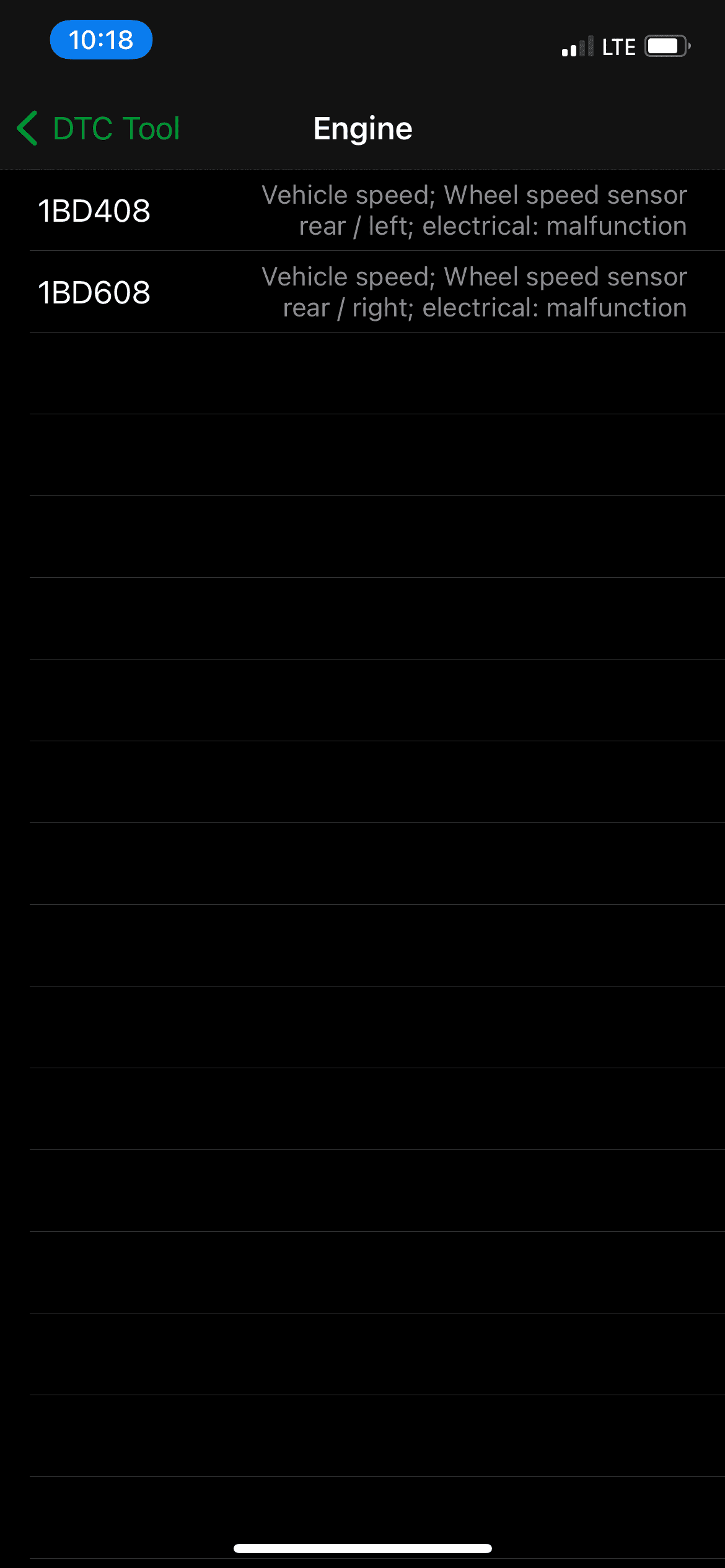

I think this is my current problem. I got a handful of codes after I replaced my axles. Clear all except two with ecutek.
Car is in limp mode.
If this is the solution, does anyone have part numbers to replace both rears?

Basically the same as fronts .... front = 89516-WAA03, rear = 89516-WAA04
Awesome!!
They look like a major PITA to change. At least Iā€™m on the right track now

How difficult was it changing your wheel speed sensor? My rear left goes out intermittently
It was incredibly easy. One bolt like razorlab highlighted above. With the tire off it was a two minute job.
