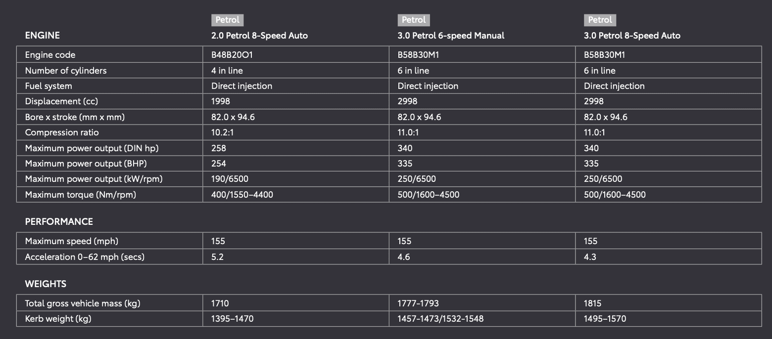

I was curious so I took a look at the MY23 Australian Spec sheet and I think you are right. The published weights are really just approximations. On Australian cars there should be a weight discrepancy between the GT and GTS specs due to different wheels as well as a few other minor spec changes.
Looks like standard marketing bullshit to be honest.

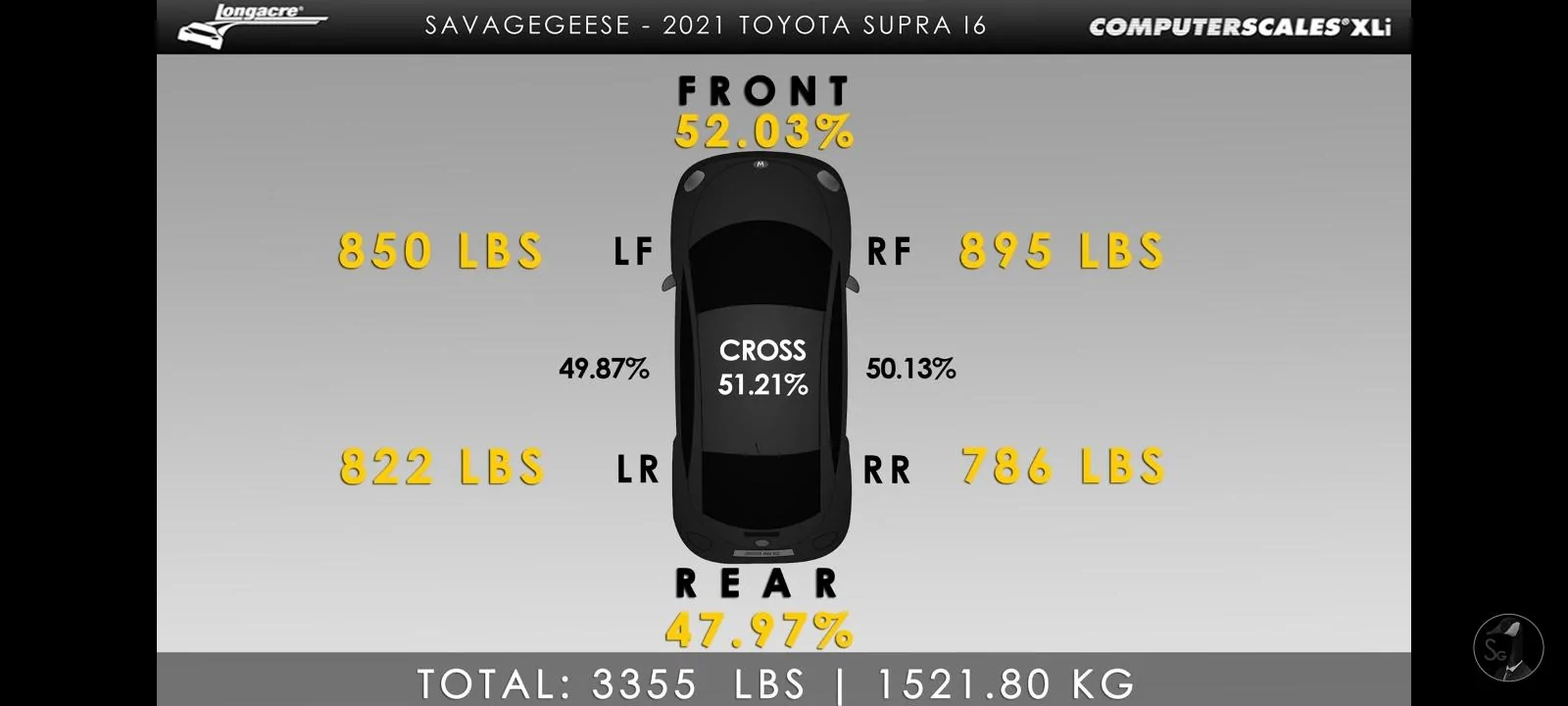

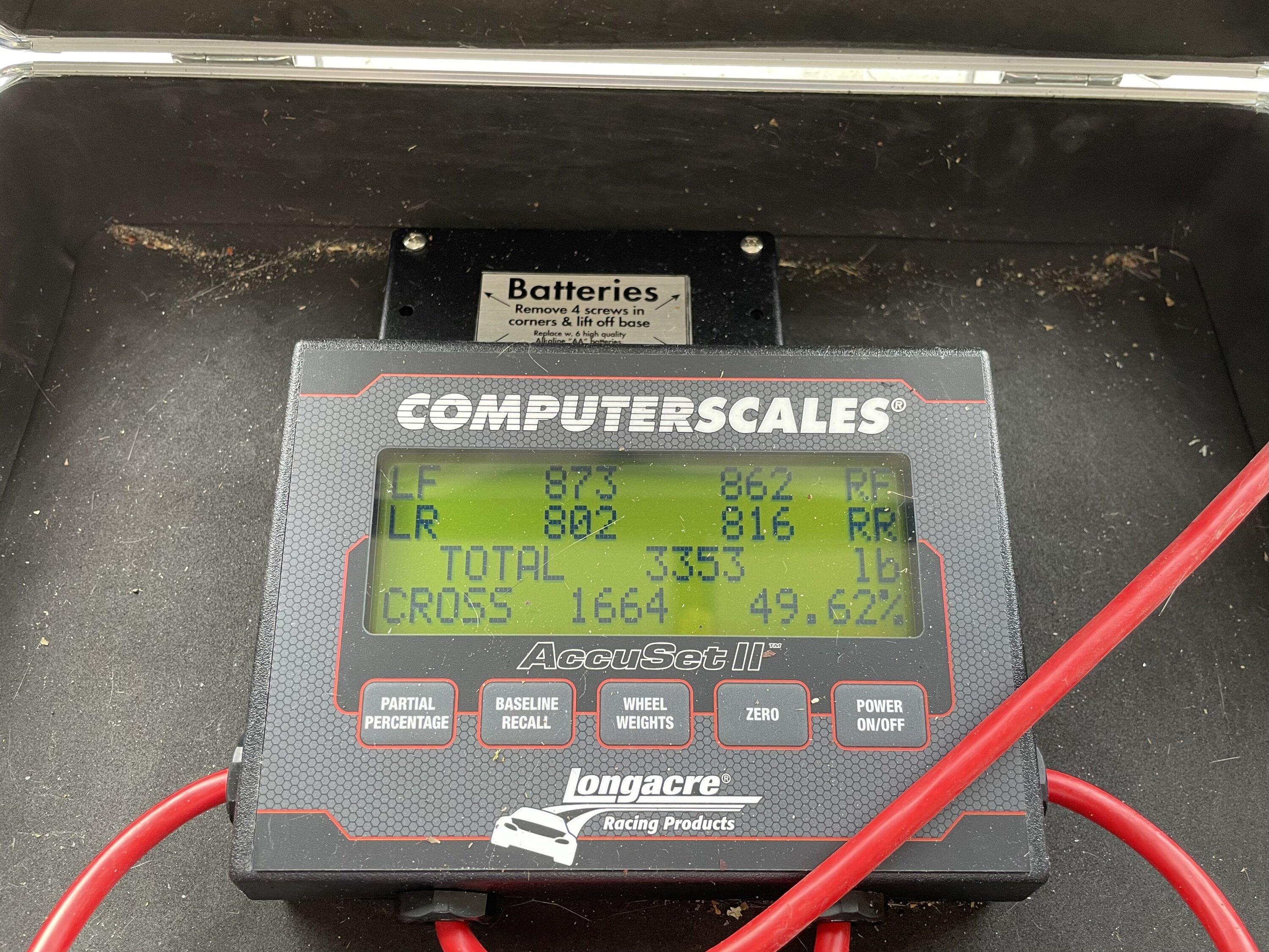

To add to the thread, are you are able to measure a GR supra and tell us the results?

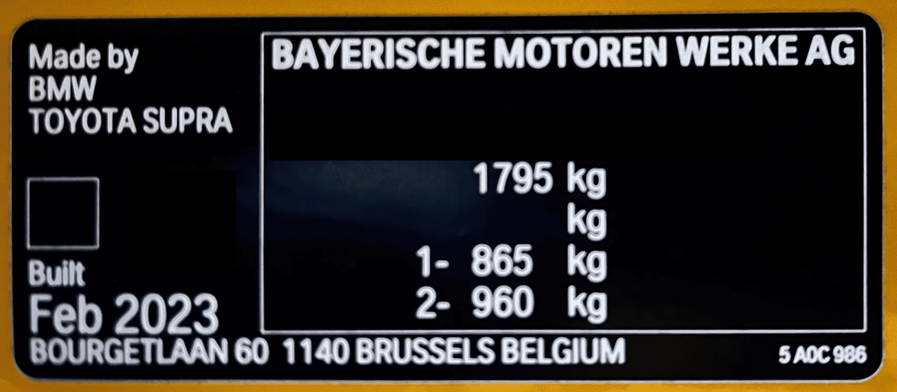

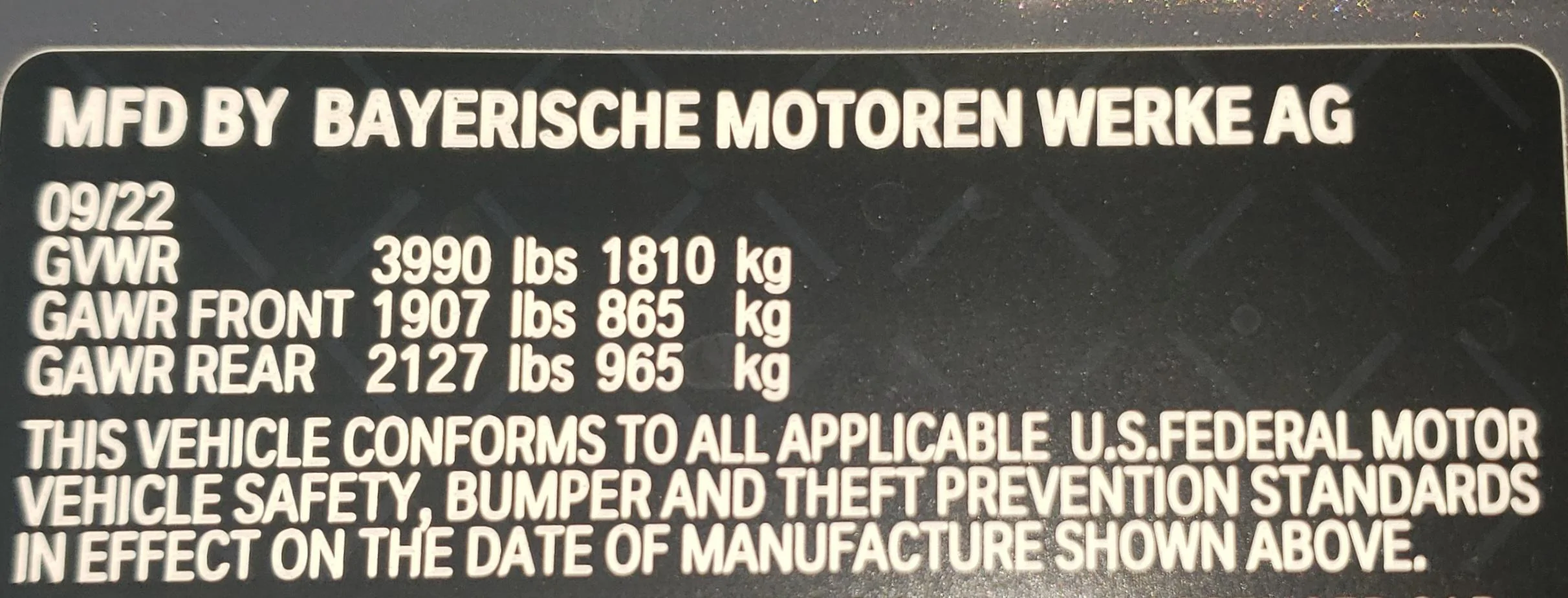

Sorry but I do not have this ability. I can take a photo of the compliance plate if you want? Besides, unless you are measuring cars that are completely stock, with identical fluid levels on calibrated equipment, I think you may be chasing a dream.

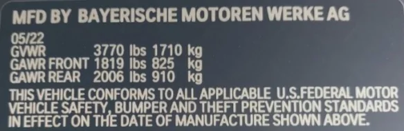

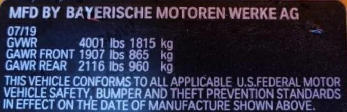

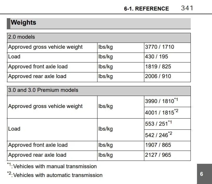

Ah I understand. I think I missed your comparison referring between AT and MT. I haven't weighed either yet. DrSupra and Sub-MKV referenced Similar comparisons here and found that maybe atleast a 20lb difference ? With the additional idea that maybe 2023 models increased weight... and the looming question where did the additional reported mass come from between those two models, specifically in the US.
I have access to a couple 3.O AT in my region. I'm trying to see if the owners are willing to measure (and hopefully are 100% OEM). At that point the best we can do is make sure fluids are at level. How close or different should their weight be, before we decide they weigh the same?? MY goal was just to document the weight for anyone else curious about the topic. If you want to share the compliance plate I can add it to the post?

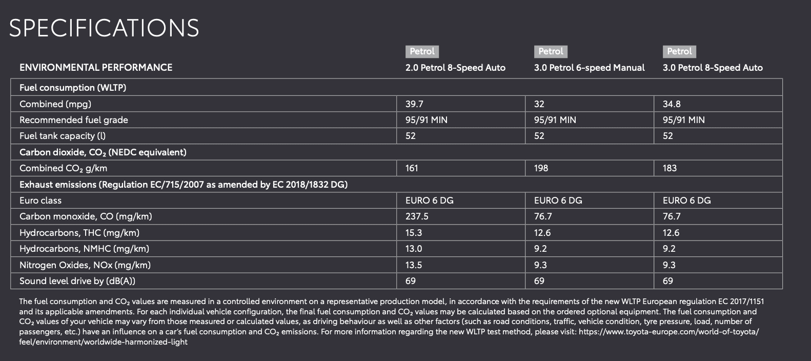

-My 2.0 in registry papers had 1441kg (being with sport pack so 3.0 brakes diff suspension), not mythical 1395kg. 1450kg with full tank in real world weight.
-My 3.0 has now 1505kg in registry (8AT with 12 speakers etc), will need to real world weight it, I expect ~1510kg.
-Typical USA weight I saw in tests along the years is 1520-1531kg, pretty common to be in 1520's.
In EU ~1505-1510kg.
