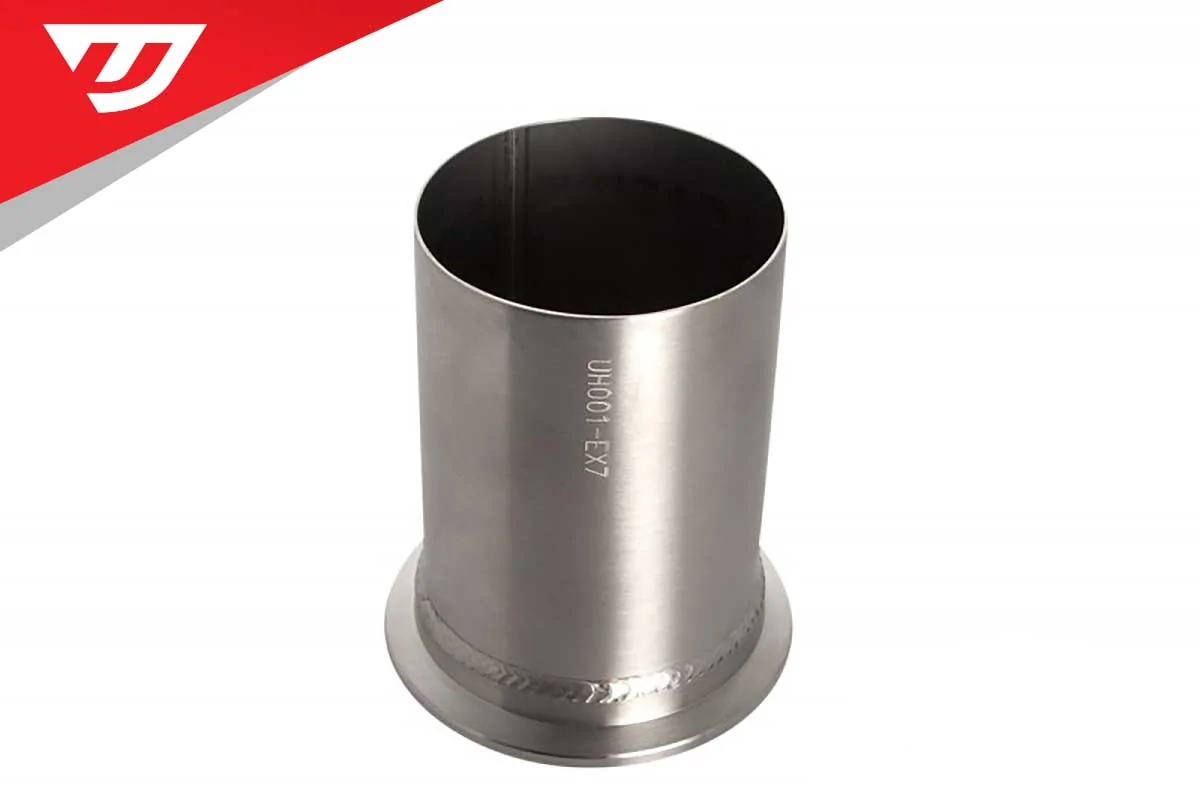

Yeah, it's pretty much the same. All the hooks and hangers and spaces line up. The only difference which is annoying. Is when connecting to the downpipe. The 2.0 has a vband type connector and the 3.0 has a slip on type. Even though they line up perfectly. You would need to cut the Vband from the 2.0 exhaust and weld it or make an adapter. Cost me about 100 bux to do at a shop when I had my exhaust installed.

b58 downpipe wont fit b48 but any 3.0 exhaust should fit the 2.0 as long as you have a slip on style downpipe instead of the stock flanged one.
