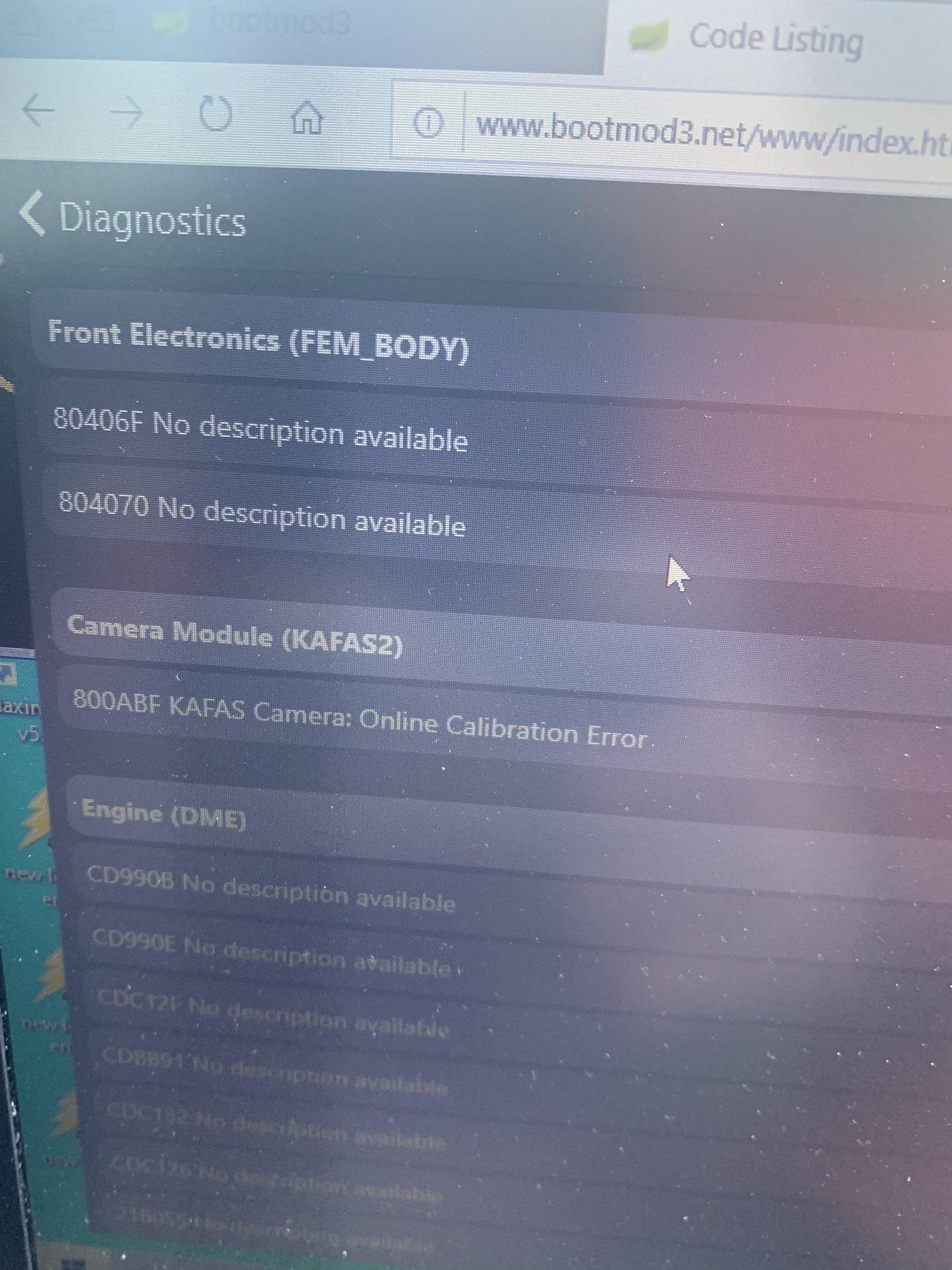

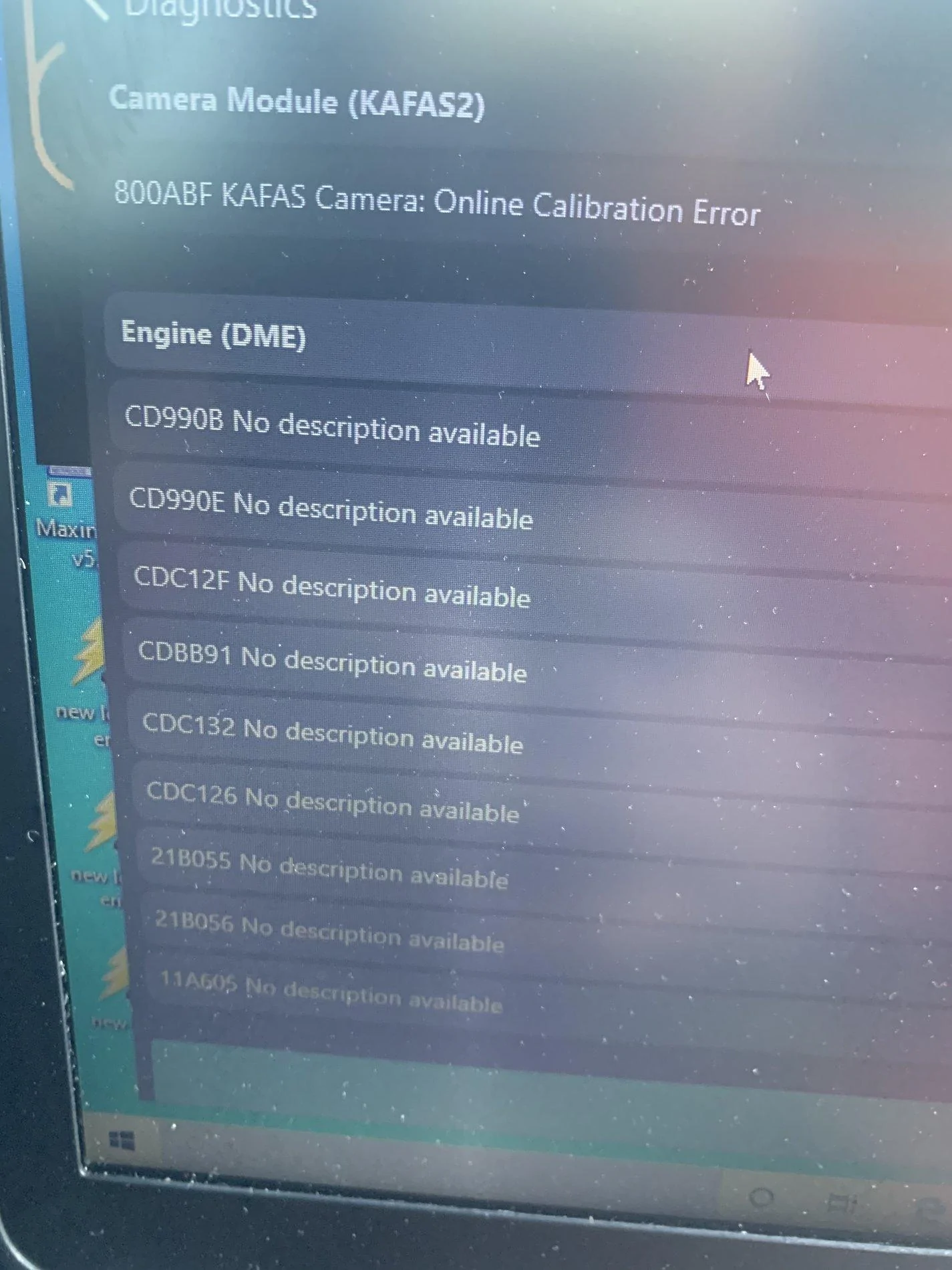

if you didnt clear codes yet. Read codes and see what codes are there and post the code numbers. there is always a code number for a limp mode.
Abdulisraddd
Abdulisraddd
Abdul
Feb 4, 2020
31
Northridge ca
2020 Toyota Supra
okay thanks brother , will post codes after work

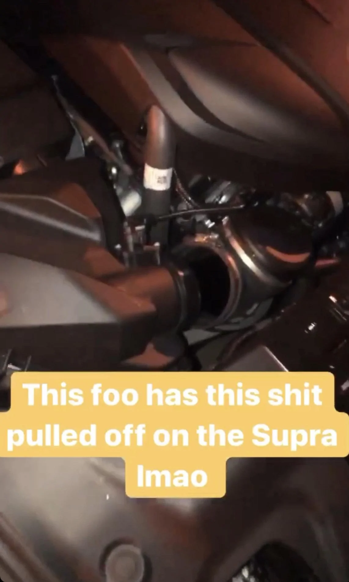

Okay so I was with some buddies and they asked to see the motor so I popped the hood for them and found this ... I think I found the culprit ...:doh:
Twisted Tuning
Justin
Mar 10, 2019
28
1,271
1,591
New York
www.twistedtuning.com
that wouldn't really cause much of an issue. looks like the typical 11A605 people have been getting

I feel like bypassing the air flow sensor Would totally cause issues

UPDATE: switched to e30 ots tune for some rolls in mexico . The car absolutely RIPs with e30. Everything went well for 5+ pulls and then on the last pull drivetrain malf. The car runs completely fine ....back to the drawing boards .
iceman21_23
Chris
Aug 31, 2019
65
78
Houston
2020 Absolute Zero Supra
did you pull the code? I've gotten 11a605 whichj is a fueling issue on e30 on hard pulls where the car downshifts to first
Abdulisraddd
Abdulisraddd
Abdul
Feb 4, 2020
31
Northridge ca
2020 Toyota Supra
I got that code on my ots stage 2 91 but when I got drive train malf on the e30 tune that code wasnā€™t there . I messaged bm3 support and they said
ā€œGo to My maps and flash the stock tune ( no need to lock DME)
Delete the map you had on
Go to OTS screen and get the same fresh map.
When flashing, press download now flash later.
Then flash the map.ā€
So far so good but we will see
