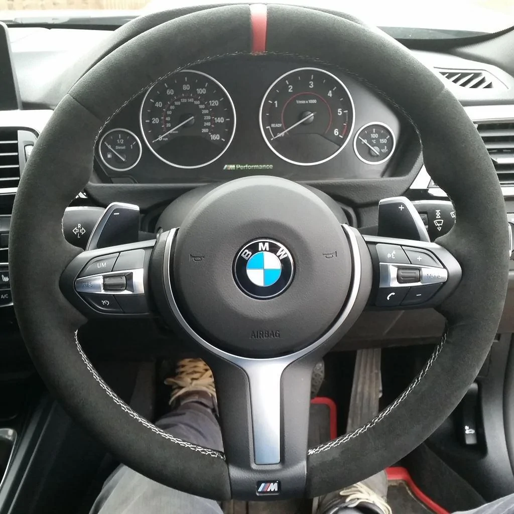

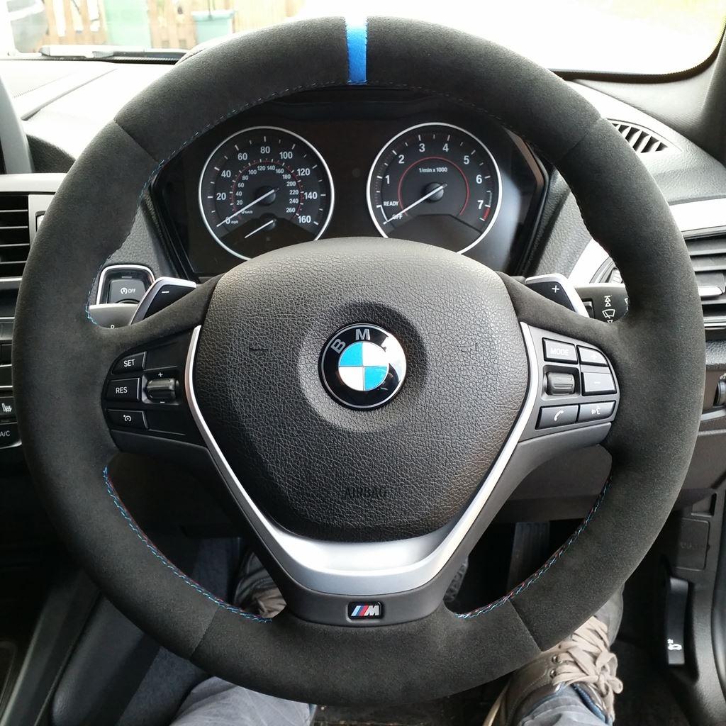

The Supra is based of the Fxx larger airbag steering wheel version. Per my research it looks like any of the F3x wheels will physically fit (whether it being the large or small airbag versions).
The airbag alone will cost you between $200-$500 second hand though. As for the larger airbag version, the wiring for the controls is the same (you just have to find the controls with the correct button configurations).
The only thing i'm not too certain about is the steering wheel with the smaller airbag (which is the one pictured in the instagram post above). Physically, I know it fits because the F3x is equipped with either the larger or smaller airbag. However, I am not certain of the controls, paddle shift, nor airbag connector from the steering wheel with smaller airbag. (does it require additional coding? do you need to re-arange the pins in the connector?, etc)

I agree, best just to get re-wrapped with thicker padding and not worry about the rest. But I think some people prefer the looks of the smaller airbag design from BMW which is why the seek that one instead.
If you look closely in that instagram picture however, the smaller airbag version does reveal the plastic bit from the steering column a tad more, which is why I think Toyota\BMW decided to go with the least sporty steering option instead (larger airbag design covers up the steering column plastic trim).
